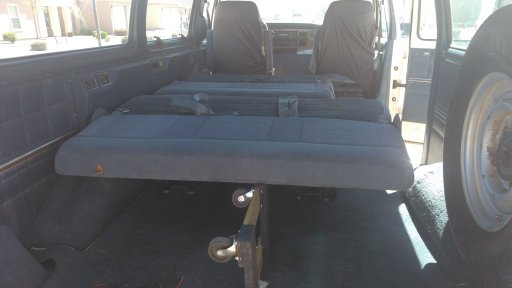

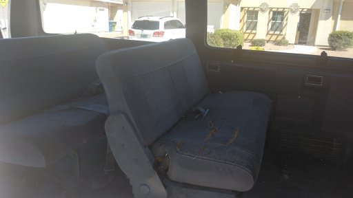

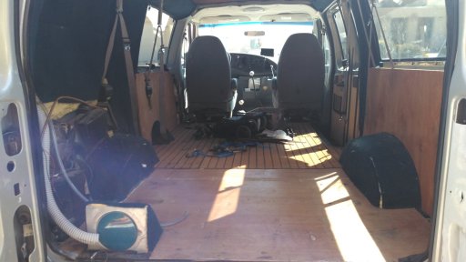

Got the Aerostar seats mocked up. They need to be reupholstered but I'm going to work on the brackets first since that should be an easy task.

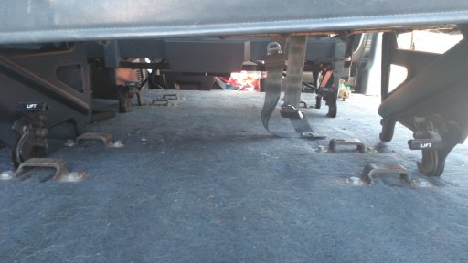

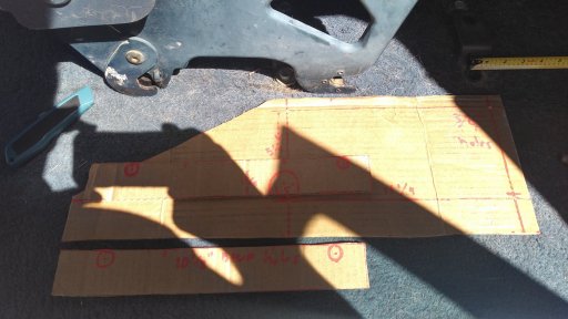

Where I need to make adapt seat brackets for these Aerostar benches lines up okay with the factory bolt locations, better that they did with the 2006 body anyway. The locking lugs will need to be just on the outside of each bolt set and 8 inches back (or forward for the rear).

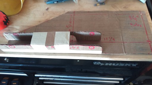

After doing a little Cardboard Aided Design I've settled on a basic layout I'm happy with and will start translating this into an actual CAD file to punch out of the plasma table. In any case I will be able to make 4 identical brackets that can bolt to any one spot. How they'll end up will allow plenty of leg room for the first bench and about 2 ft of storage in the rear even when in bed mode.

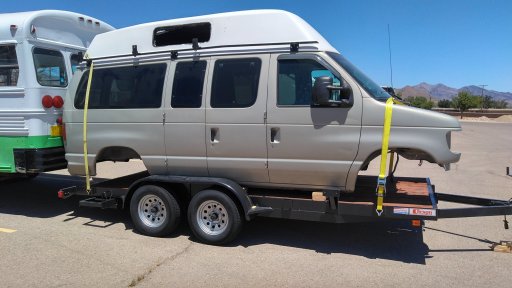

Made my choice, goin full bore into the body swap. I also have another interesting plan while the frame is out for me to work on, details to come
For now disassembly continues. Goin a little slow due to various reasons, to include the whole family gettin sick, but I'm hoping I can have her in the shop next weekend to pull off the body. So far the bumper swing outs and the rear gas tank are removed, among some smaller things:
She's lookin a little naked now... BUT I think the project will turn out great. If anyone is interested in an econoline high-top, feel free to give me a shout
  • Wow
Reactions: GLOCKer
The deed is done, no turning back now...

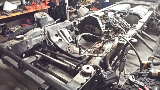

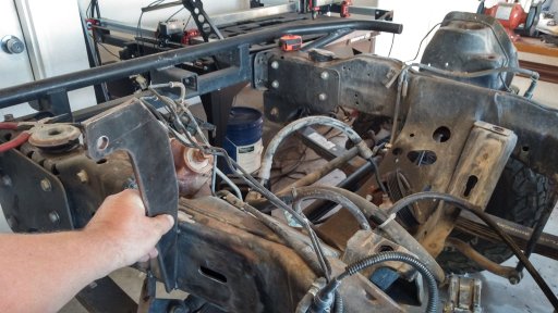

Going to have to organize my garage a bit to be able to work in there, but I should have enough room. I plan on putting all four wheels on dollies to help move the chassis around as needed. There are some areas on the chassis (rock rails, shock towers, etc) that now that I have better access to I want to wire brush clean and re-weld.

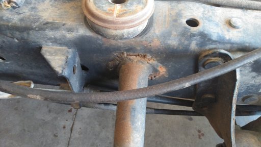

I'm thinkin I might remove the coil-buckets turned shock-towers and redo them. The UJOINT kit just has you weld in a bracket for a new shock location, I want to put in larger shocks up front necessitating the connection be 4" higher than it is. That and removing the track bar, which I view as useless in a leaf sprung application, should drastically increase my up-travel and hopefully keep or increase down-travel.
I may also try and figure out how to do sway-bar disconnects with the super-duty style axle (where the sway-bar is on the axle not on the frame) but that may be later on down the road.

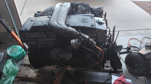

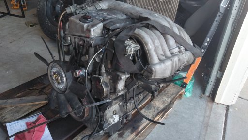

Well, it arrived...
I'd be way more excited but I paid the junkyard for a Turbo om606, they even sent pictures that are clearly different than the engine here, and instead I've got a n/a om606. I've got to decide now if I build and try to turbo an engine with weaker rods and springs or fight with the junkyard to get the proper engine. Supposedly this one was low mileage but now I'm doubting even that.
That said, revealed be my other interesting plan, merc diesel swap. I was planning a modded om603 mechanical pump, Holset HX30 turbo, and an om648 oil pan. Might not be able to build up to the same hp & torque of the v8 with a n/a engine but hopefully she'll still double my MPGs :)

Annoying engine update: apparently the "turbo" engine the parts yard was trying to source, he was sent images of one engine and then a NA engine showed up at his shop. It took a bit of self restraint not to reply "I can relate" to the owner over the phone...
Long story short, I'm getting a refund. But I got this news 4 days after I sold the perfectly low mileage v8 that was already in the chassis. I'm past the point of no return, so now I need to source an engine. I'm going to open up my options a bit to basically any straight six that's easy to adapt to my ZF-5 manual, we'll see what I can source

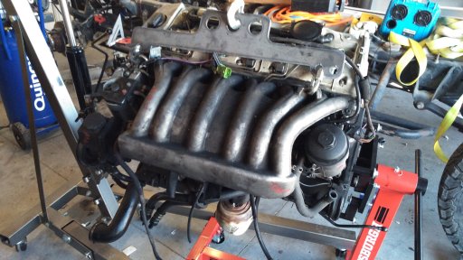

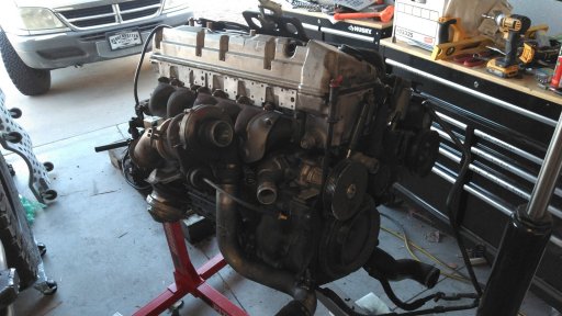

IT"S HERE!!!
Cost me an extra $1100 but finally it is the correct, actually TURBO, diesel engine! Working with Montoya's Auto Wrecking was an absolute nightmare but at least it's over.
They sent me video of the engine running before sending and the dash picture showed it had 140,000 miles on. Odd thing tho is this came out of an E300TD Wagon, which I didn't think the wagons were offered in the US with the om60X series of diesels.
In any case I have it up on the engine stand. One thing I'm really loving about these Merc diesel engines is that they have engine lift tabs like the bigger industrial diesels. My wife's Sprinter has the same on it's engine and it makes it very easy to set up a lift. I punched out a quick engine hoist bracket since I had the steel and got her plugged up and ready for a good power washing.
I have a rear sump already from a local-ish Mercedes engine parts supplier (seems he specializes in rebuilding the injectors, might need to pick some up) and the adapter for my ZF-5 manual comes in next week. Hopefully I'll have it bolted in the frame by next weekend!
I also have been working on the new shock towers. I had to redo the design a bit after the first iteration I made on the plasma table but I think I have a winning design now. It should provide me with a further 3" of up travel (after deleting the track bar) and 2" in down travel. I may have to bang out or cut the inner fender well but I think it'll be worth it.
The only other thing I want to figure out is how to make or redesign the Ford sway bar for quick disconnects. You can kindof see in the pic above that the sway bar is located on the axle itself and the links go up to the frame. If I did add disconnects as is then the links and bar would be sitting on the travelling axle and I'd have to figure out some way to keep it tucked up and out of the way.
