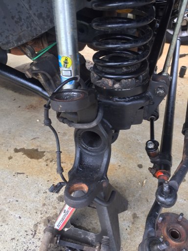

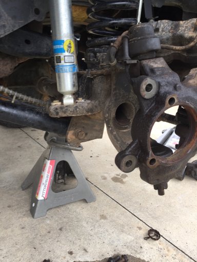

Okay so even after replacing the bushings I still get deathwobble. It isn't as frequent but I have still gotten it. Going back under to check everything. All components are tight though
Still working on getting this deathwobble problem resolved. Yesterday I replaced the tie rod ends on the drag link and was going to replace the one on the passenger side tie rod as it had a little play in it but I can't get it out to save my life. I screwed it in to where it was and am getting it realigned tomorrow morning. Well this didn't solve my issue. It still came back. Today I had someone help me weld in a washer to fix the axle side trackbar bolt hole. This still didn't fix it. I'm going to get it aligned again tomorrow after all this work and I hope this will help it.
Today I took it back to the shop to get an alignment and balance the tires. He found one had a broken belt. He put that one in the rear and it feels so much better but I still get the death wobble.
Today I had planned to do both cv axle shafts and put the new tie rod end. Pretty simple right? Turns out just about everything was seized. This made the passenger side replacement take like 2 hours then it started to rain.
A friend of mine has been helping me work on my jeep and diagnose this deathwobble. Just about everything has been replaced besides the ball joints.

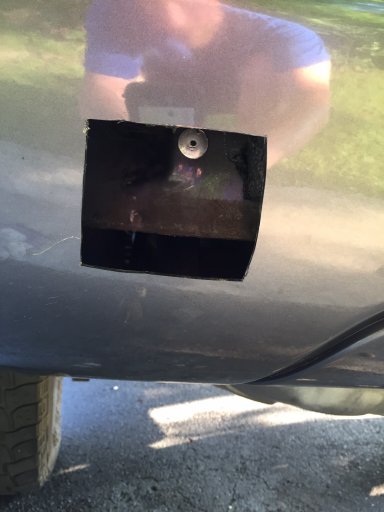

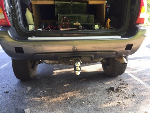

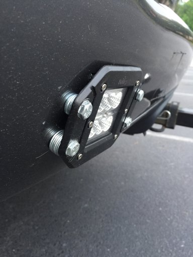

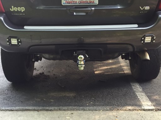

Finally started working on the rear camping lights in the stock bumper. Thought I have everything perfect but the first hole I cut had the crossmember about 2" behind it. I needed 3" to flush mount the lights so I put the square cutout back in and semi melted it back in place.
I discovered as long as I'm outside of where the hitch mounts to the frame everything clears. Here's a few pictures.
I went with 1/4" hardware, the rear lights I used one 2" lag screw for the corner that lines up with the foam, and for the other bolts I drilled a 3/16" pilot hole in the plastic then ran the machine screw through it and put a stop nut on the backside. I had the cut a little of the underside of the bumper so I could get my arm and a wrench up in there. I also used washers to space it so it's focused rearward instead of out to the side

Today turned into a very busy day. Battery was low again so I brought the alternator back to be tested. This time it failed so I got a new one under warranty. I also changed out the battery terminals and the corroded negative cables with the help of a friend. He also wanted to take a look at my toe setting and turns out it was off big time. We thought it was the shop setting it to stock spec. After playing with it a bit, wait for it, NO MORE DEATHWOBBLE!!!! I'm so happy haha. I also took a trip to Wilmington to pick up 5 BFG mud terrains. Can't wait to get them mounted up.

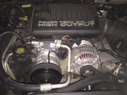

Finally bit the bullet and got a new AC compressor, evaporator, dryer, accumulator and orifice tube. I ordered the compressor kit off of rock auto and got it installed by a local shop.
Side note, living in NC is hot and humid about 8 months out of the year. It's nice to have the air back after a year of keeping the windows down
Yes that is a new alternator as well. Lots of parts replaced recently. Next up is to dial in my alignment again. The insides of both my front tires are getting worn much faster than the rest of the tire.

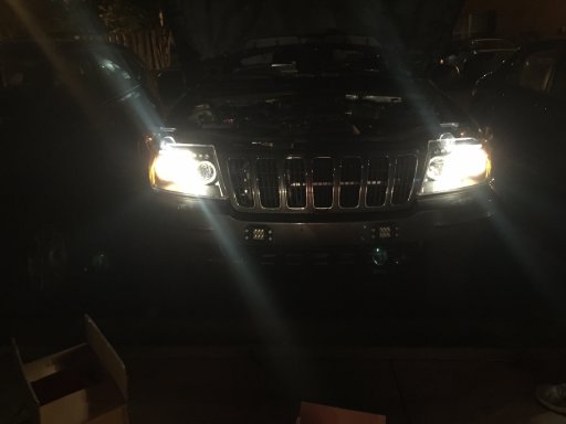

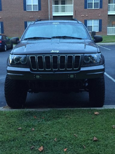

Today I bought new headlight assemblies from a fellow member, @EisBlade on JeepForum and was able to pick them up and get them installed in the dark. Light output is much better and it makes the Jeep look newer.

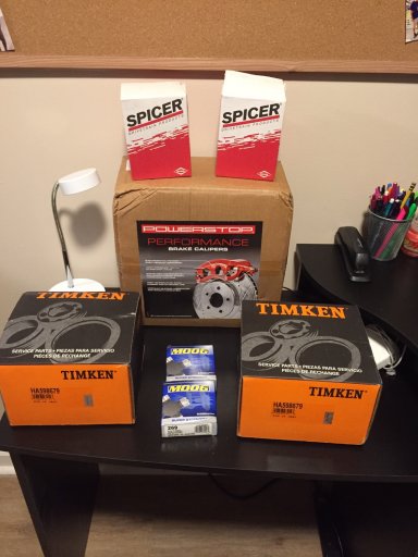

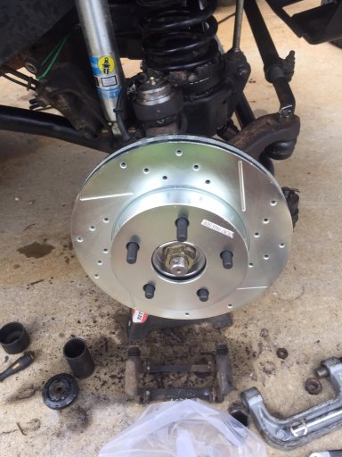

Rotors, pads, wheel hubs, u joints, and ball joints all ordered from Rockauto. Can't wait to get it all in this weekend. Going to look at getting the longarms installed in the rear and correct the pinion angle

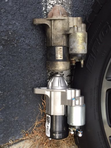

Lately I've been having trouble getting it to start even after a new starter. Finally found out why though. The two power wires going to the battery terminal are slipping out of the clamp style terminal. I replaced it with a lead free terminal with a wingnut and crimped a terminal connector on the power wires and all is good now.
Not today but yesterday replaced shot balljoints with spicers, timken wheel hubs, powerstop drilled and slotted rotors and carquest brake pads. Also cleaned up some of the rusty bolts. Did a redneck alignment and tires are now straight. Sometime this week I'm going to get my replacement tires in the front because the shot balljoints killed the inside of the tires.
