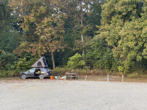

Hiya from San Francisco Dogpatch/Potrero Hill. 2020 Subaru outback touring.
2020: added roofnest falcon tent, eezi-awn awning, fabricated diy "pull kitchen" drawer system (see papadaves post here)
2021 summer: dealer-installed LP Aventure 2" lift, skid plates, BFGoodrich tires, nashfabco ladder
