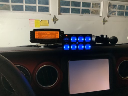

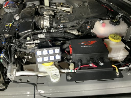

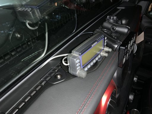

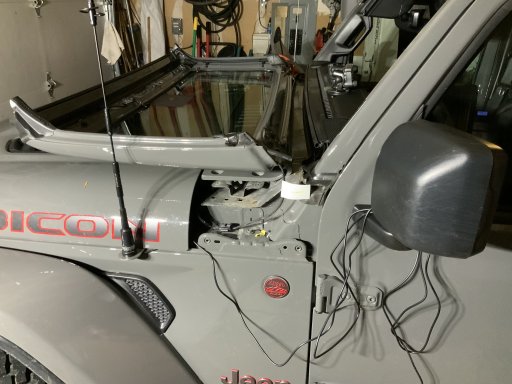

Continuing to "build" the new JT. Realized that I need aux switches to enable some of the electrical scenarios that I envision and during a conversation with a buddy we discovered the Voswitch system. I bought and installed it last night/this morning. It has 8 ports/switches/relays and is 1/2 to 1/3 the price of the "name brand" competitors and every review that I found gave it 4-5 stars. I am impressed with build quality and the extra (imitation?) Ram mount goodies that they provide. No regrets and very happy with it so far! Got to drop the windshield to run the control wire to the faceplate and took the time to hide the ham radio faceplate wire as well (and clean the dash).
Since I saved so much on the Voswitch I ordered a set of VisionX reverse lights to wire up. :)
Extra RAM mount goodies (imitation me thinks). Did not need the JL/JT dash tray with RAM balls so if you want it let me know. Also included an extra arm and phone holder. Nice!
Control box installed and wired up (pre zip tying). Windshield dropped and wires dangling.
Finished install with first device (ham radio) moved over to it.

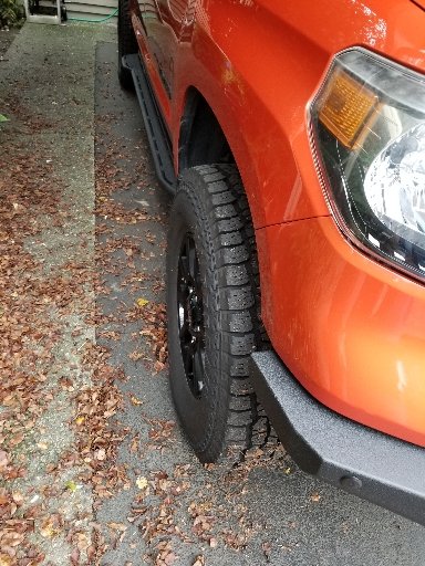

Had some body mount rubbing near full lock steering, from the weight of the bumper and winch install. Remedied; Coachbuilder 1" strut shims and SpiderTrax 1.25" wheel spacers installed. Drives straight, smooth , zero steering issues, and better stance.

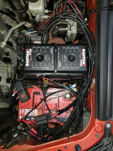

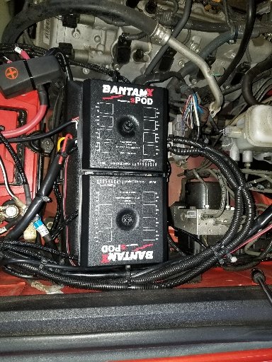

Also, upgraded my original sPod Bantam to the BantamX and added a 2nd source BantamX. Perfect fit on the fuse box cover.

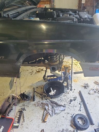

Installed new CV swivel joint seals. What a mess lol.
How many miles on your rig. Just wondering, looks like a big job to me.
170k. Its actually pretty simple with the proper tools. The 52mm socket is the hardest to find for the spindle nuts. Luckily I bought one months ago when I changed the rear rotors. Just make sure you have lots of rags or towels cause its messy lol.

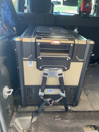

I installed an arb fridge freezer a month or two ago and it’s been awesome to have cold stuff all the time even when just going to the store or a family day. I made my own platform out of 1/2 inch plywood and it’s been amazing. I believe I got it cut 44 inches by 27 inches. I used 2 inch m6 bolts. I removed the bolts holding the tie downs in the back and used the m6 bolts in place of it. I included cutting a hatch I. The plywood to have access to the storage location in the trunk under the platform. This way I can access my jumper cables and bottle jack. I ran the arb wiring kit on the driver side under the plastic coverings to the battery. I also ran in the same fashion a usb charger that I wired to my spod so i can turn it on when I need. This was an easy and gratifying install. I used a hand saw and a impact driver. I just wanted to see what I could do with hand tools and it worked out well. I am going to be installing a slider for the fridge as I hate climbing in the jeep trunk to get my sons juice lol I’m including pictures and hopefully it helps anyone who wants to build their own platform. I spent about 100 or less dollars on everything for the platform including the saw and hardware.
