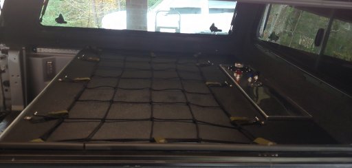

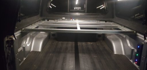

Rear 2/3 deck in the Gladiator under ARE shell. 1515L T slot extrusion, 12mm Baltic Birch, swiveling lashing points. Increases bed capacity by about 80%. Still have to finish my charcoal canister for the fuel tank, but it's about 95%

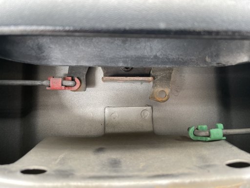

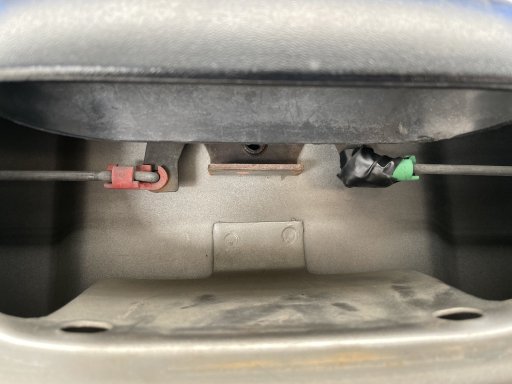

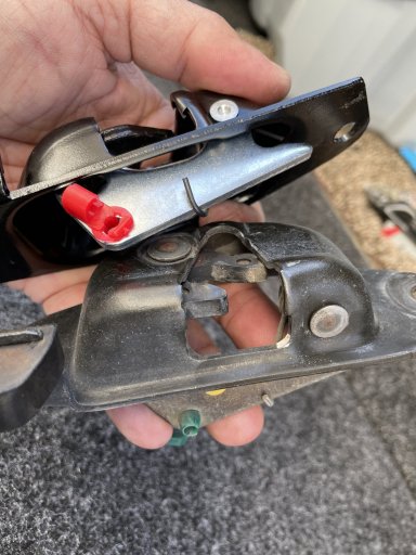

Well, I found out why my tailgate all of a sudden wouldn’t open. Broken plastic clip that holds tailgate rod. Taped it for a temp fix until I can obtain parts.
Note - the tailgate pop luck has a one way security screw. Had to bust out dremmel and make a cut deep enough to get my flat head in there to unscrew it.
Fixed it with new parts (bezel and lock). Then of course when I was completely done I noticed a spring was missing on the driver’s side latch lol. At least tailgate lock is fixed.
those plastic clips are a pain in the butt. had "custody" of a 2001 3500 dually a few years back (belonged to the Chuck my Burb is named for) and those things broke 5 or 6 times over the course of a couple years.
Reactions: RoarinRow
This is the first time I had tailgate latch issues since I took ownership in 2013 or so. I knew that it was kinda sticky at times but with COVID and WFH and always tinkering in the back tailgate, its days were numbered. Today, I also replaced the left and right latches so I basically have new hardware on all the main components of the tailgate. At least now I know how to replace all the latches.
