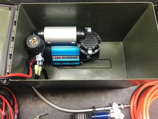

I put together an on board air set up. I used a fat .50 ammo can that I cleaned the stencil off with acetone, and ARB compressor, compressor kit, 10 gauge wire, alligator clips, and Anderson power pole connectors.
I don't have room under my hood and I don't want to mount it in the cab or bed. This set up allows me to connect to any 12 volt battery with the 12' extension cable I made. I can easily change ends with the Anderson power pole connectors at each end. I didn't need to use any of the ARB wiring harness. I bolted the compressor to the bottom of the can using two carriage bolts in the recessed area of the bottom of the can so it's not wobbly. The pressure switch cuts off the compressor at 120 psi so it's not constantly running. Simple and effective.IMG_9814.jpg IMG_9819.jpg IMG_9817.jpg IMG_9818.jpg
