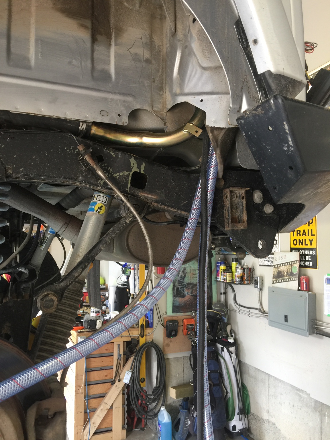

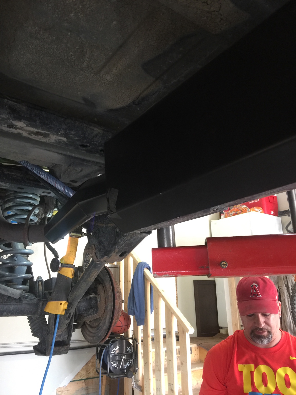

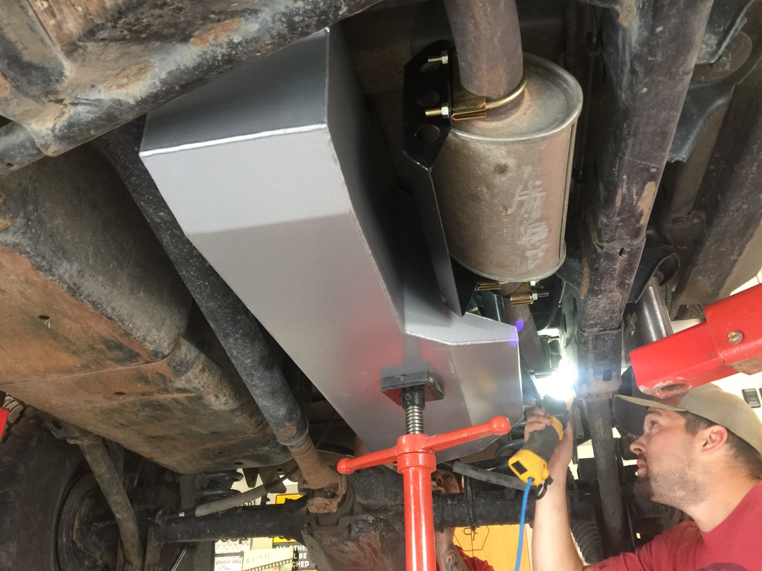

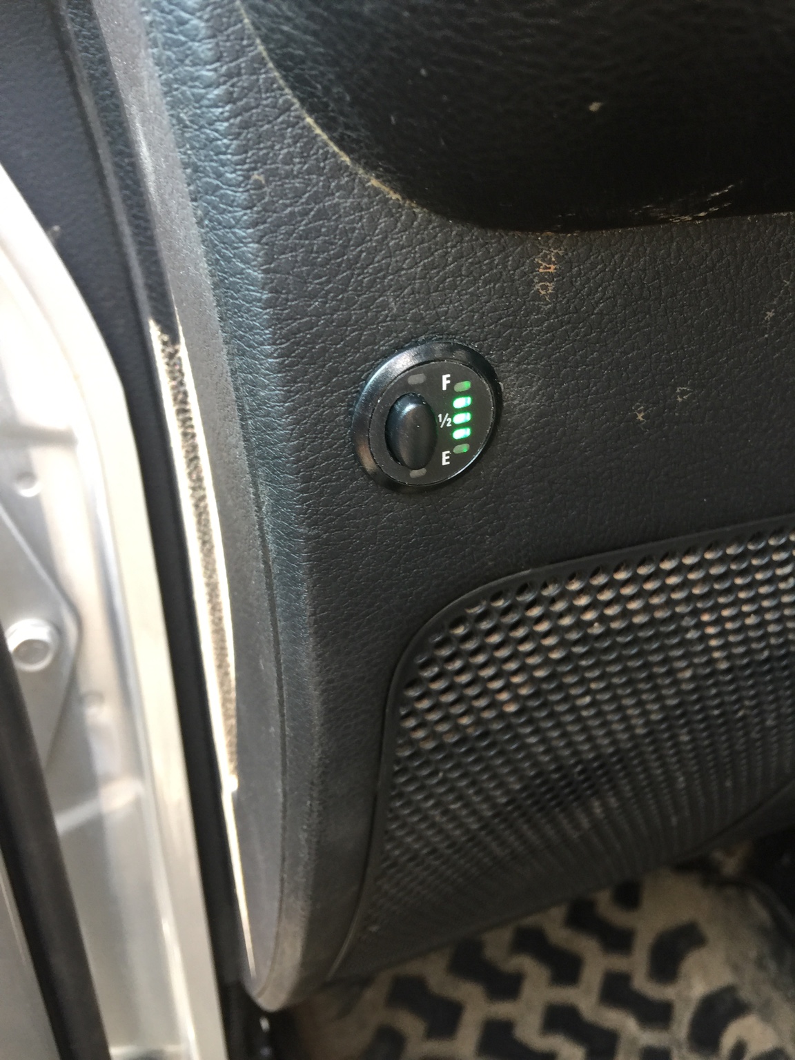

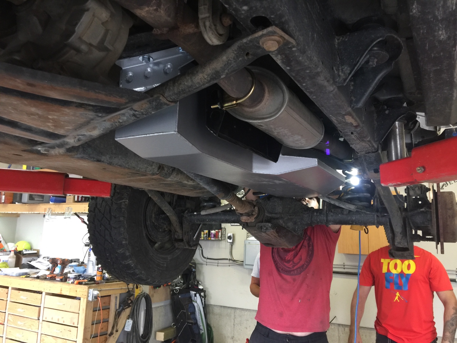

Installed a 60/L long range fuel tank that I picked up in Australia a few weeks ago from Uneek 4x4
After removing the Evap canister and relocating it above the rear axle with the included mount we pulled out the stock filler hose right to the gas tank and replaced it with a new filler and dual tank pipe
We did our test fit and marking out the holes to drilled out
The kit comes with everything including to heat shields for the resonator and exhaust pipe.

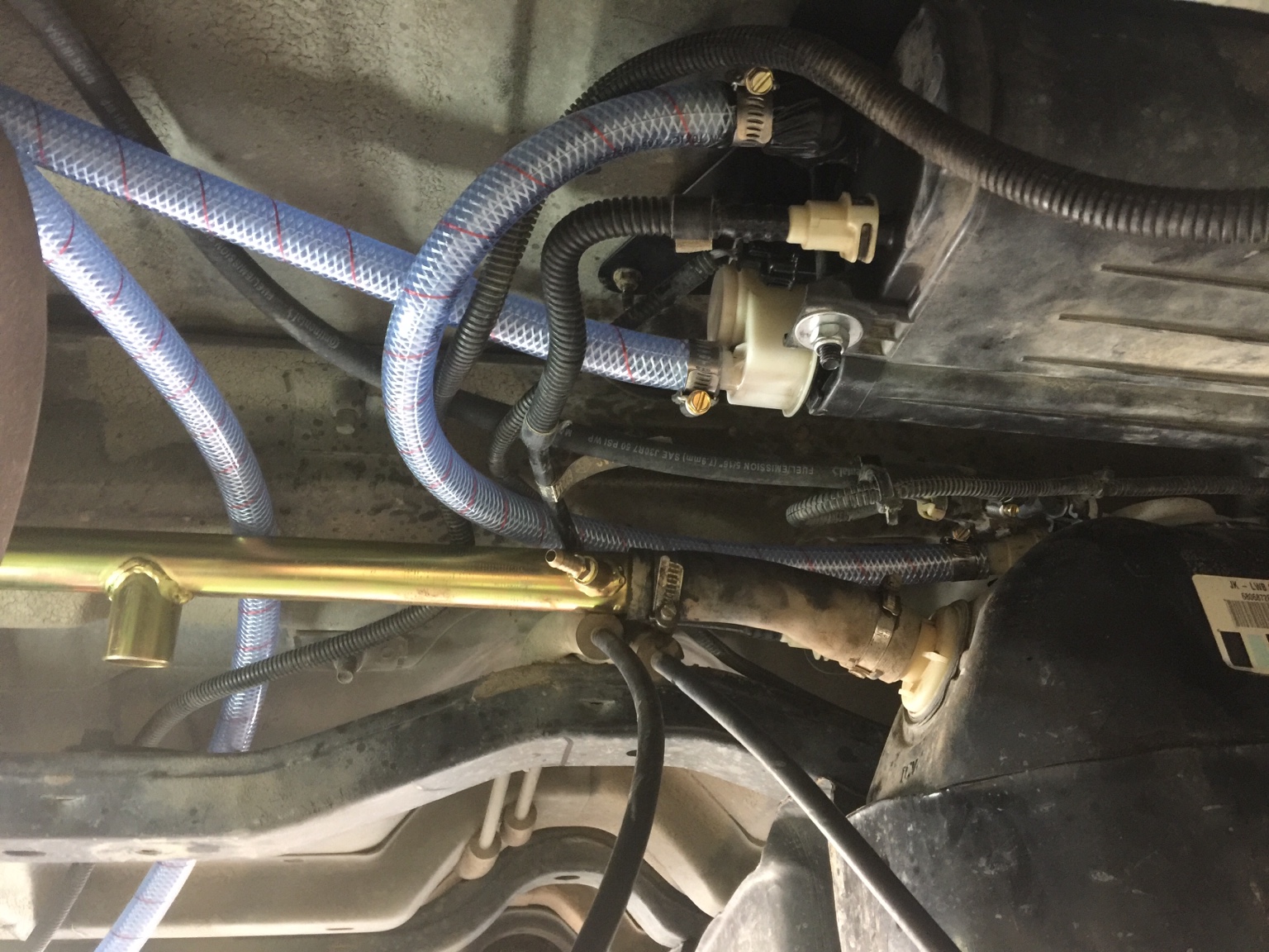

Installed and replumbed all the hoses and gas lines into the Evap to stock tank and installed the auxiliary fuel pump and ran the electrics up to the front dash. Ignition power coming from the auxiliary power of light in the dash
The pump transfers fuel at 2L per minute
Install time 5 hours
The new tank sits roughly 3/4 of an inch lower than the stock fuel tank in the jeep JK that's not to bad !

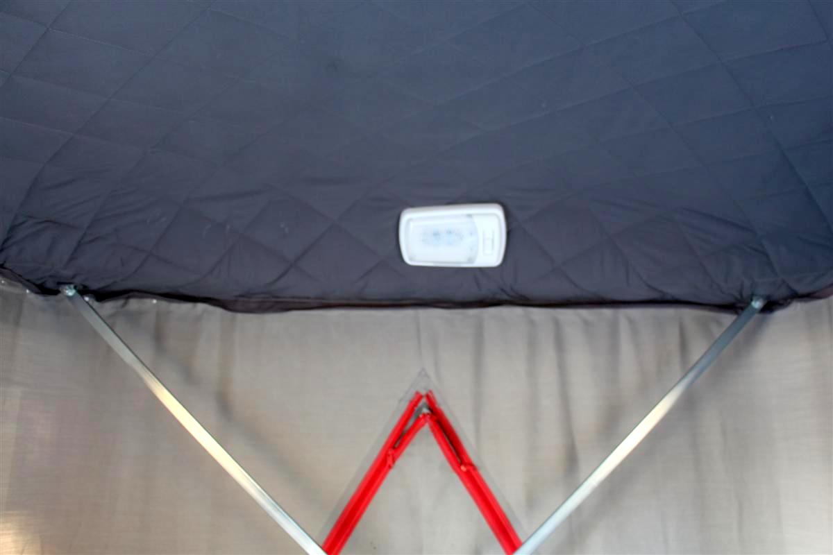

Worked On The Tent Today
Not really the rig, but what resides on the top of it.
On our vacation yesterweek to Mount Rainier National Park I chanted out the stock light bulb in the tents 12v housing for an LED one.
I attempted to power it up by sliding the switch without putting the plastic cover on the light housing, and the switch broke.
Not sure if it was because the cover was not on, or it was just time for it to break.
I had a battery WaganTech Dome Lantern with magnets on the backside that came to the rescue since I could attach it to the tents scissors lift arms.
I got a battery LED light from Autohome that I think is the same one they now use in their tents, but there was really no way to attach it to the fabric on the roof, and I did not want to cut the fabric away.

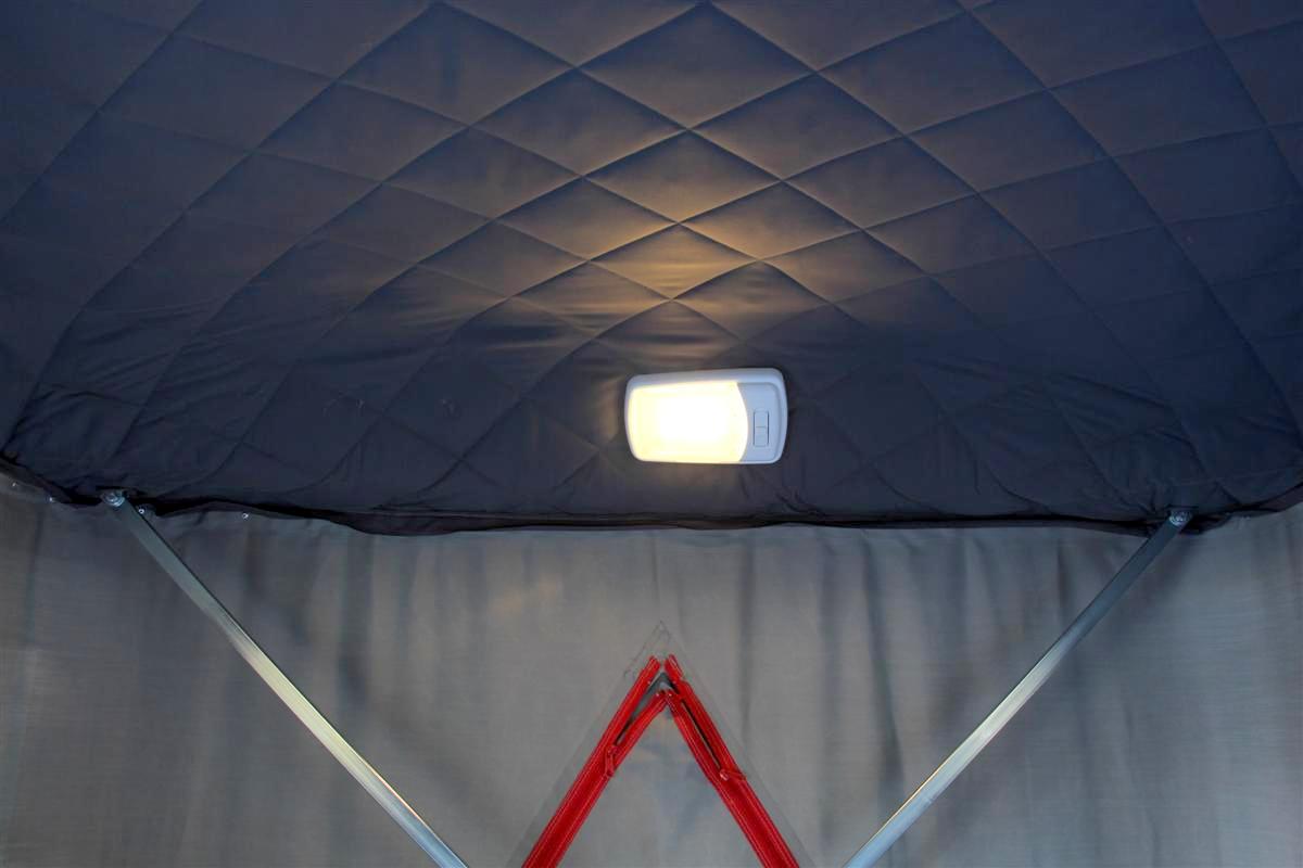

I had bought an LED RV light housing back in May from Amazon, and I installed it today.
Very bright, much brighter than the stock Autohome, and the battery one I just got.
Also added a little extra cushioning to the 3.5" mattress in the tent by adding a quilted full fitted mattress pad.
The mattress was pretty comfortable by itself, but is even nicer now by stretching out on it today.

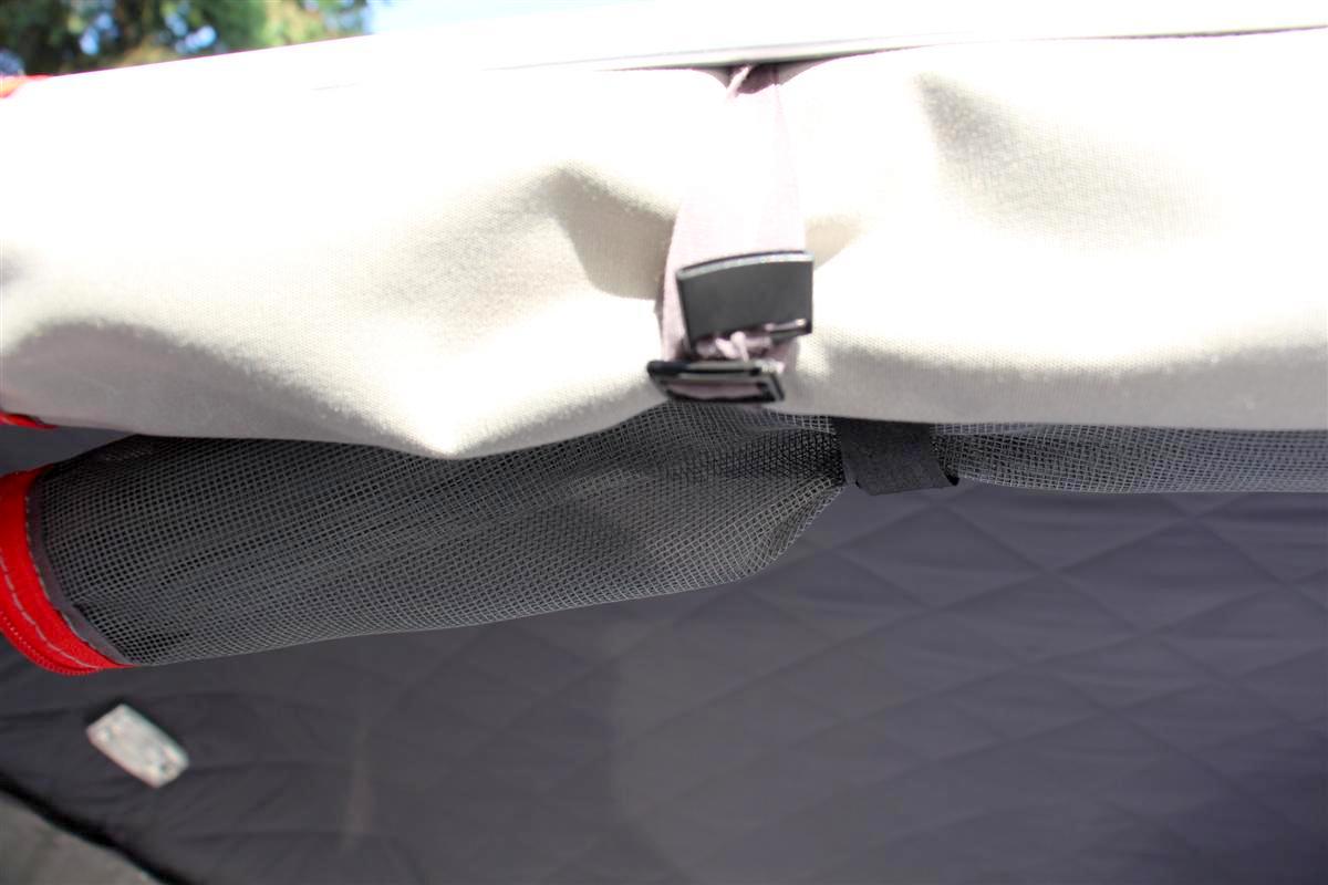

I also broke one of the plastic clips that keeps the canvas door rolled up on the trip.
The mosquito netting door uses Velcro strips, a lot better, not sure why they went with the flimsy clips for the main door.
Thought I was going to have to add some Velcro, but after looking at it I just tucked the broken end through the fabric loop that the other clip end goes onto, and it keeps the door up just fine.
I may find a more permanent solution later, maybe I can even find that type of clip some where.
Mike from Autohome US is going to see if he can get some in on the next shipment of tents to the USA from Italy.

The broken clip is on the bottom, and it just sticks through the loop of the material that holds the female portion of the clip
New light, you can see it is much bigger than the light you can see in the first picture with the door clips
Let there be light, LED light

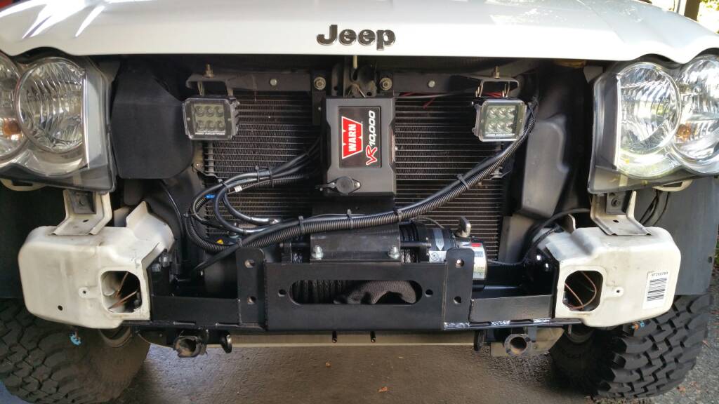

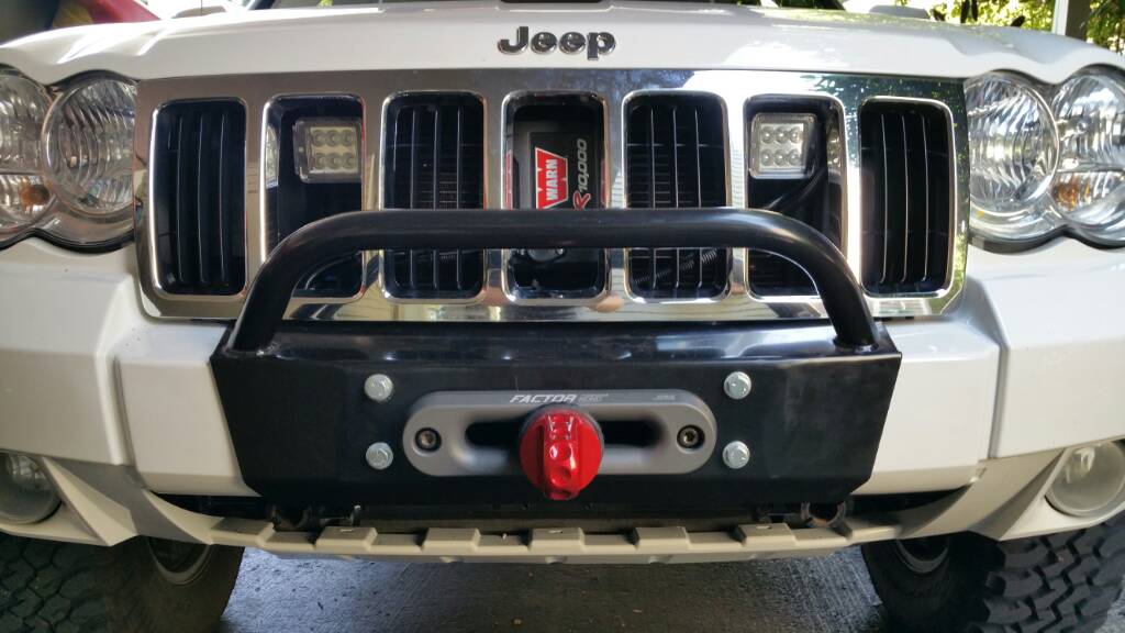

Winched-up the WK today, with the RRO Hidden Winch Mount and Push Bar, Warn VR10000 winch, Warn Spydura Synthetic Rope, and some Factor 55 goodness. Was able to retain my Blue OX tow mount as well; took some extra work, but it worked out well. Very happy.

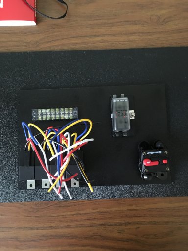

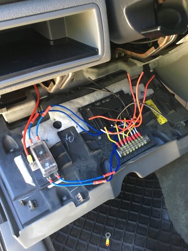

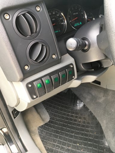

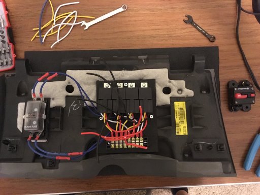

Wired up relay/fuse block. Spent a week getting this all put together. 4 LED lights with the two rear lights running on one relay. Two side lights on another. Still have two spots left for future accessories. Still need to shrink wrap some ends and tie up the wiring. IMG_0865.jpgIMG_0868.jpgIMG_0889.jpgIMG_0913.jpgIMG_0915.jpg
