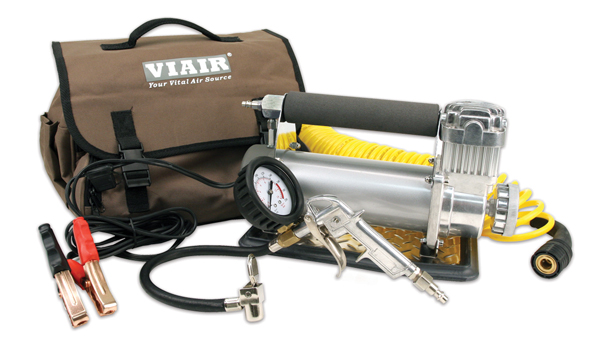

The inflator gun thing with the pressure gauge on my Viar 450p compressor has a little button that deflates. Its maybe not as quick as those screw on deals, but you can use it without the air hose connected, so that is what I have used before. I like the gauge.
I have this same compressor, love it...Haven't used it to deflate yet.
