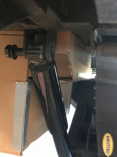

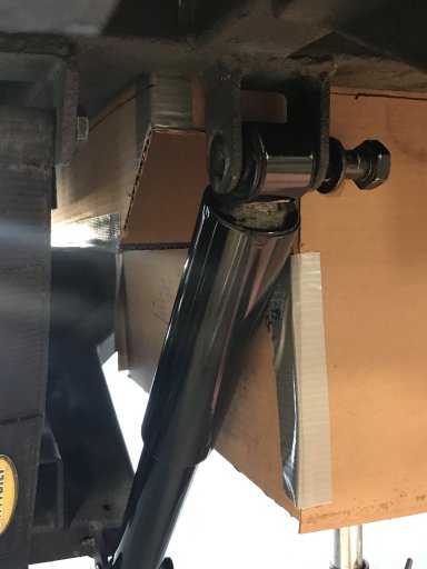

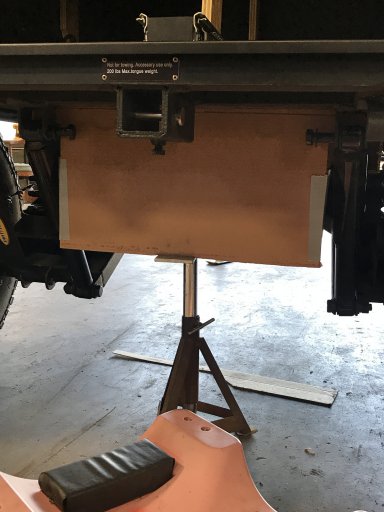

I found a place here in Costa Mesa that is willing to fabricate a water tank for me that will fit underneath the trailer in the back supposed to go there tomorrow for them to take measurements will keep everyone posted on the size of the of the tank and how many gallons it will hold I told him if it works out there will be other people contacting them for tank also

Dang, now I'm in a quandary on my water tank. I had the tank, so coated it with bed liner so it blended in with the trailer and made metal straps. Don't want to drill holes unless I have to. Maybe I'll measure the tongue weight tonight...

I couldn't find my tongue scale, so decided to just grab the tongue and lift. GEEZ, it's heavy. So, my tank will not go in the spare tire spot. In fact, I will just be putting a propane tank, table and chairs in that spot.
I also crawled under the rear of the trailer, and with all the suspension parts, there's not much room under the trailer. Since I'm trying to get the trailer ready to go to Goose Creek Jeep Trail in Montana in 2 weeks, I need a quick, cheap solution. So, I bought a 13 gallon water tank off ebay for $41. it measures 21x9x16, so it will fit well on the left tray in the main cargo area. It leaves room in the back for a storage container, as well as one on top of the tank for another container, so doesn't consume much room. I will use a check valve on the top vent to let air in but not let water out, and use a ball valve on the edge to access water. This will do the trick for now while I wait on the results of the tank under the rear of the trailer
