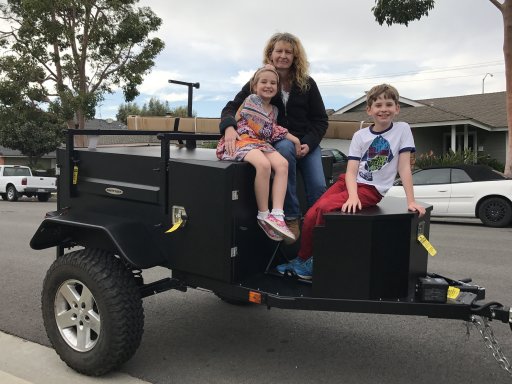

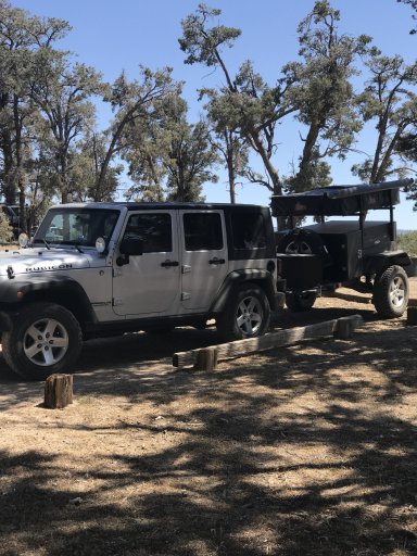

Ahh.. I was thinking trailer springs.
Oh god No its rated for 17oo pounds
It did Great going up the backside of Big Bear from Hesperia to a campground named Horse Springs had the Tepui Autana XL Ruggedized
SKY mounted and about 12 gallons of water and ice chest full of food my Snowpeak IGT 4 with BBQ and 2 burner stove etc. and it pulled fine
No air down of tires as no onboard air to re inflate so found out I have some pretty tuff kids and dog and a Wife that will put up with a Lot (Beat the Hell out of Them then went to Big Bear Lake to find camping)
Now the jeep didn't like the heavy tongue weight and it kept hitting the rubber stops now this was with the short Max Coupler
