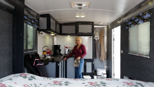

my tongue weight on the enclosed trailer is just over 350 pounds. I built this as a toy hauler in 2014 to be able to haul our dual sport motorcycle and camp. Unfortunately, my wife is not able to spend as much time on the motorcycle as in our younger days, so selling the enclosed trailer and switching to the off road trailer. Much easier to travel in a jeep in the scrub than on a bike. Here is picture of the inside of the trailer that I built. I move the battery and propane tank inside the trailer at the back when towing to reduce weight, and the bike is positioned to help reduce tongue weight. The bed in this picture folds into the wall to the motorcycle slides in place easily.

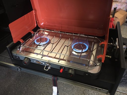

4. The drawer for the stove...fail. Finding a stove to fit that spot is going to be difficult. I knew it was short, but when you add the length of the back of the T handle bracket, you lose almost 3 inches. I've done a bunch of research, and have not yet found a stove short enough to work unless we use a one burner stove. We setup a 2x4 table at a right angle to the stove drawer as a test (we have an awning on that side of the trailer), and we can run the stove on the table and use the drawer to hold a tub with cooking utensils, so we have a solution. However, if they are going to make a drawer that doesn't fit any stove on the market, they should provide a stove option.

The stove slide, totally agree.. wayyy too small.. but the Eureka one will fit. If I find its a POS I will contact Partner Steel and have a "custom" 18" version made with a front exit propane line. Not a deal breaker, but yeah, that area is WAY too small. Time will tell on this stove.
