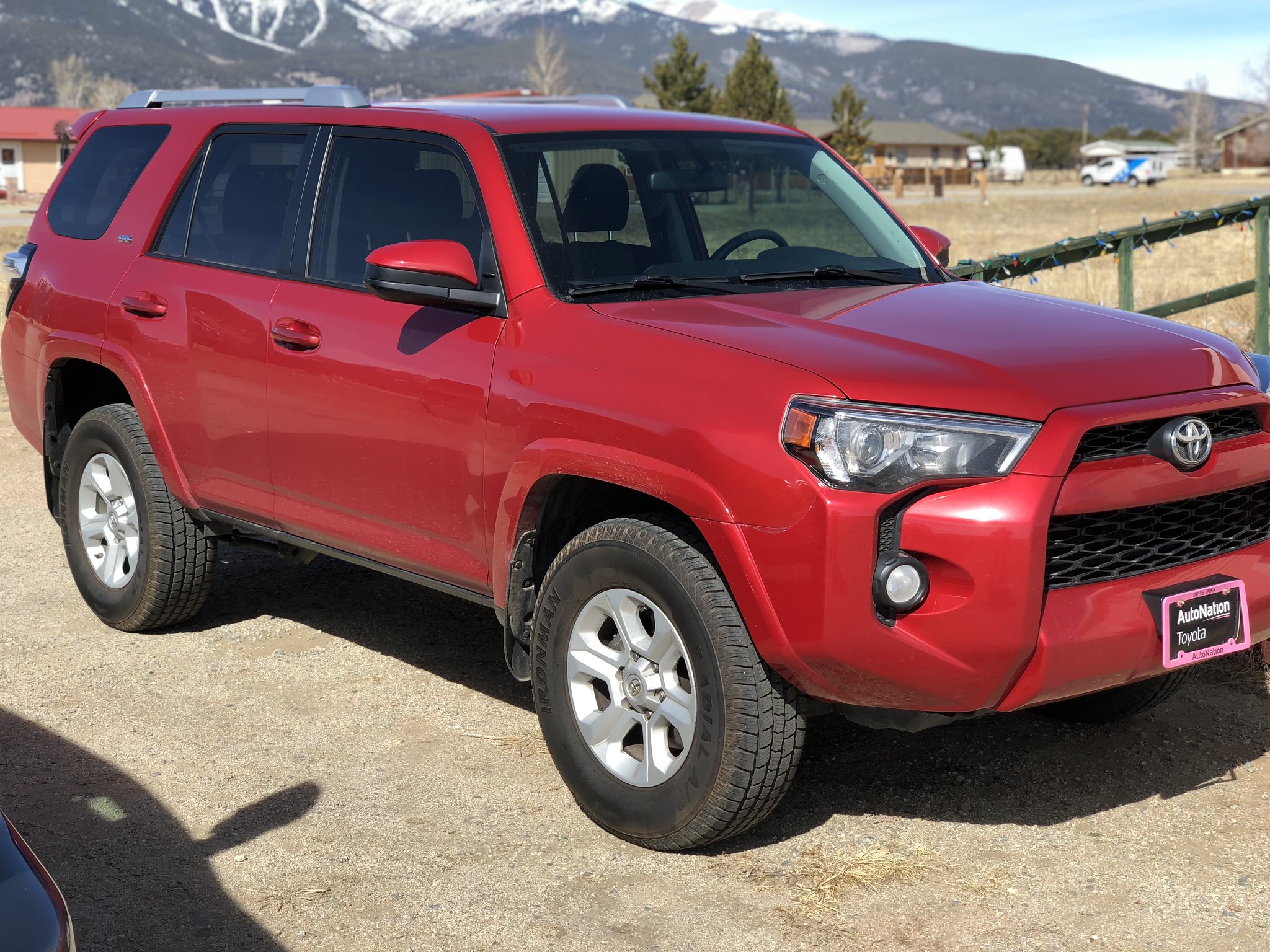

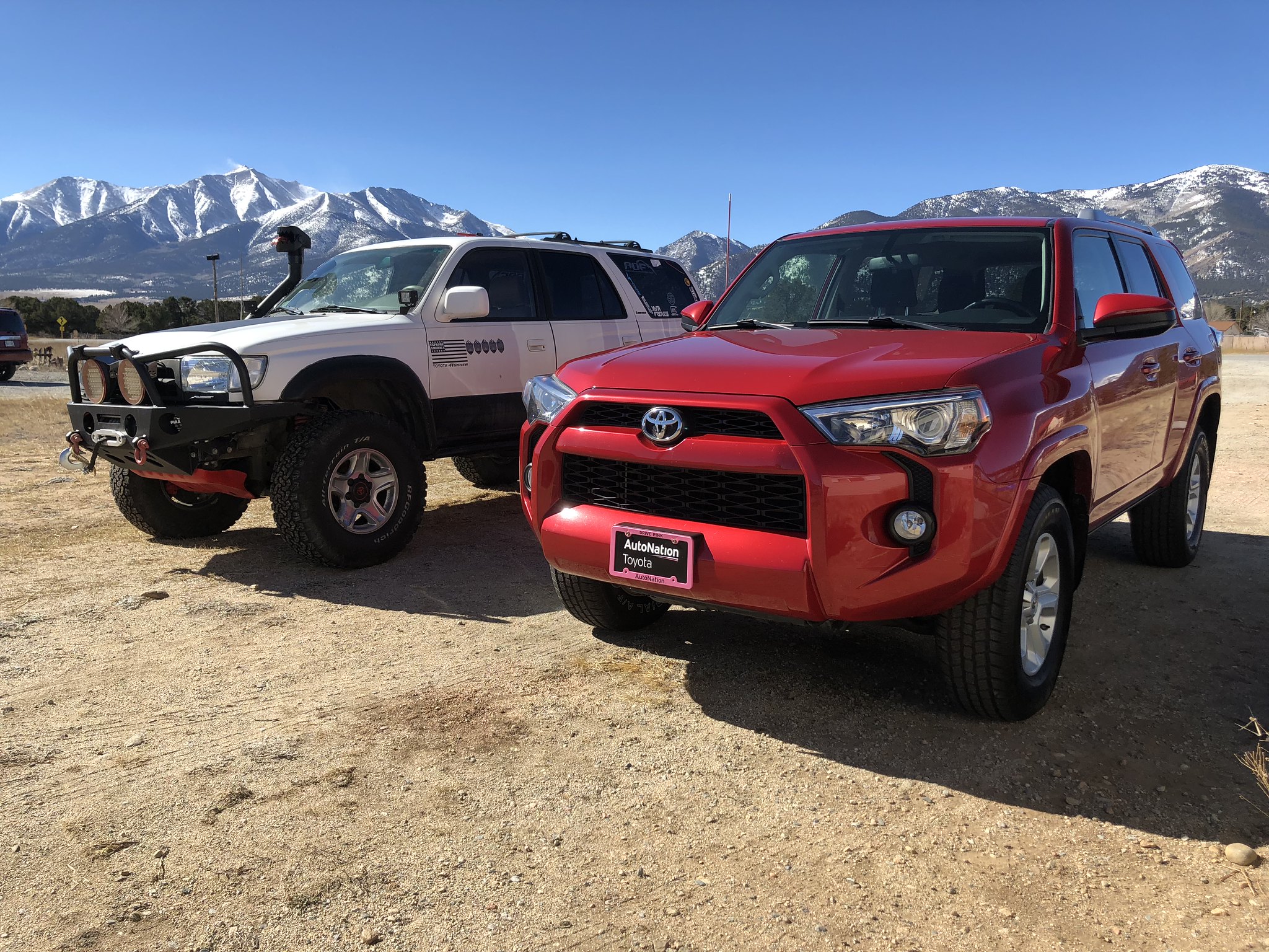

On to my 3rd 4Runner, 2016 Barcelona Red SR5. I am coming from a 1996 E-locked Limited. I am bummed about losing the E-locker, but I am pretty excited about getting into a vehicle will less miles. This is my wife DD and my weekend adventure rig, so the build will be nice and slow. Here is the starting point:
Untitled by redrunner87, on Flickr

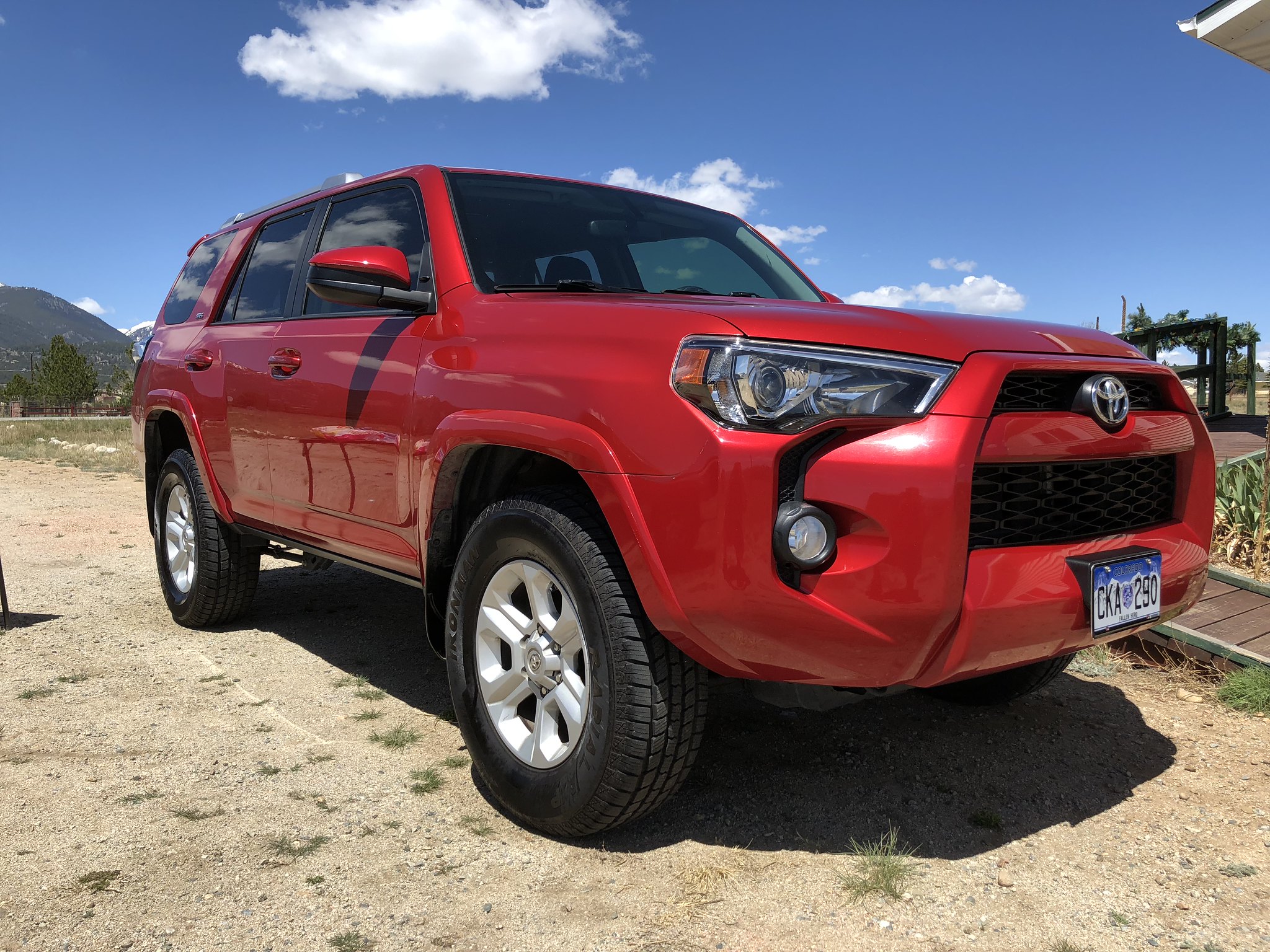

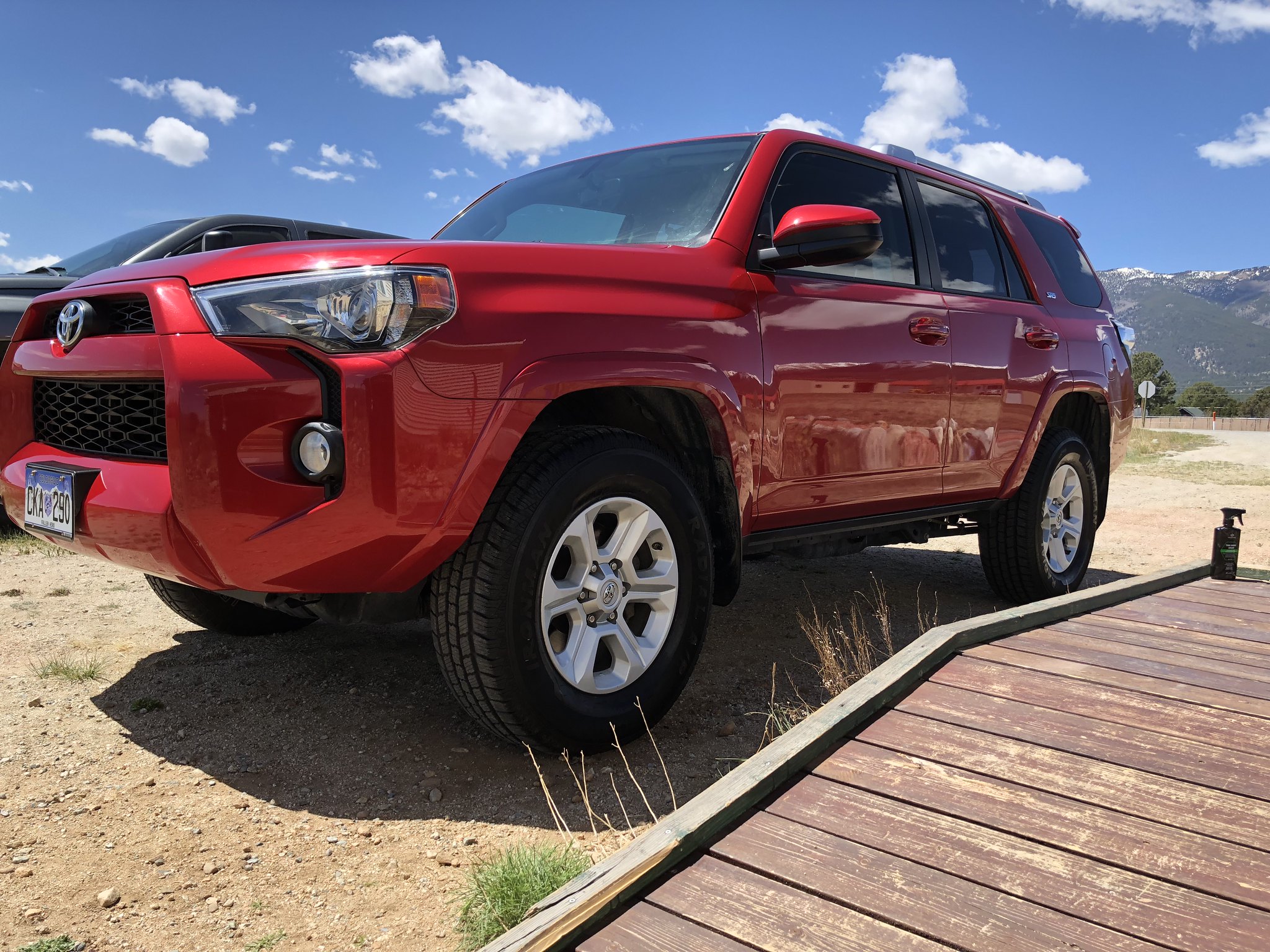

As she currently sits:
IMG_9114 by Red Runner, on Flickr

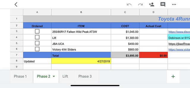

GOAL LIST
-Front Winch Bumper
-X20 Winch
-Combo Light Bar
-Dobinson Lift/Eibach Lift*Bought*Ironman Foam Cell Pro
-TSO FAUX TRD Pro Grill
-TRD Pro Upper Grill w/ Raptor Lights
-Trail Wheels
-255/80r17 Falken WildPeak AT3W
-Rock Sliders Sliders (Ordered)
-Detours of Maine Spare Tire Carrier
-C4 Fab Ladder
Mods on the truck right now!
Suspension:
- Ironman Stage 2 W/ Performance Springs
- Ironman UCA's
Wheels:
- WildPeak AT3'w 255/80R17
- Stock SR5 dipped Bronze
Interior:
- Center Console Organizer
- Glove Box Organizer
- CaliRaisedLED OEM Style Ditch Light Bracket
- Full LED Replacements
Exterior:
- Raptor Lights
- RAV4 Mirros
- Trail Standard Offroad Pro Grill
- CaliRaisedLed Ditch Light Brackets
- Amazon Ditch Lights
- High Angle Cut
Armor:
- Stock Skids
- Avid Off-Road Sliders
Electrical:
- 5 4-pin Relays
- 10-Way Blade Fuse Box
- 50 AMP Circuit Breaker
Planned Mods:
PHASE 1
-Full LED Exterior Lighting
-Full LED Interior Lighting
PHASE 2
-Dobinson Extended Travel Front/Dobinson Rear Lift or Eibach Lift*Bought*Ironman Foam Cell Pro
-255/75r17 Falken WildPeaks AT3W
-CaliRaisedLED Ditch Light Brackets
-Extreme LED Ditch Light*Bought*Amazon Ditch Lights
-High Angle Cut
-Rock Sliders
-Drawers
PHASE 3
-C4 Ladder
-Winch Bumper Bumper
-Dobinson Snorkel

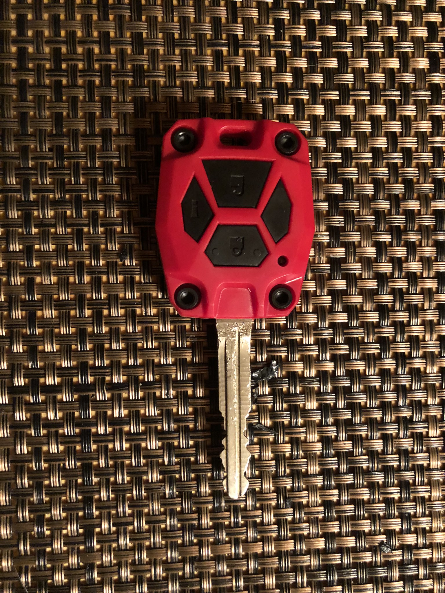

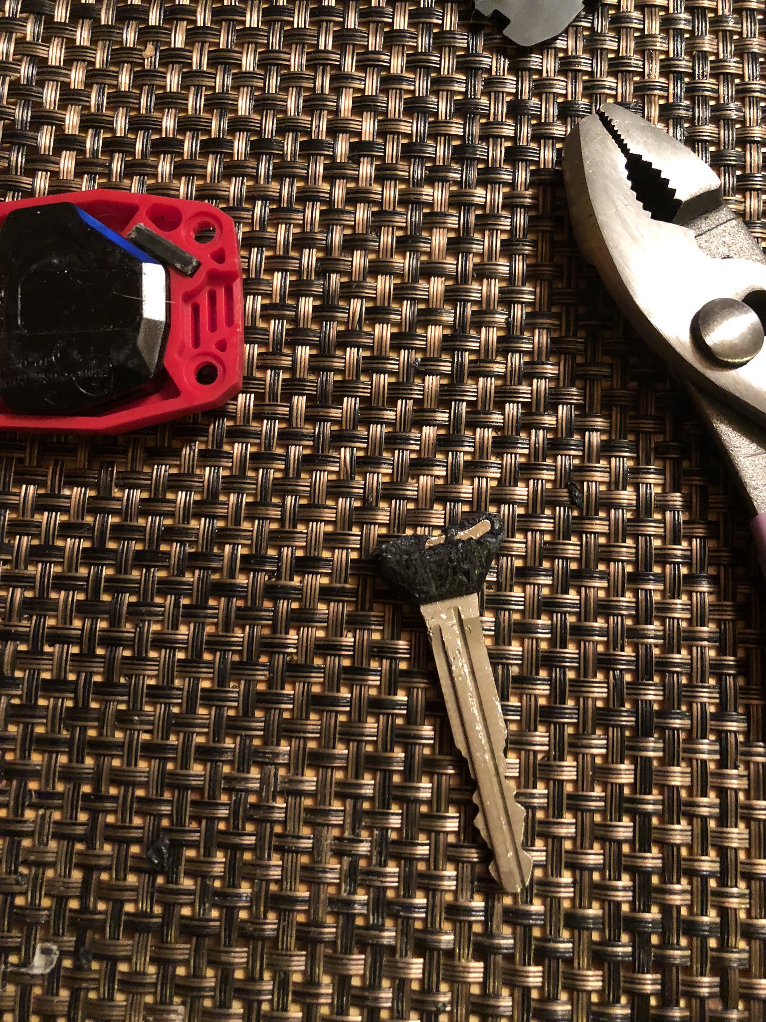

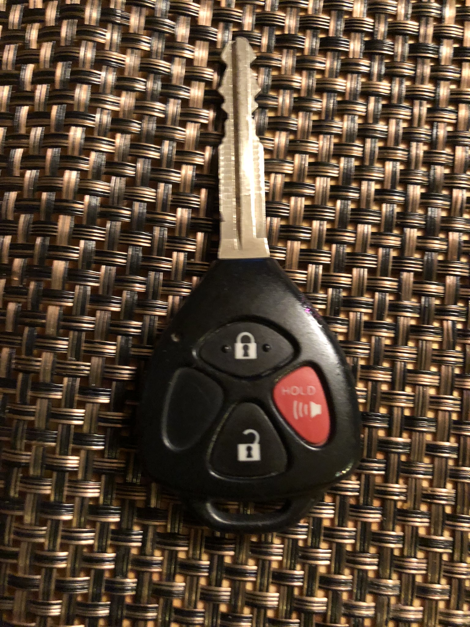

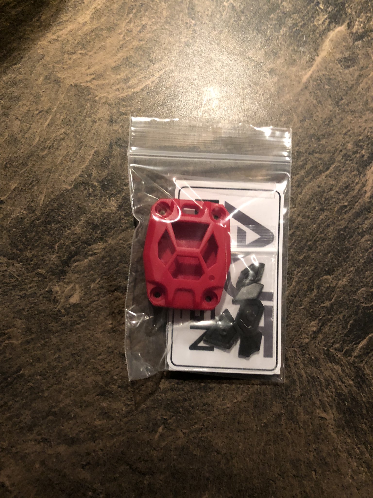

Received my AJT Design key fob in.
Of course my transponder was glued in, but I ended up destroying the key fob around the transponder. The hardest part for me was getting the key out the fob.
After a lot of prying and heating got the last bit up plastic off. Ordered a second set of red buttons so I can have the red panic button. I'll update when I get it.

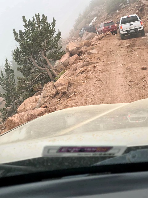

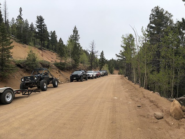

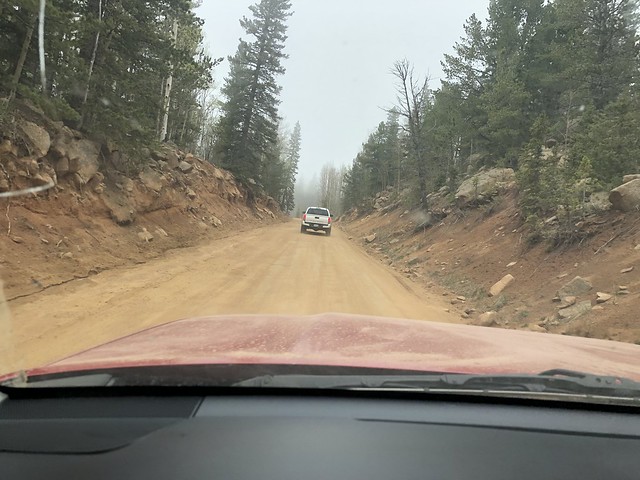

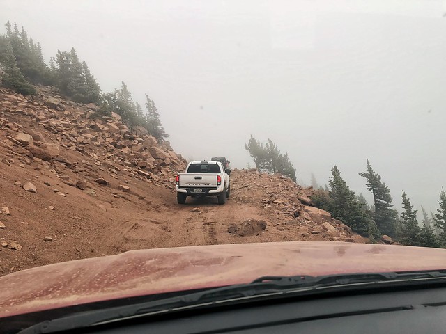

Mt. Baldy, CO. Went out with a local Tacoma group. This was first trip with the 4Runner. She did pretty well considering I have shitty street tires on her. Used ATRAC once on a super flex part, that I took a bad line on.

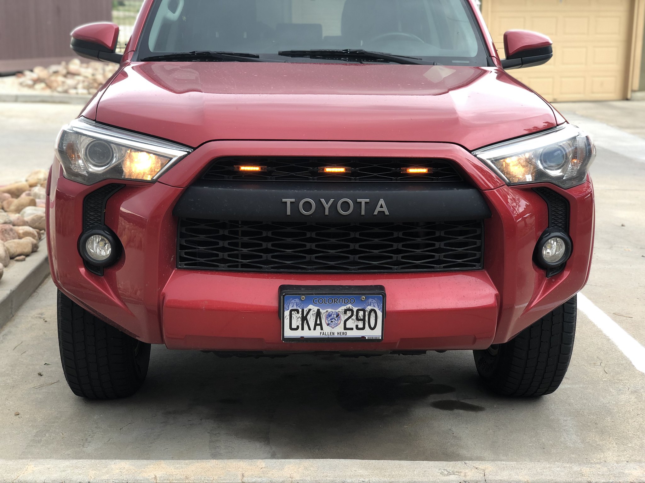

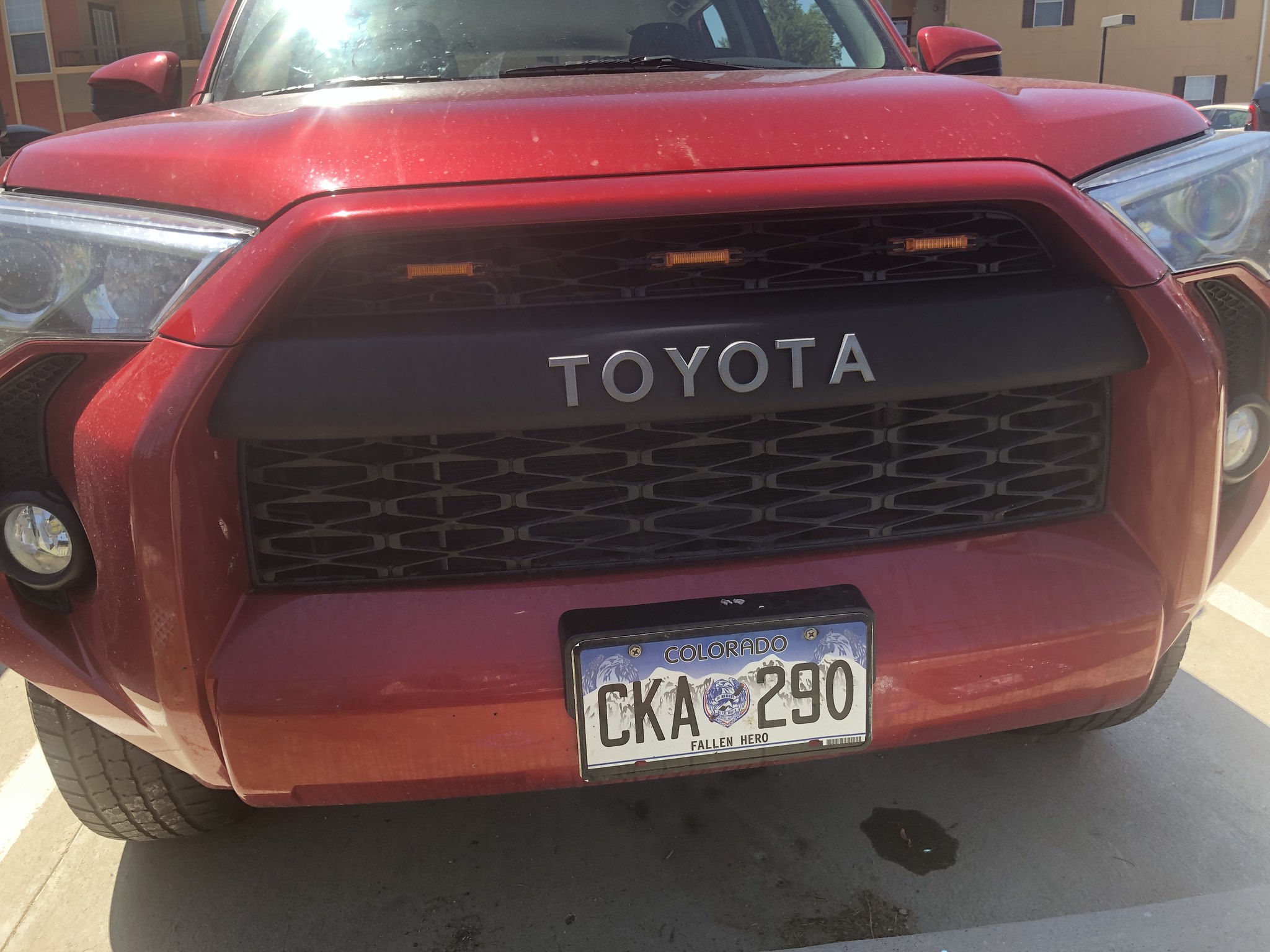

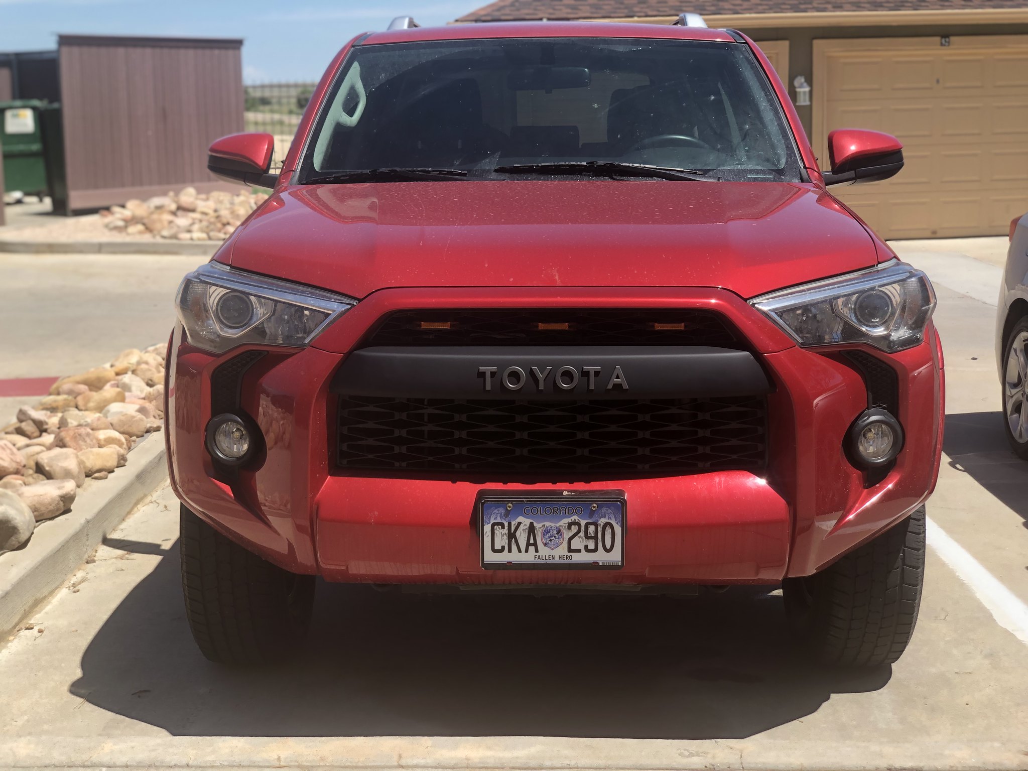

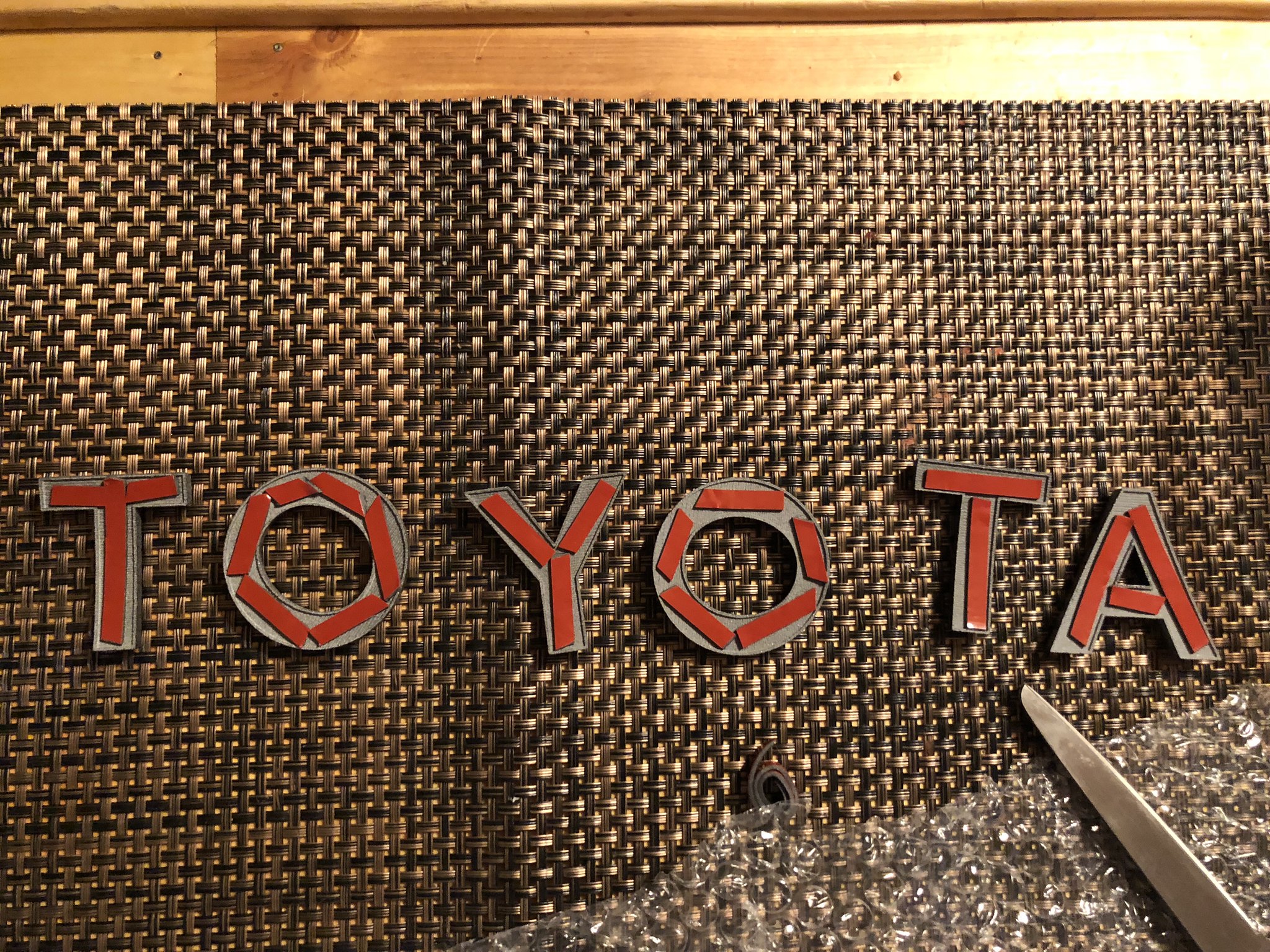

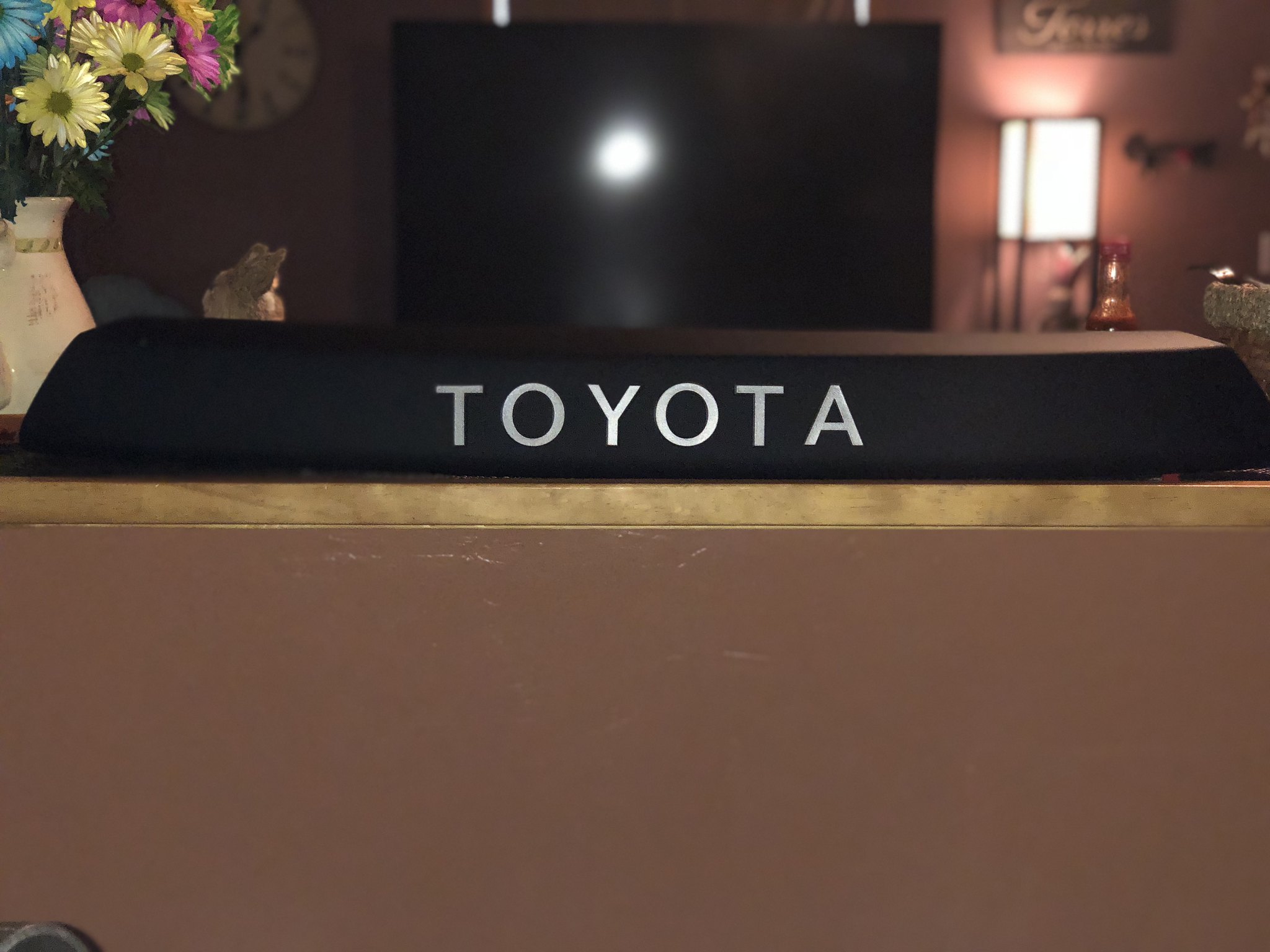

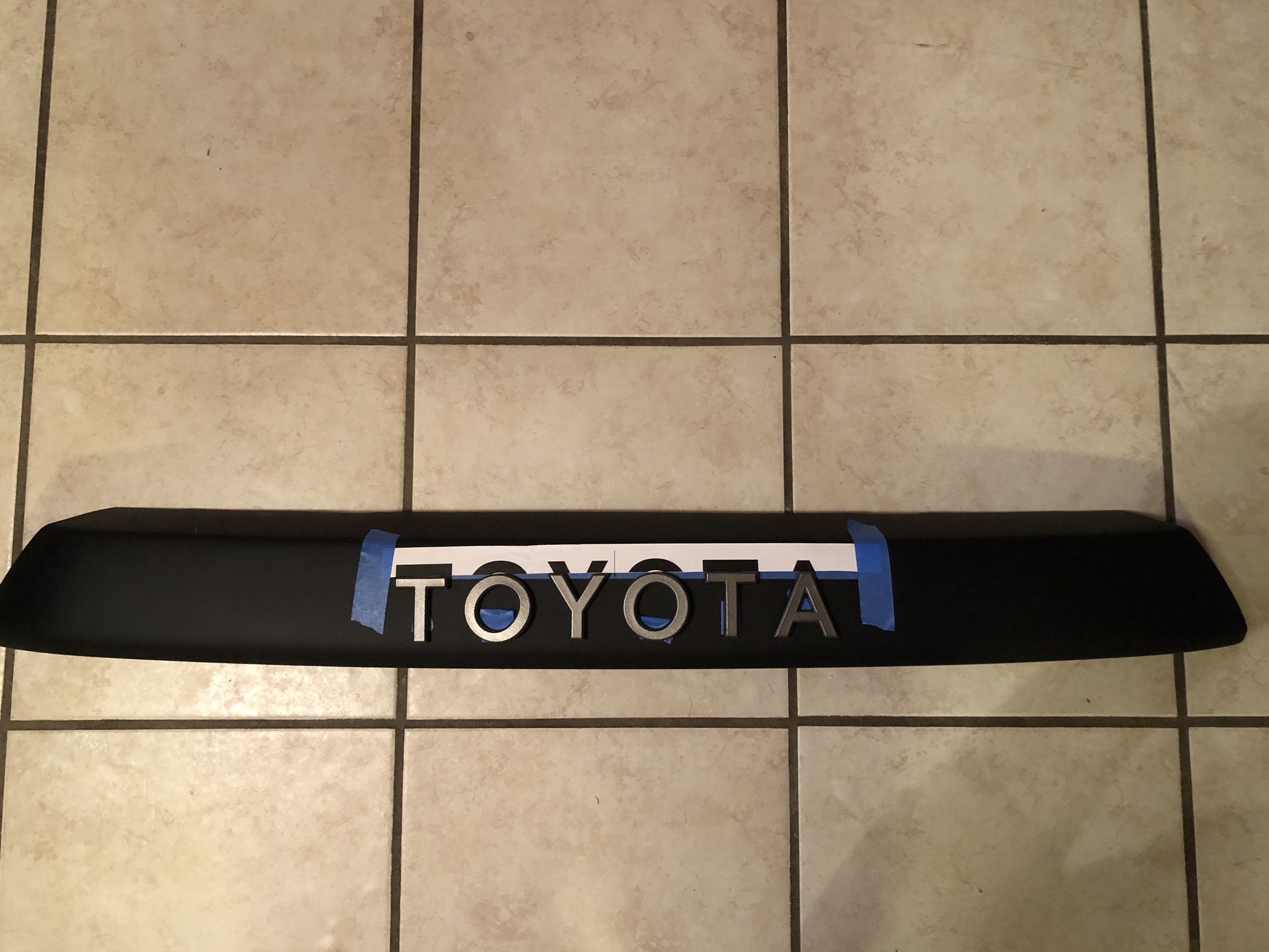

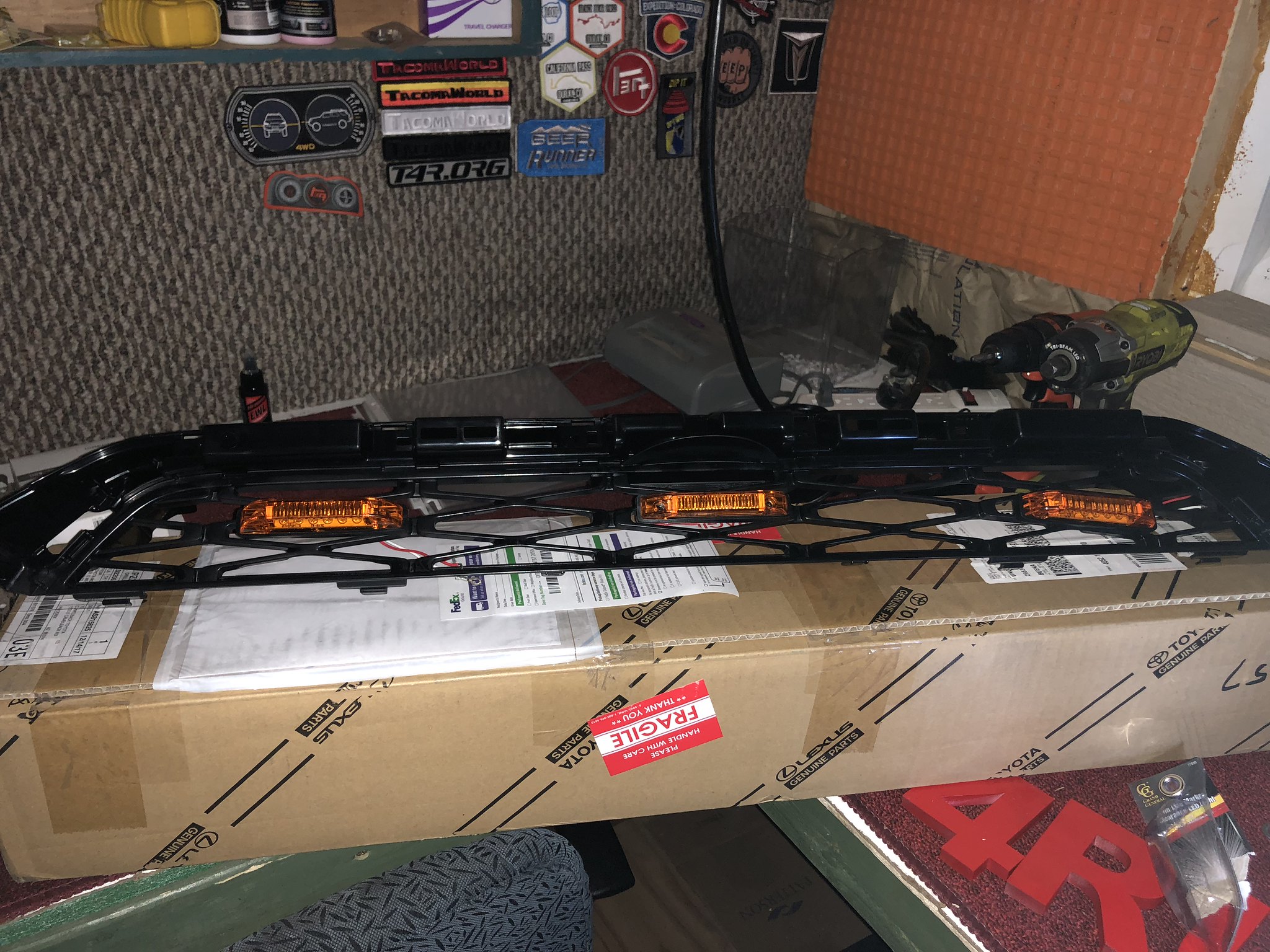

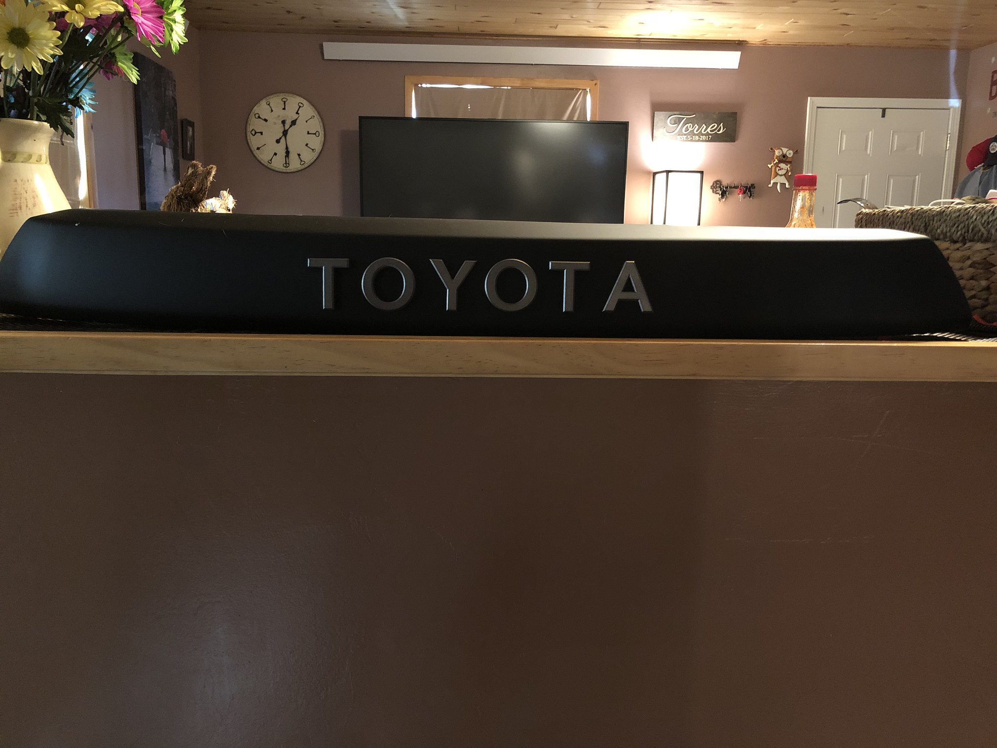

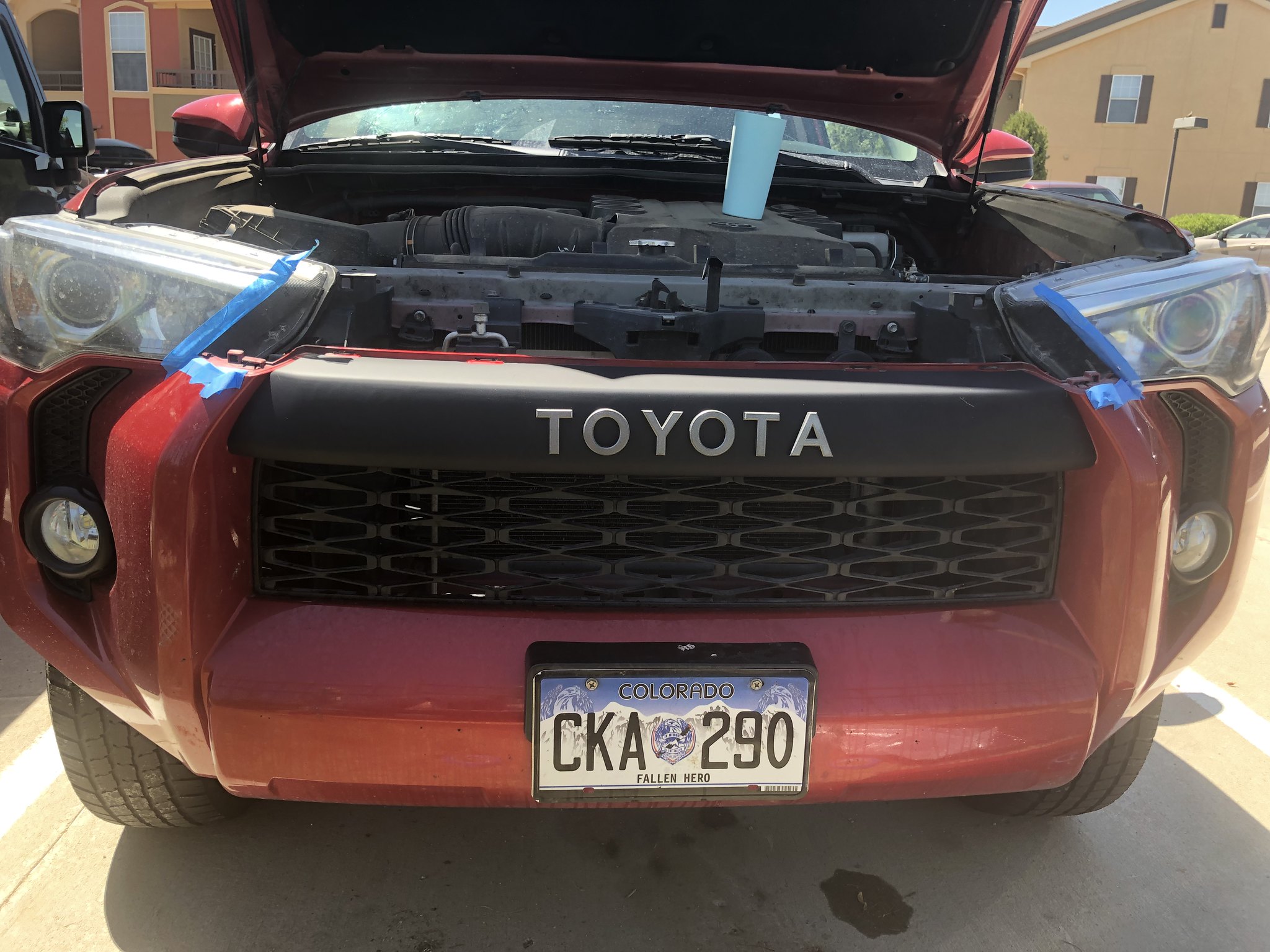

Finally after having it for almost a year and half, I have installed the OG Trail Standard Offroad Faux TRD Pro grill. Haven't wired up the lights, because my dummy head ordered full size fuse taps and not the mine. Hopefully I can get that done this week.
All Stock SR5

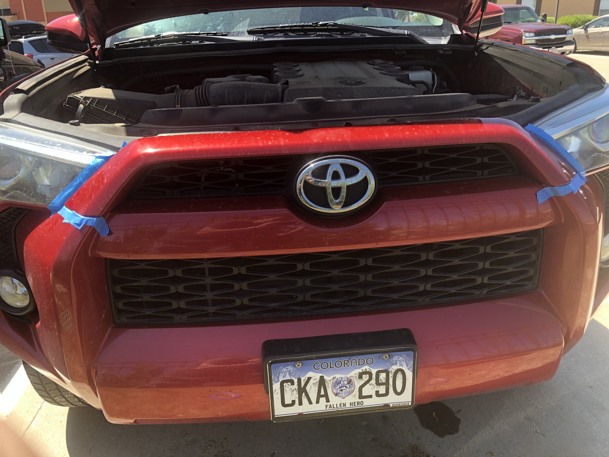

Tapped off the headlights and bumper to protect the paint

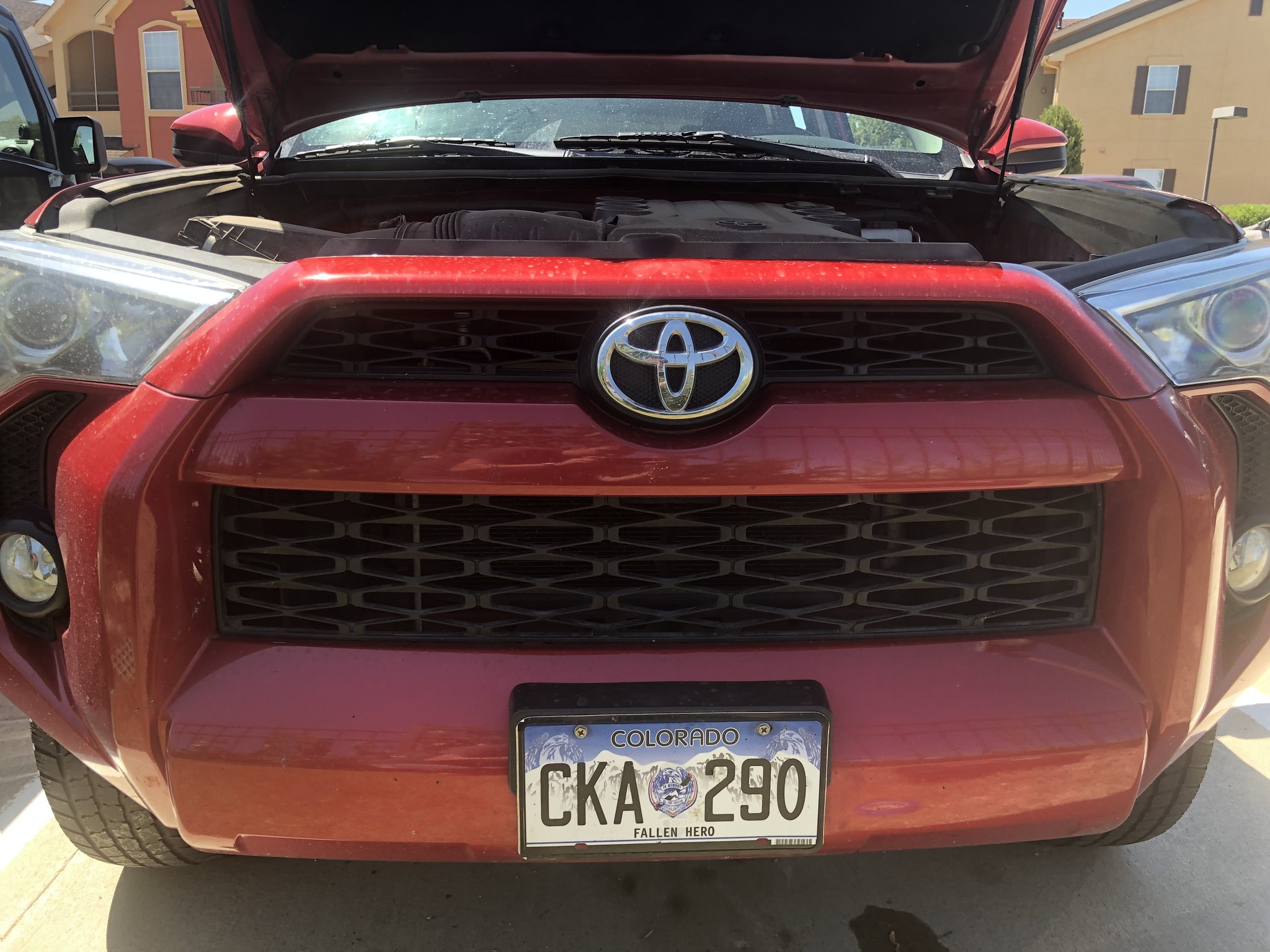

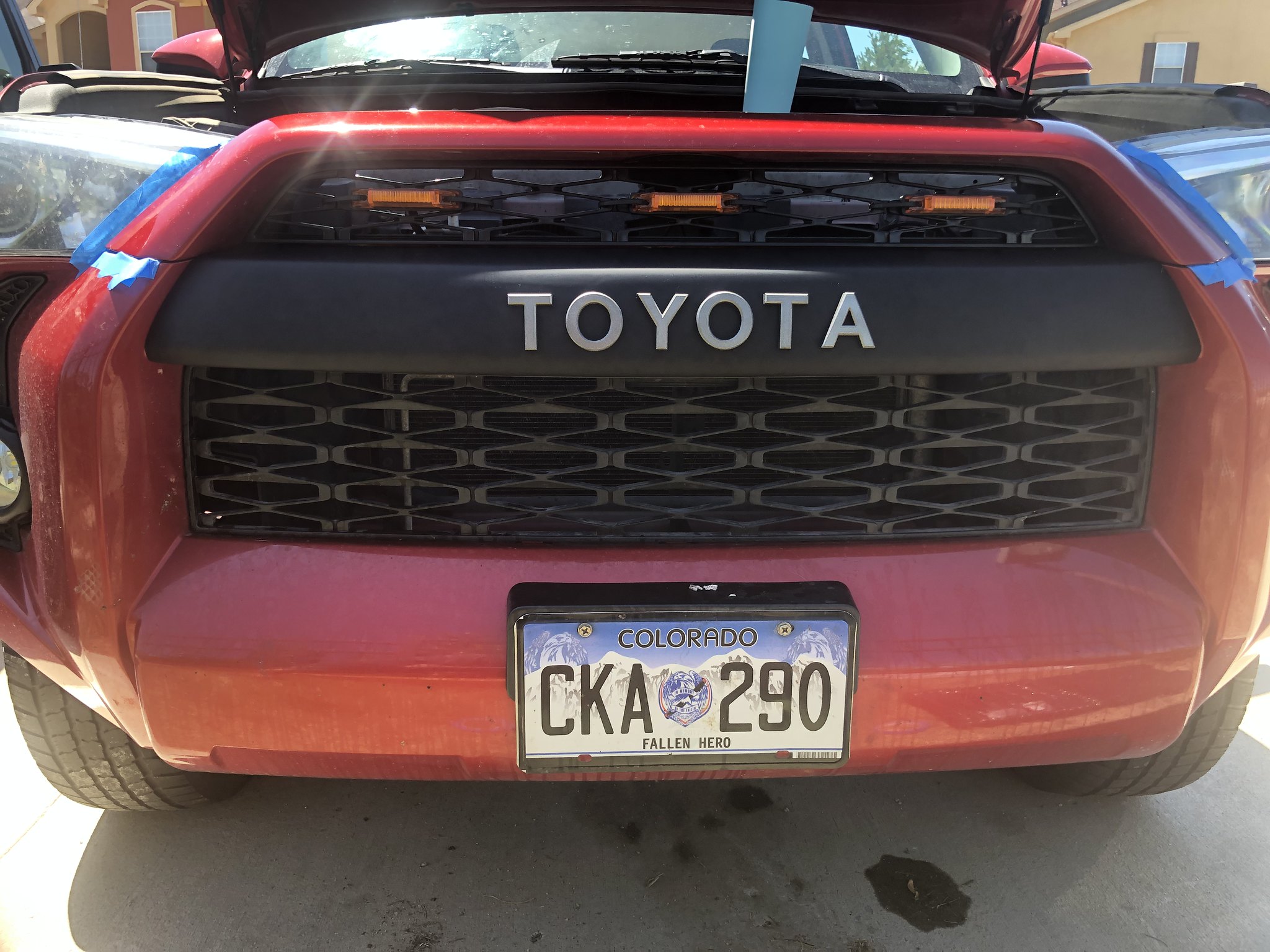

Cleaned the stock grill with dish soap so hopefully the TSO Grill will adhere better and its on!
Upper grilled installed
Finished product
Reactions: JCWages
RedRunner87
1,749
Colorado Springs, Colorado, USA
Vince
Torres

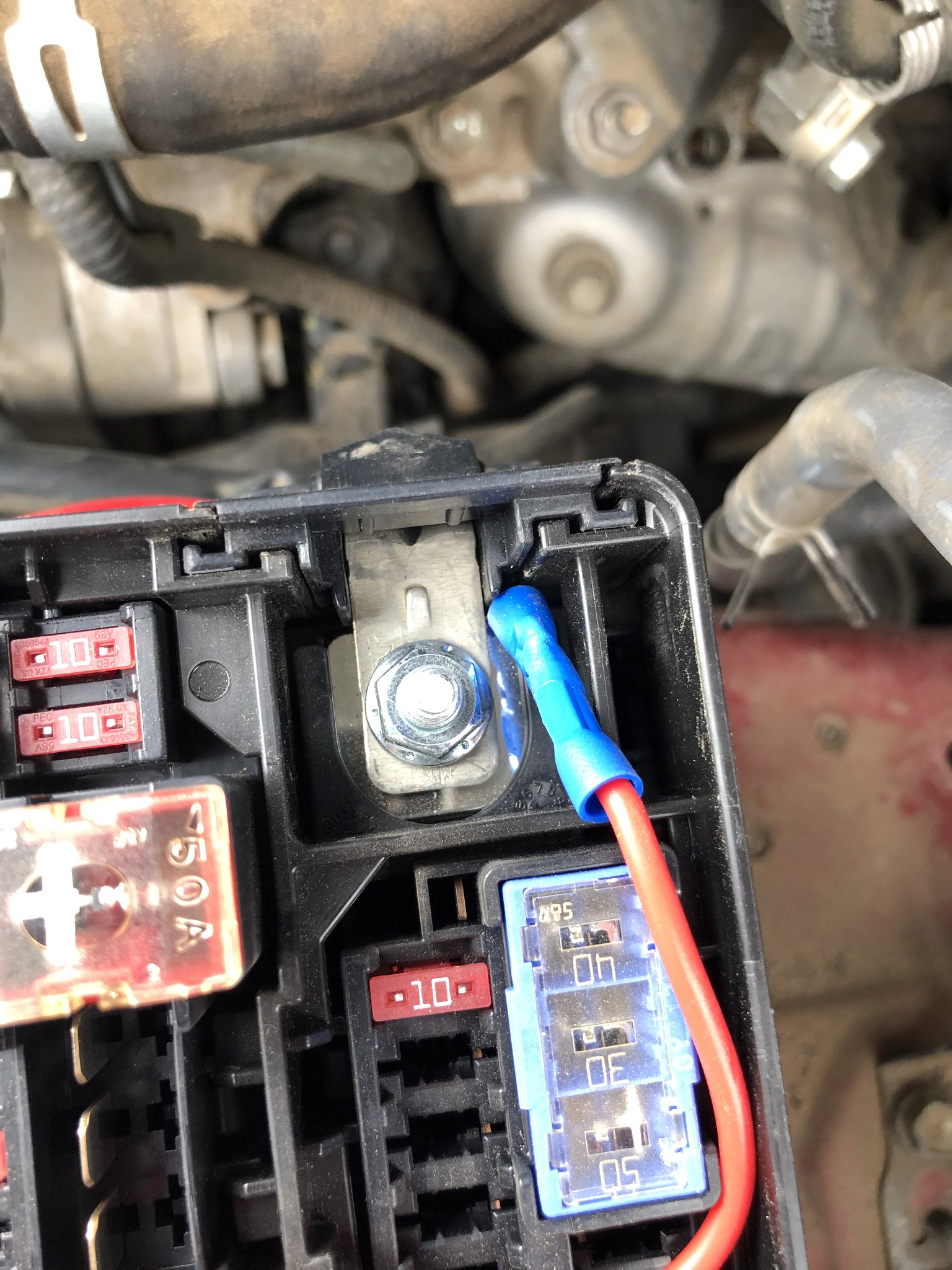

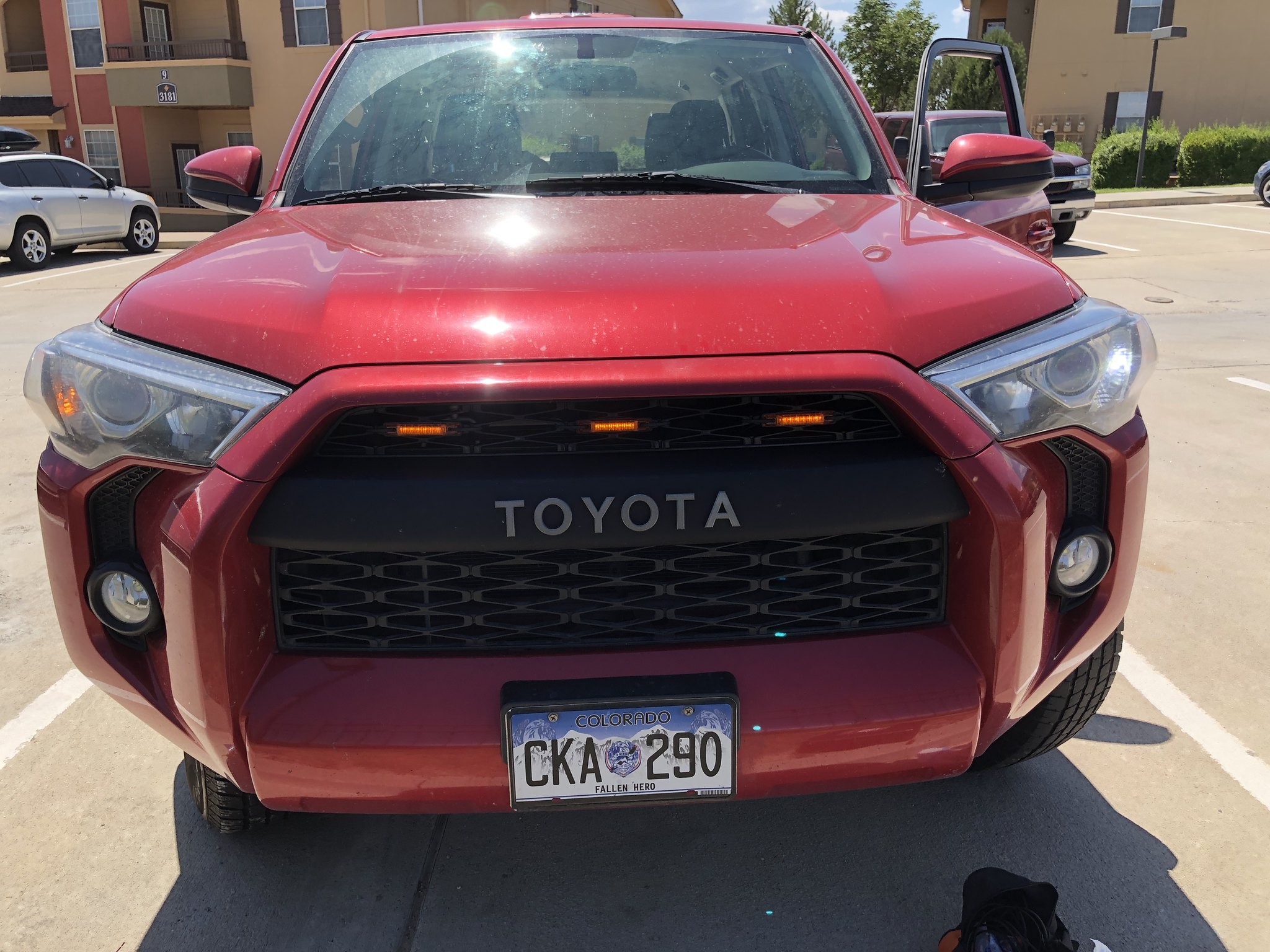

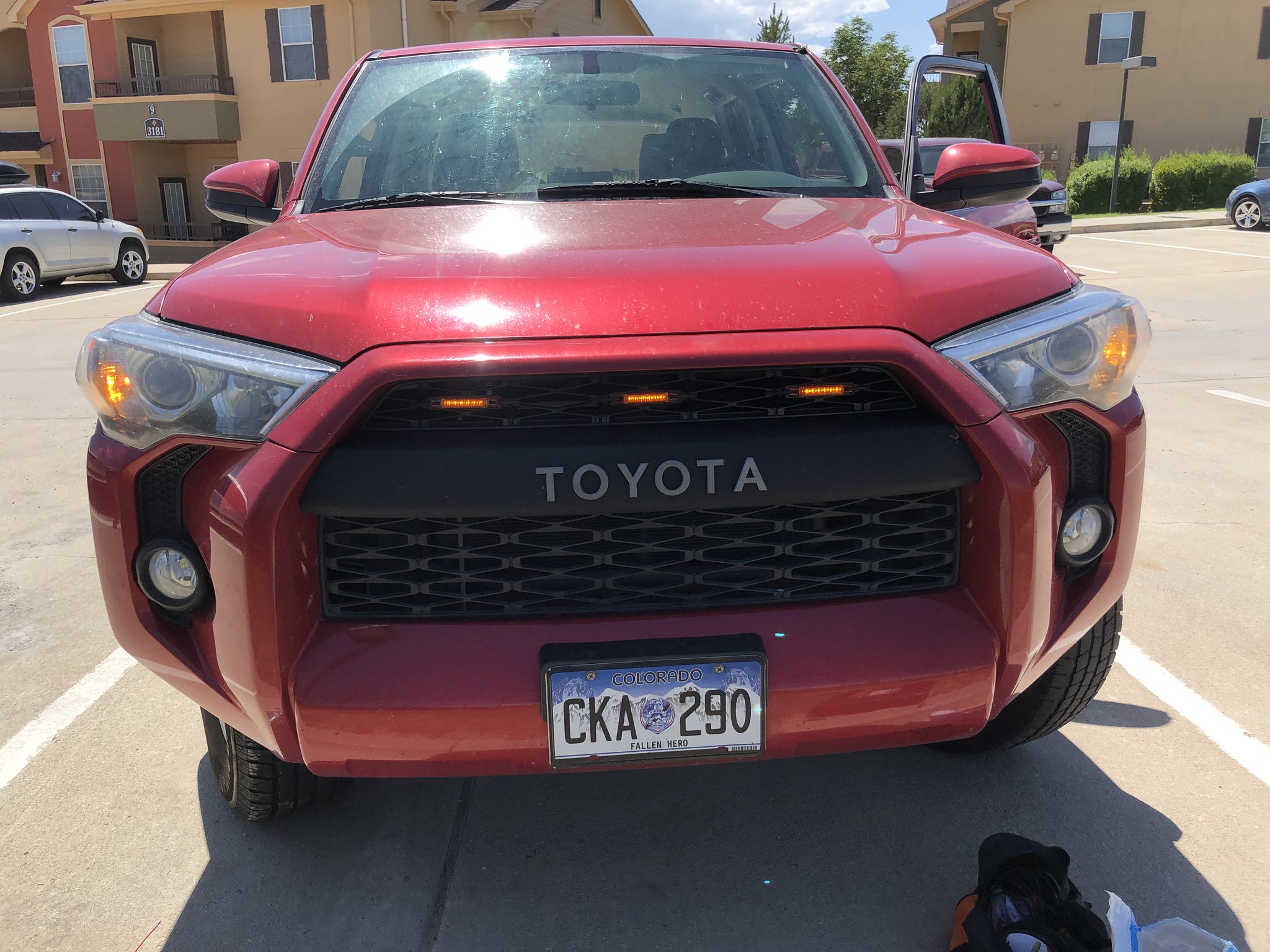

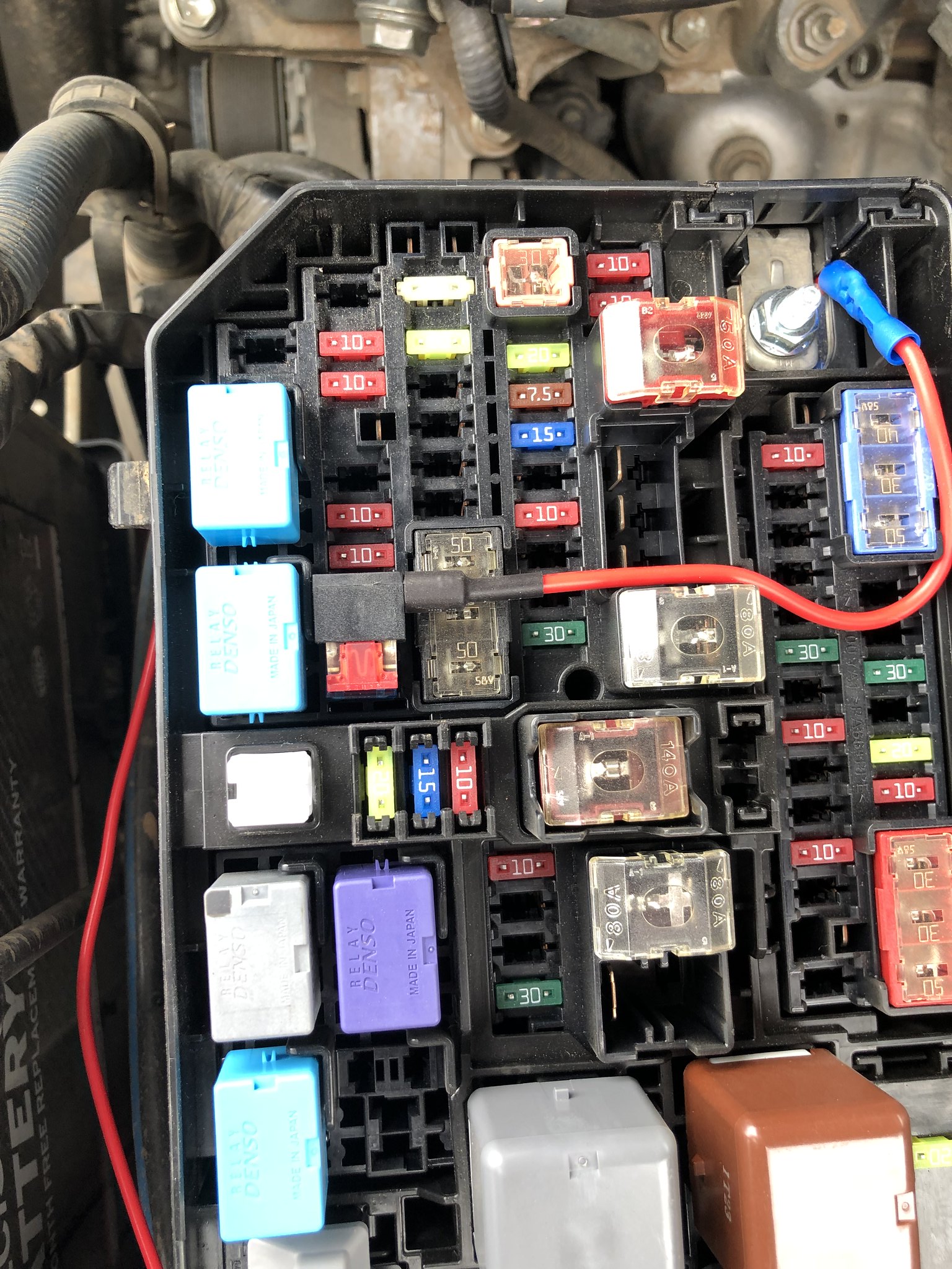

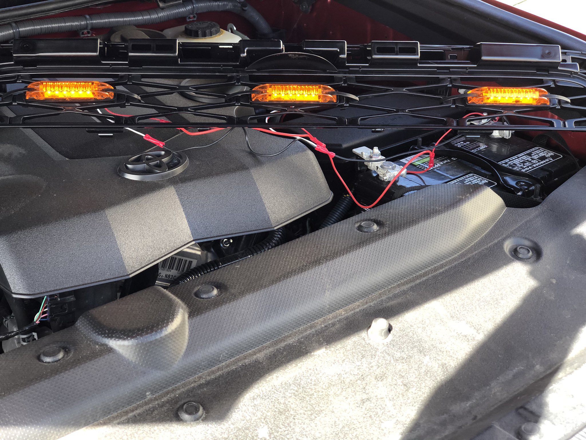

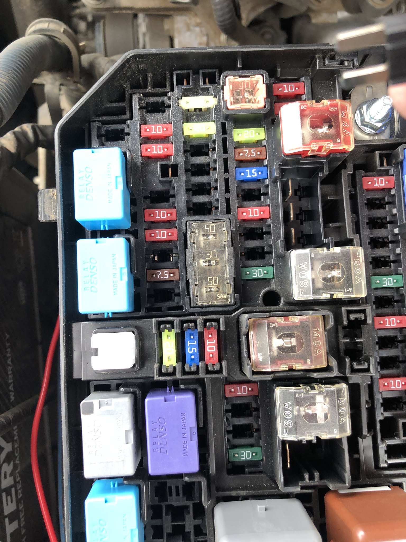

Finally got the "Raptor" Lights wired up. I did it a little differently and didn't tap the fuse by the Riverside kick panel, I tapped the fuse in the engine compartment.
I tapped the "INJ" fuse which is in between the 7.5 and 10 amp fuses
I then unbolted this bolt and ran the wire through it and re-did the bolt.
I ran the negative wire to the factory negative cable bolt. Now we have lights

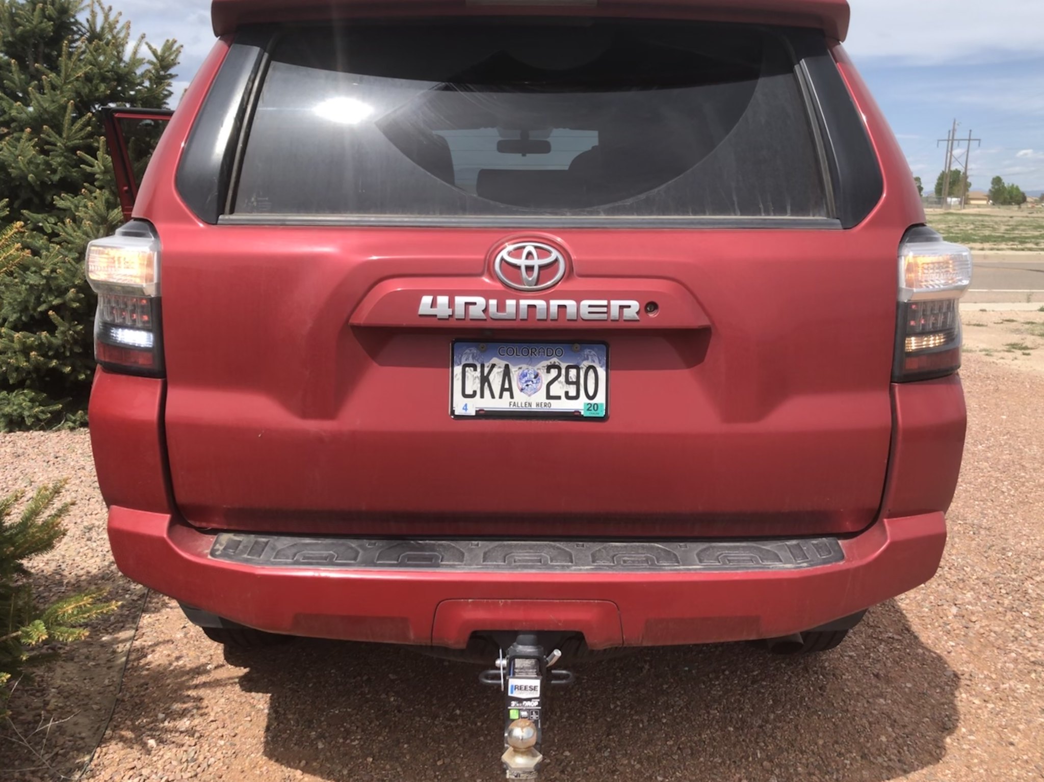

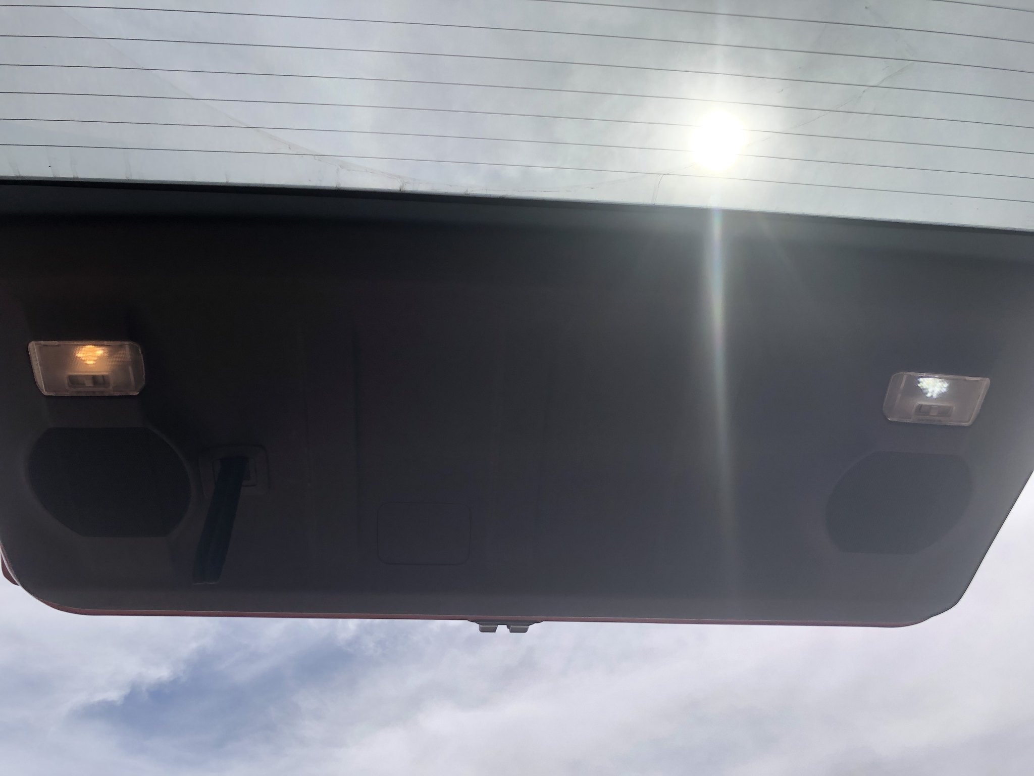

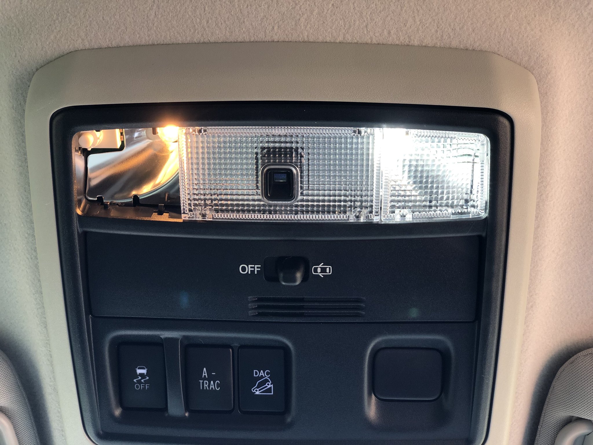

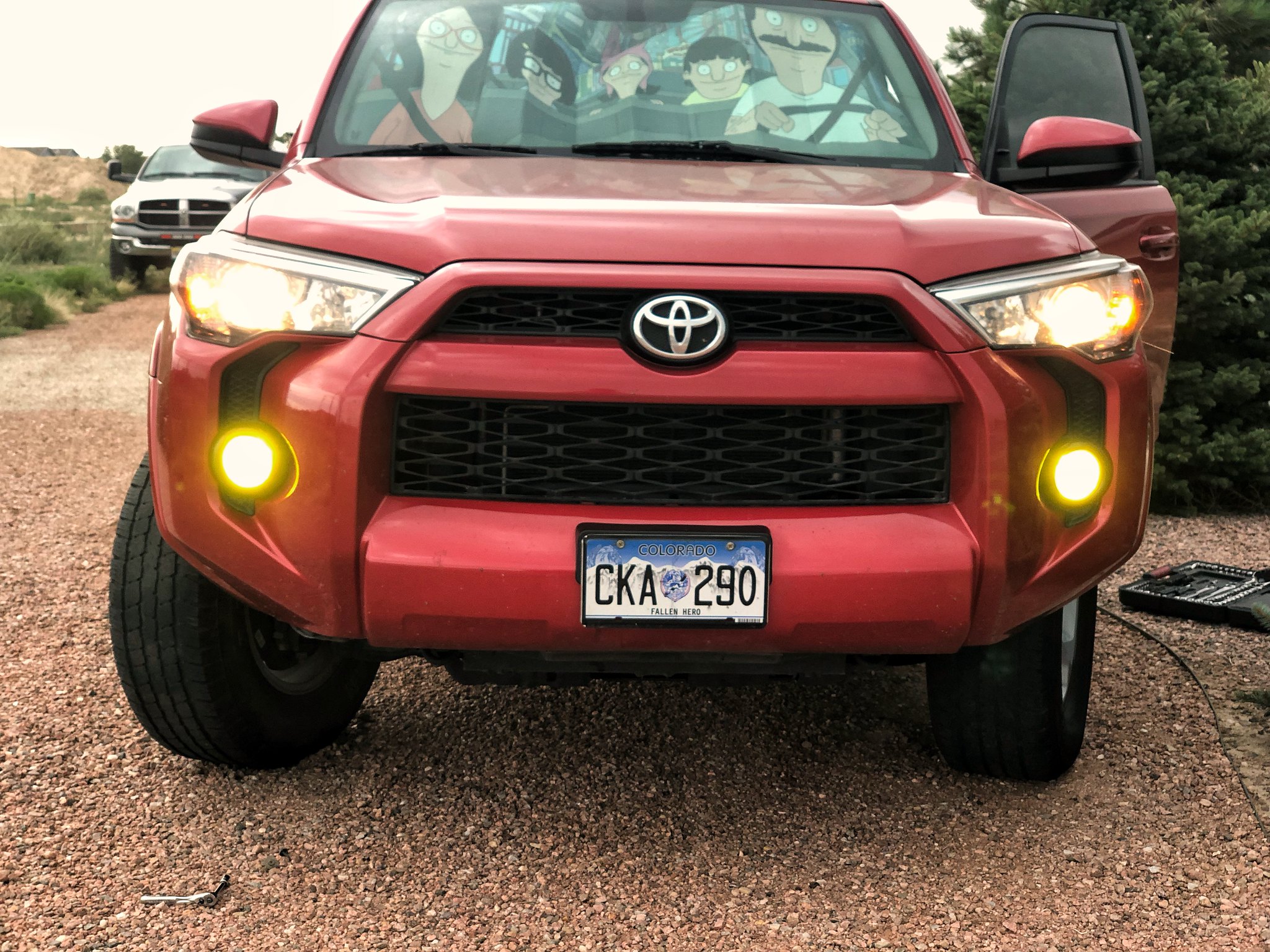

Got half of the switchbacks done. When I installed the rear LED turn signals, they didn't hyper-flash so I never installed resistors. Apparently with the front LED's installed I needed to put resistors front and rear. So it took longer than I thought it would, so only got it half done today.
Driver: Switchback Passenger: Stock
