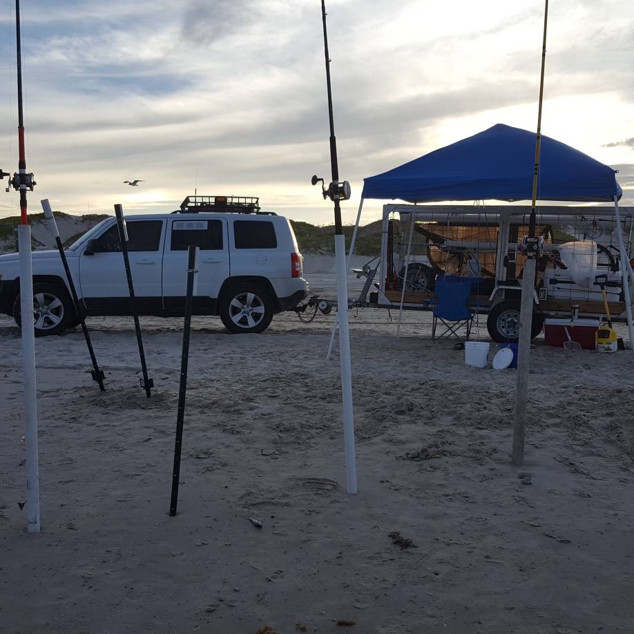

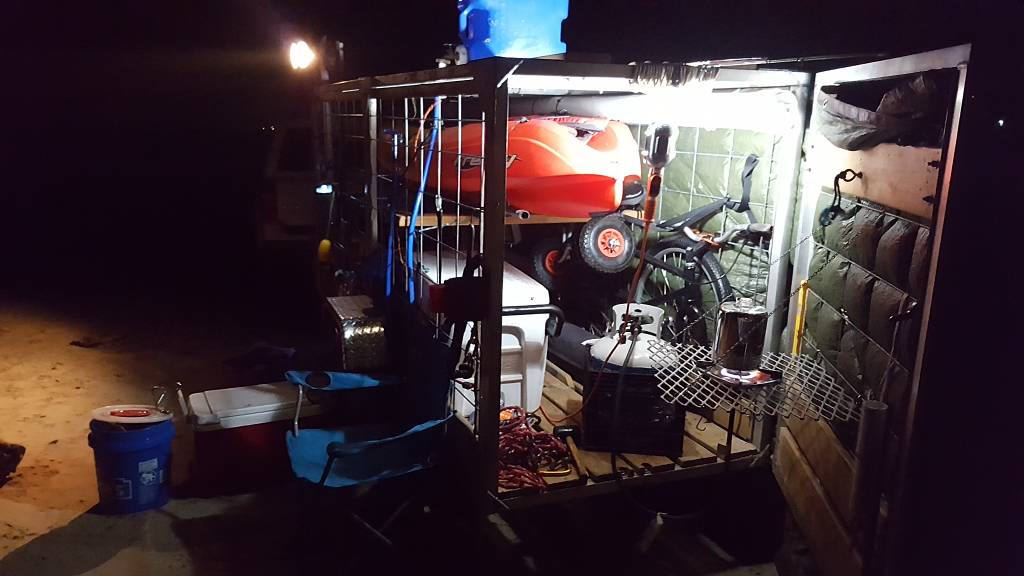

I can't even count the number of times I wish I had a winch in the bed or back bumper of trucks. It is usually easier to back out of a bad situation than go forward into fresh trouble or for pulling stuff in a utility application. This is especially true at the coast when a recovery point is either a dune, marsh or ocean. Luckily they make winch baskets for receiver hitches. Since you are a fabricator, I'd make a single winch plate for the 10k and a sturdy 2" hitch on each end. Then you can either run two sets of power wire or one long lead that can reach each end.
I also know what you mean by putting a winch on the back of a trailer to move it away. I had to do that the old fashioned way in my last trip to Matagorda since my jeep is also prone to bogging out when pulling my trailer through deep sand.
My recommendation on a trailer would be to put the winch on the front so it could be used to pull stuff into the trailer like a flat bed trailer and run a cable guide with roller or fairlead for if you want to use the back for recovery winching.
