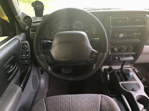

After my newest addition to my interior I decided now was a great time to give you guys a look at the interior of my XJ and what adjustments I have made over the years! I will include as many part numbers I can as well.
Starting with communication I went with a Uniden Pro Series CB radio pt#PRO520XL It is nice and compact and has all 40 channels as well has a PA speaker hookup.
Next for a radio I went with a Sony that has CD, USB and AUX.
For additional lighting for road use I replaced the factory 2 switch panel with a 3 switch panel from the junkyard so I can my LED fog lights under the bumper wired to it rather than the overhead switches.
My newest addition is a paracord wrap on my steering wheel. I chose to do this because my 20 year old leather wrapped steering wheel was turning my hands black and falling apart every time I drove it and I had finally had enough! I chose 100 ft. of black 550 paracord.

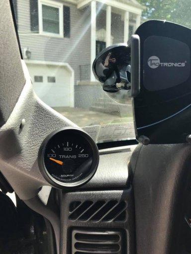

The cherokee comes with a pretty complete set of gauges especially for a 1997 but being that I have an automatic transmission I felt the need to monitor the temperature of during trips. I decided to do an A pillar mount so it is easily visible. I will do a full write up on the installation of the gauge. pt. #8349 by Auto Meter
And of course the good ol' cell phone holder which I'm pretty sure is a must to be considered an "overlander"

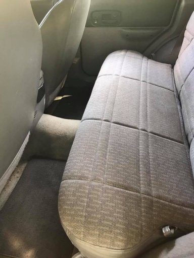

As for the back seat I love keeping it clean while I'm not on a trip!

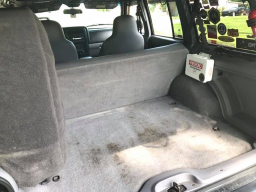

For the trunk I started by added a mag light mount for use on the campsite. I then decided to put all of my safety items in one place for ease of access so I mounted my complete first aid kit and fire extinguisher in the rear as well.

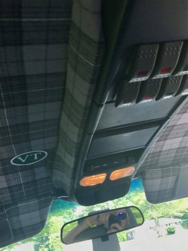

Lastly, I added a overhead console from a 1998 Cherokee. This required some customization to the 1998 overhead console wiring harness to the fuse box and a sensor to be added under the front bumper. I then added 8 rocker switches to it to control my accessories. And finally I re covered my entire headliner in plaid! Also, I have 1 patch as of now from my favorite state on my last trip Vermont!

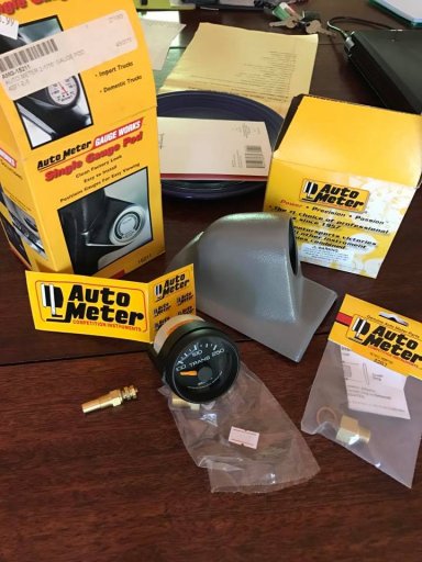

As promised here is a full write up on the trans temp gauge.
Starting with the parts you need:

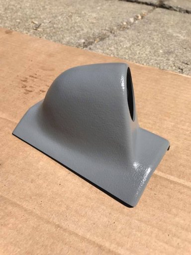

Gauge - pt#8349 This is actually a GM factory specific gauge that happens to match the 97-01 Cherokee cluster perfect. It has almost identical font and is green colored backlit and has an orange needle. If wired correctly it will dim with the factory gauges as well as mine does.
A-Pillar mount - pt#15211 This is for the single gauge pod Cherokee specific.
(For 97 or older) Adapter for the sending unit - pt#2267 This is a 1/8" NPT to M14x1.5 adapter.
And obviously wire and connectors. (I chose 14 gauge)
The A-Pillar mount comes black but I painted it with the closest matching paint to give it a more factory look. I used a satin light grey.

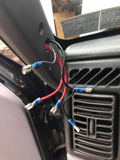

As for the wiring.... the gauge has 5 terminals that need wired.
1.Ground to power the gauge
2. Ground for the light (I jumped mine together as you can see above)
3. Power for the light. I tapped into the 3 switch panel in my center console for this. You need to find a DIMMER wire if you want the Auto Meter gauge to dim with the factory interior.
4.Power wire for the gauge. I went to an ignition hot source in the inner fuse panel for this.
5. Sending unit wire coming from the sensor in the transmission.

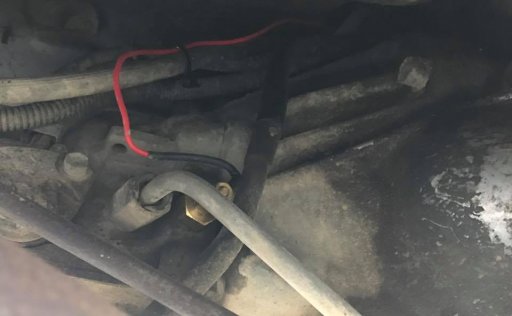

Here is a picture of where I installed my sensor. I want to stress that only a 97 OR OLDER Cherokee can do this. On the 99-01 AW4 Transmissions this plug is actually casted over. In that case you will have to cut into your hot line and add a sensor there. Which means you will not need the py#2267 adaptor like I did.
I chose to remove the plug in hopes of a more accurate PAN temperature of the trans. Like an average between the hot and cold line if you will. (It is a T-55 bit.) It was a very simple process and allowed me to avoid cutting into my trans lines (Which I already had anyways for the cooler lol). This is what you need the adaptor for.
The finished product! Feel free to ask questions!

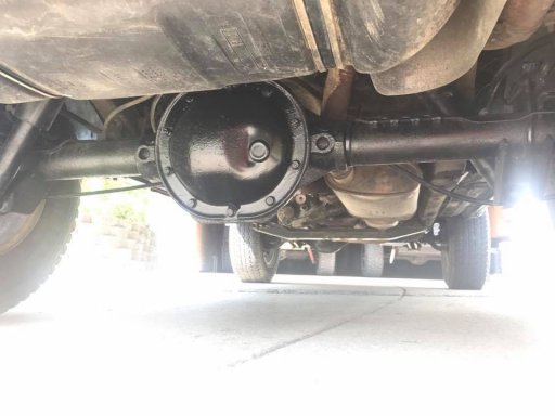

Well I haven't posted in a while so I figured I was due for an update! I finally received my OB patches and got them on as well as sanded and painted the entire rear axle!

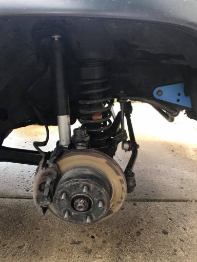

Since I have just recently started my senior year back at college progress has been slow. The only recent "upgrade" I have done is replaced the front shocks with ones from a JKU Rubicon for a better ride on bumpy, gravel roads. The difference is great and since they were free I would say the upgrade was completely worth it! One day I'll get a real lift haha

I have been considering this myself.. I have a 3in lift on my XJ but the generic white cheap shocks beat me to death. Is it a noticeable difference and they just bolt right in right??
Greg Galbo
1,798
York, PA, USA
Gregory
Galbo
2758
I would say overall they are better. It is a noticeably improved ride on rougher surfaces such as gravel or dirt roads. However, I have noticed a bit more body roll on the road so that is something to keep in mind. And they are bolt on other than the fact that JK's do not use bar pins so I had to press out the metal sleeve from the JK shocks and press in my old bar pins from my original shocks (total pain) but that is all you need to do. Hope that helps!
