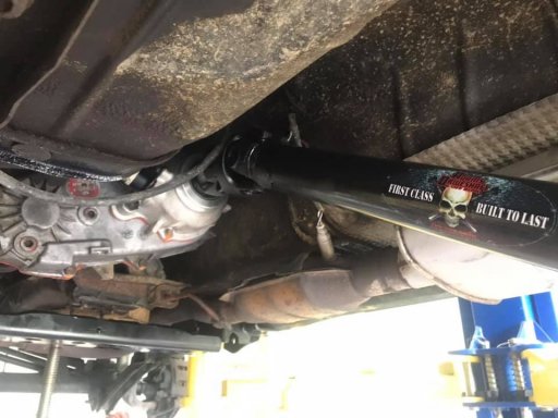

Once the rockers were completed it was finally time to fix the suspension and install a lift kit. I decided to go all out on the suspention as I wanted something that would be comfortable on the highway as well as capable on the trails! I ended up going with a long arm lift which was a difficult decision but as I was very concerned about geometry with putting a 4.5-5 inch lift on it made sense to instal to longer arms to maintain a flater angle like factory. I will list below the list of components that I used on the lift kit. A few things I still plan on installing are an Adams front driveshaft and Metal Cloak front dual rate coil springs to fight the springs coming off the body on full flex and maybe different shocks at somepoint as well. Feel free to ask any questions!
  1. Iron Rock Offroad 4.5 inch "Rock Link" Long arm lift kit with full leaf packs
  2. Doetsch Tech shocks
  3. Crown Performance extended brake lines
  4. JKS quick sway bar disconnects
  5. Advanced Adaptors slip yoke elliminiator
  6. Adams rear driveshaft
  7. Azzy Design Works rear shock mounts
  8. Rough Country shackle relocation brackets
  9. Iron Rock Offroad extended leaf spring shackles
78306309_3310026222402789_7090057554683756544_n.jpg78074164_3310026235736121_8001438881771683840_n.jpg78242598_3310026305736114_3400836571912470528_n.jpg78128275_3310026502402761_1941898183609155584_n.jpg78165166_3310026405736104_5228752714397122560_n.jpg78454731_3310026392402772_3455904696961597440_n.jpg78265731_3310026999069378_7411721373606739968_n.jpg
