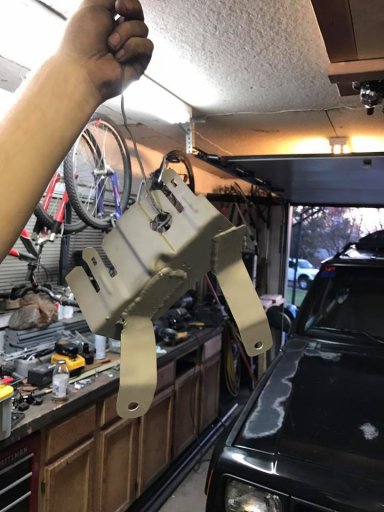

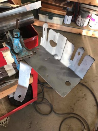

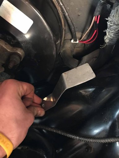

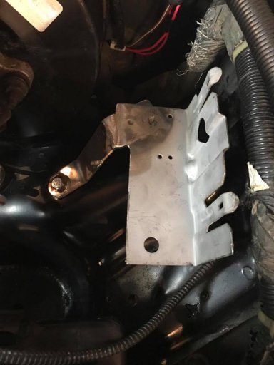

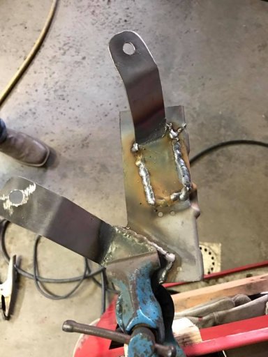

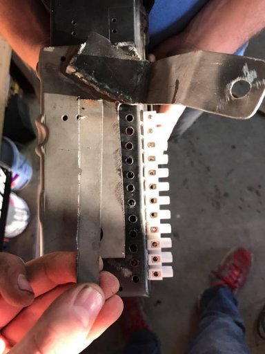

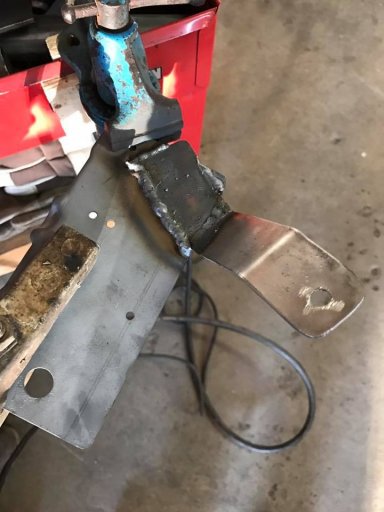

We then began bending the first leg of the bracket by the brake booster aiming to use two holes that are already in the engine bay keeping in mind the final placement of the box.
Greg Galbo
1,798
York, PA, USA
Gregory
Galbo
2758
Next we had to clearance the hols for the power wires to come through the box.

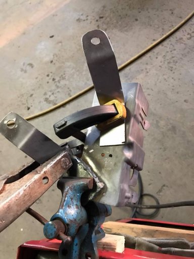

After that we bent the second leg and got it ready to be welded on!
And here it is welded on

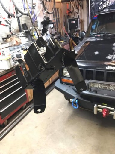

Here it is ready for paint!
And finally painted.

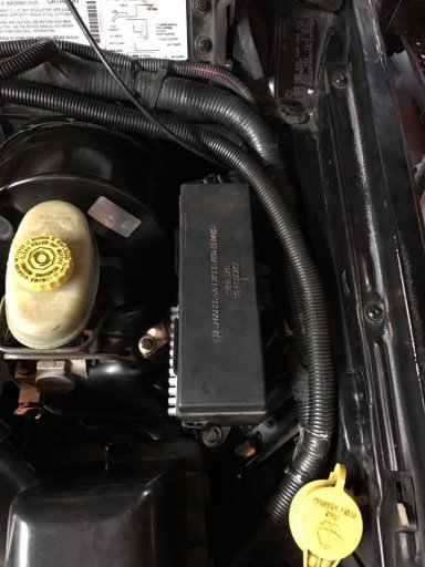

And here is the final placement of the box! Now mine is a NON ABS Cherokee which is the only reason why I can put it here. The bracket is plenty strong enough to support the weight of the fuse box. Next up is the wire everything up! Stay tuned!

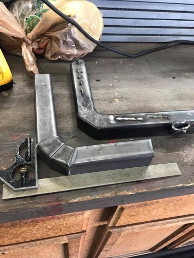

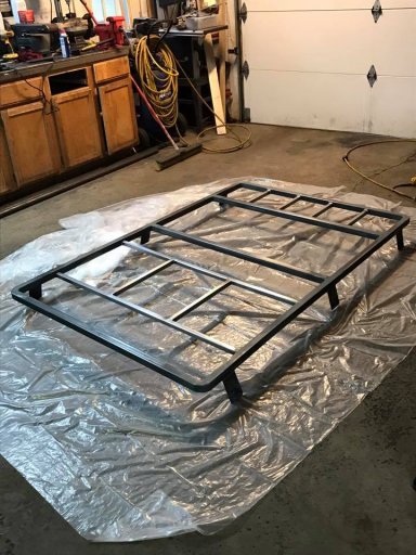

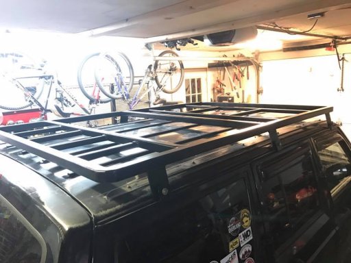

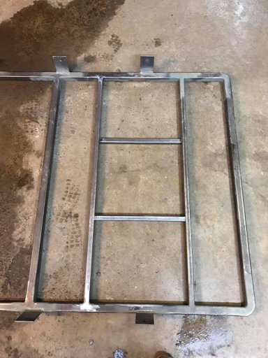

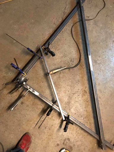

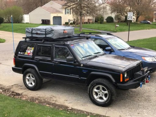

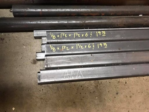

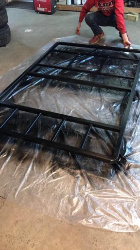

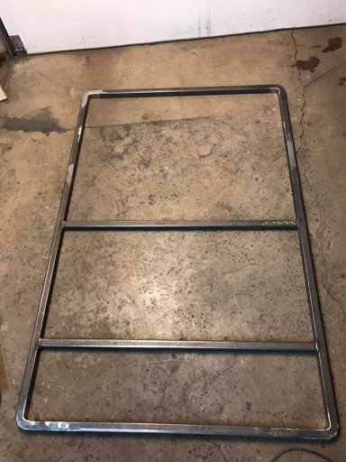

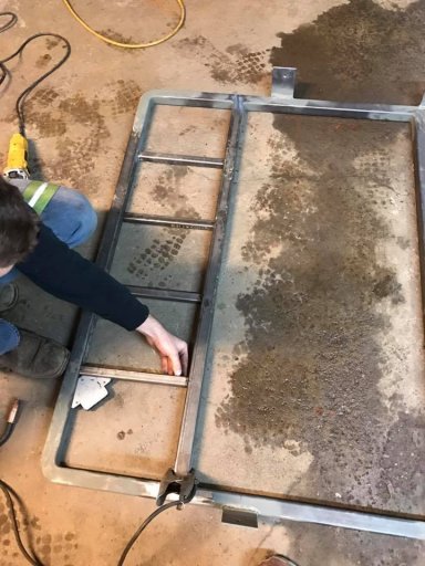

Finally began work on my custom roof rack. It is made to hold a roof top tent and have a small amount of storage in the front. I'm using 1.5 inch square tubing which although harder to use than round tube I believe the end result will be worth it! The hardest part by far was figuring out the corners and how to bend them sharp and as round looking as possible. Enjoy and if anyone has any questions at all please ask!
17202923_1424150657657031_8229159785183293983_n.jpg 17265144_1424150494323714_1924256922341205614_n.jpg
These are TEST corners...
Final corner design inside our homemade corner jig!
Here it is welded up and almost grinded all the way. the two 1.5 inch bars are spaced out to hold the tent evenly. I am adding smaller 1 inch bars in the front to hold things.
Greg Galbo
1,798
York, PA, USA
Gregory
Galbo
2758

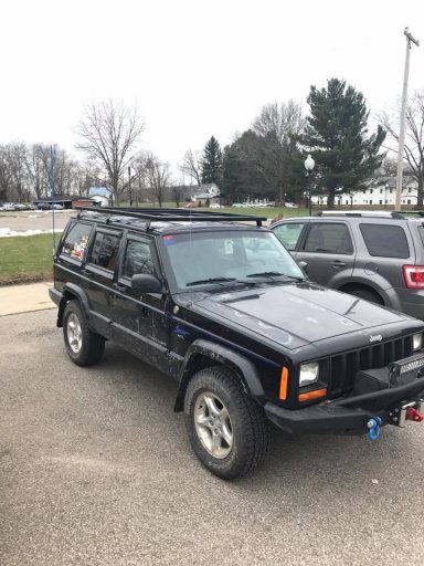

Finally got the rack to a point where it can be put on the jeep! added the center sections and finished the mounts (included cutting the outer 4 off and moving them out for a better look). I love the design and I plan on added flooring of some kind to just the front half since the back half will be used by a RTT at some point!

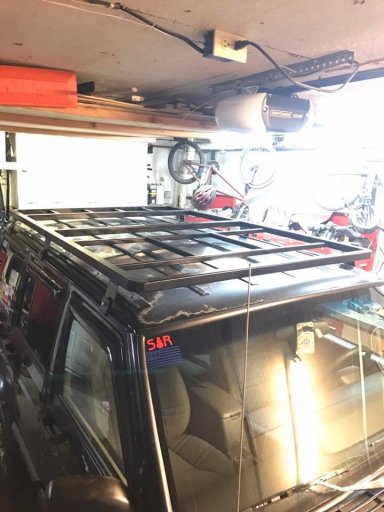

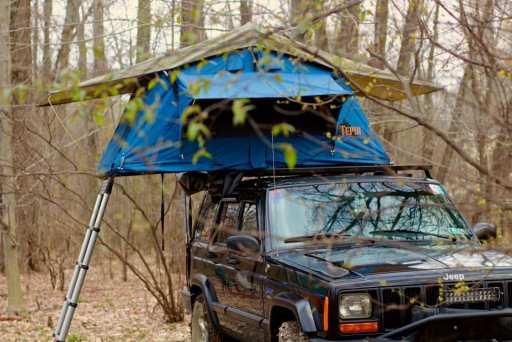

Well I'm in college until the beginning of May so probably around then? I also do tax returns so that is my life until April 15th lol (and yes I know how boring that sounds haha) What works best for you and your family? Also here is a picture of the rack outside in the light! (sorry I'm excited about it haha)

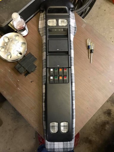

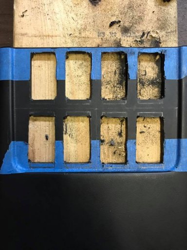

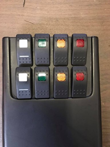

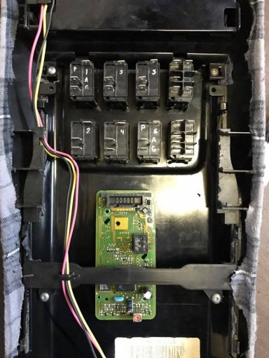

Finished my latest project of mounting switches in my factory style overhead console. I thought it was a neat and clean way to get 8 auxiliary switches in the cabin in a low key (not in your face kind of way) I also have labels coming for them as well.As always.. ask any questions you may have!17796491_1453565704715526_6001019577272334507_n.jpg 17759750_1453565631382200_155513089072757851_n.jpg 17634807_1453565624715534_2844034761070379150_n.jpg 17757410_1453565634715533_162096559669646968_n.jpg 17760055_1453565531382210_6032522402403611599_n.jpg

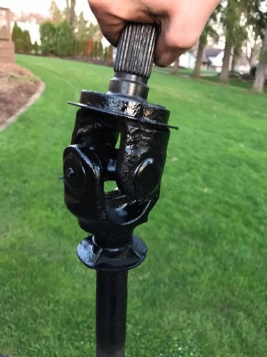

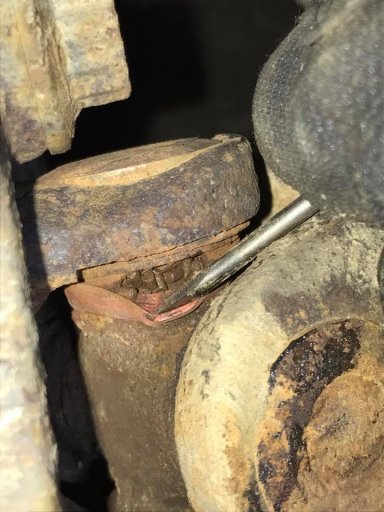

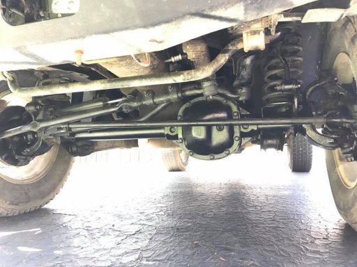

Took the Jeep put to a local off-road park called Southington Off-Road Park and blew a U-Joint while doing a rocky hill climb. It took a minute to find where I had blown the joint but once I found it I knew it had to be replaced sooner than later. Decided to go with the beefiest U-Joints I could find so I ended up with some greasable MOOG joints. I also decided to sand and paint every piece of my front end.
