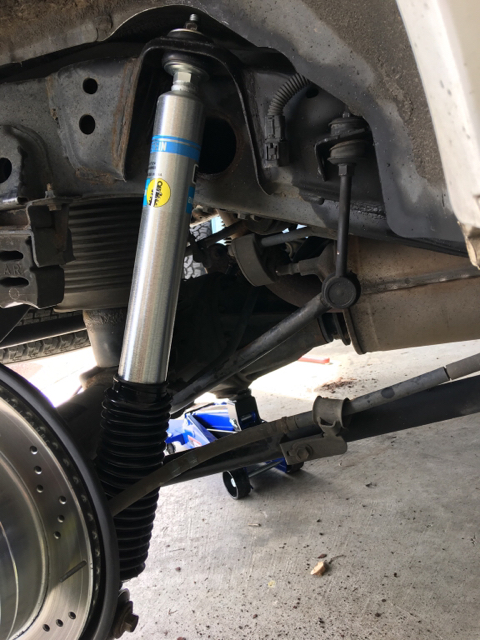

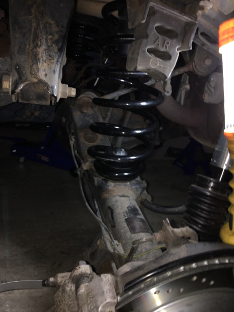

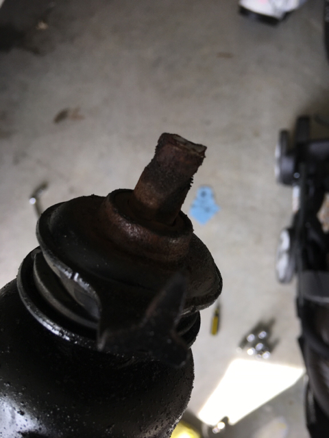

I went about installing the rear shocks today (Bilstein 5100's). The old shocks were a total pita. The passenger side I was able to literally break in half at the stud due to rust. The nut wasn't moving at all.
The driver side just took forever moving the nut one mm at a time. I'd get about one full turn before I needed a break. I refused to go buy a sawzall just for this.
I finally got both off and new shocks installed. The truck already rides so much better. It just feels more together and isn't bouncing all over the place. I have a newborn at home after all so it's one piece at a time. Hopefully I'll get the front struts on tomorrow and then rear shocks on Friday.

Bilstein 5100's front and rear. I can post part numbers later but their for a 07-09 FJ or 4Runner.
112-620 Toytec/Eibach Front springs on bottom perch.
Toytec Superflex rear springs
MetalTech 4x4 Airbag Conversion Kit. They sell one with spring isolators and one without. Get he one without and order isolators on amazon. It's cheaper that way.
Should give me about 1.75 in of lift.

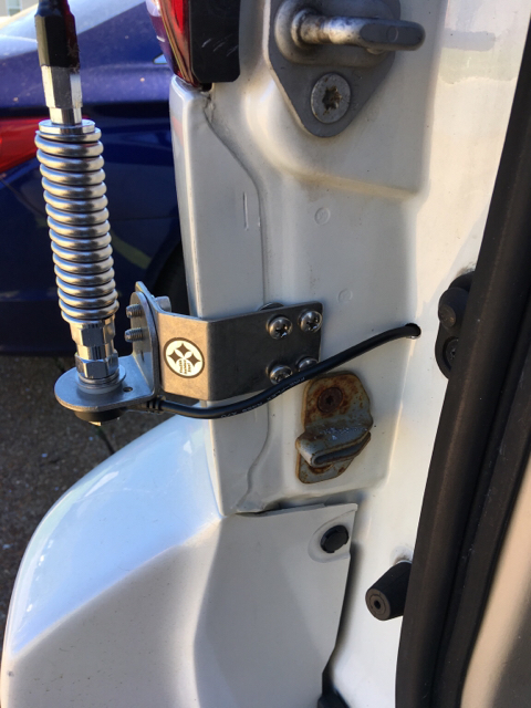

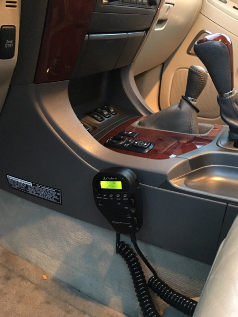

Installed a CB Radio and Antenna. I went with a Cobra 75WXST paired with a Firestik MK-204 Adjustable SS Door Jamb Mount and a 4ft Firestik Black Firefly.
The install was pretty easy although I had to add a few washers to two of the screws on mount due to a little indentured in the body right there.
The control unit for the radio is mounted under the shifter panel and the mic unit is mounted to center console.
All in about $150
MagnoliaOverland
I need/want to do a cb install so bad. How do you like the cobra
Member #4113
I like it so far. I had read a lot of positive reviews other than some needed an external speaker because the handheld speaker isn't loud enough. I haven't had that problem yet but my rig isn't that loud currently. I also like that it can be mounted fairly discreetly.
