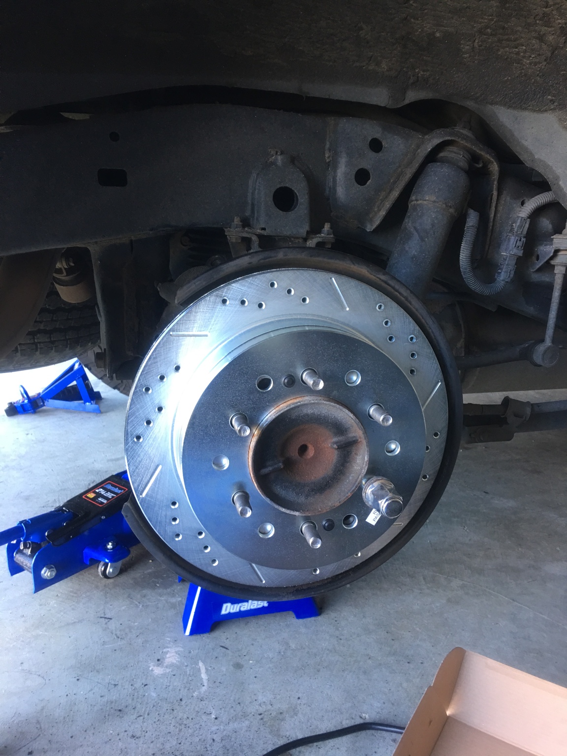

Let me know what you think about these. Need to get brakes for the wife's soom
Sent from my SM-G930T using Tapatalk
Drove around a fair bit yesterday during the "break in" process and I'm pretty impressed thus far. I haven't done the fronts yet but it already seems to be much improved stopping power. No squeaks or noises whatsoever which is surprising considering this was the first time I've ever worked on brakes. I was pretty surprised I didn't screw it up.
Rotors were fairly easy to pop off using two 8mmx1.25 bolts and cranking down on them until it pops. Just remember to release the E brake so you can pull it off.
Few of the caliper retaining bolts were seized on but nothing PB Blaster and some muscle couldn't solve.

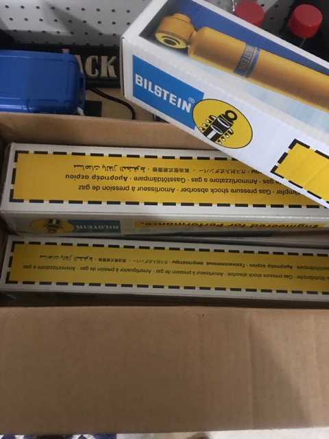

Suspension parts starting to arrive! Bilstein 5100's front and rear. I may go ahead and install the rear shocks tomorrow however I'm still waiting on Front and rear springs along with airbag delete kit.
Anyone know of any reason why I should wait and do it all at once?
Ive got these on the front of my truck and the diffrence is night and day. I havent got onto the rear yet (saving for progressive springs) that being said doing one half first should be fine

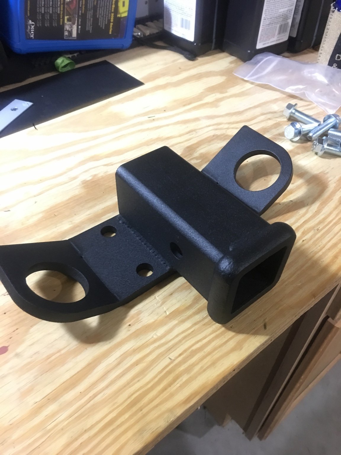

What happens when you believe the interwebs and you find out the hard way that a 33" tire won't actually fit up under your GX?IMG_0131.JPGyou call your Ironworker buddy to make magic happen. I just made this for a friend. It will bolt in place of one of the 3rd row jump seats. It's the last time he will do something on his GX without personally verifying it will work.

What happens when you believe the interwebs and you find out the hard way that a 33" tire won't actually fit up under your GX?View attachment 19115you call your Ironworker buddy to make magic happen. I just made this for a friend. It will bolt in place of one of the 3rd row jump seats. It's the last time he will do something on his GX without personally verifying it will work.
Haha nice! I'm considering the Wilco Off-road Swing out Hitch Carrier for the spare.
