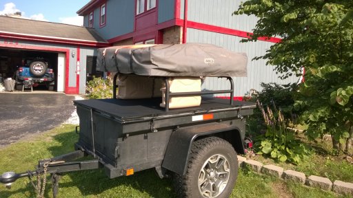

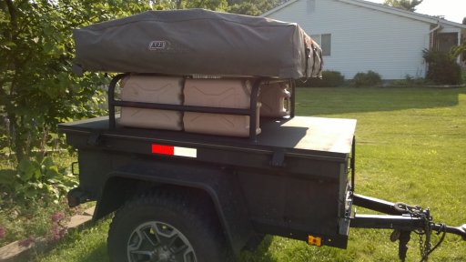

So, this is where I'm sitting... Currently.
The only issue I'm having is the trailer sits well below my JK...
I'm contemplating flipping the axle to underneath the leaf springs and putting a set of 35" tires on there to match the Jeep.
How do all of you feel about that? Pros? Cons?

I rotated my axle on my quad trailer to flip the leafs... worked ok until I bent the axle. Evidently there is a natural curvature to an axle with the curve going up a little bit. When I flipped it around the curve was down and thus weakened the axle in doing so.
Granted, I had the trailer maxed out and was dragging it over big rocks and down rock ledges....
When I got it replaced I got the trailer axle place to make me an axle with the mounts for the leaf springs on the top this time.... and also upgraded the leafs too (but that's a different story, lol).

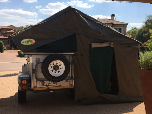

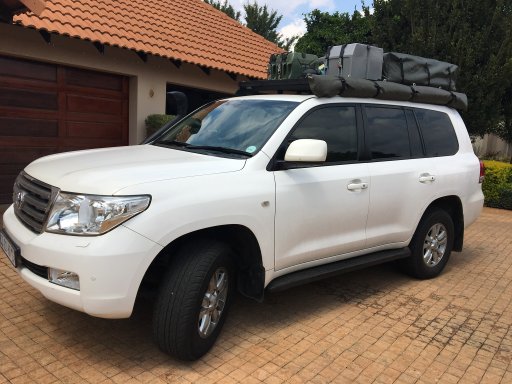

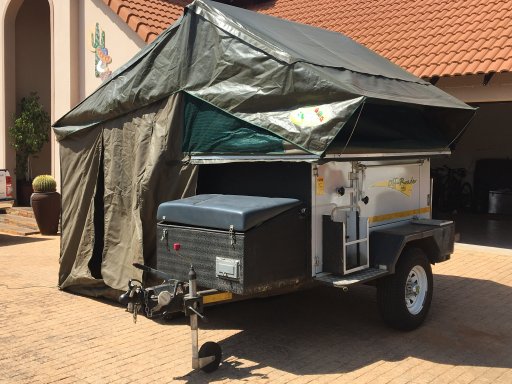

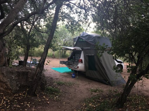

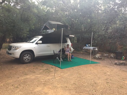

IMG_1376.JPG IMG_1378.JPG IMG_1327.JPG IMG_1319.JPG IMG_1304.JPG Hi all.
Thought I share some picks of our Rig and trailer.Still in the process of refinement!
Here in Africa you can not sleep on the ground, funny creatures roaming the countryside hahaha.
The Rig is self sustained and designed for stay, go, stay go and the dual battery can pull all our equipment for four night.
The trailer is when we want to stay for a week or longer at one place.
In total we can accommodate 6 people, nad carry 150L of water.Full kitchen and two fridge/freezers one in Rig and one in trailer.
Rig still needs bush bumper, winch, rocksliders, Tyre carrier.
I will send some actions picks soon.
Regards Werner.

Impressive setup [emoji106]

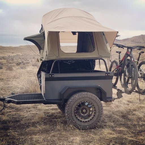

We build an Overland Utility Trailer modeled off of the old M416 military trailers. The tub is made on a CNC press brake to minimize welds and increase strength and rigidity. Using 12ga, powdercoated steel means this will last through a lifetime of abuse on the trail or worksite.
We have 2 more trailers in prototype/testing right now and hope to have them publicly available by next fall. I can do custom 1-off trailers as well.

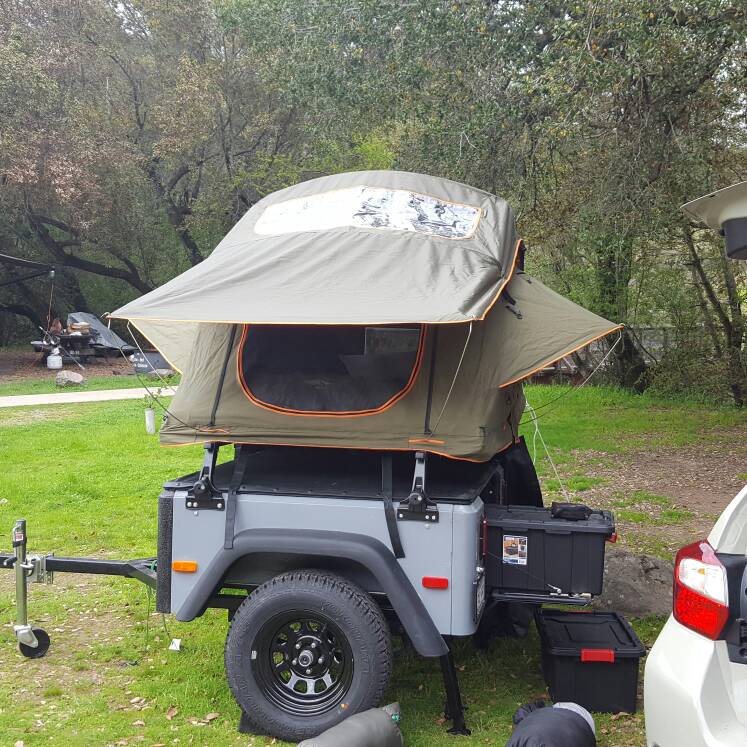

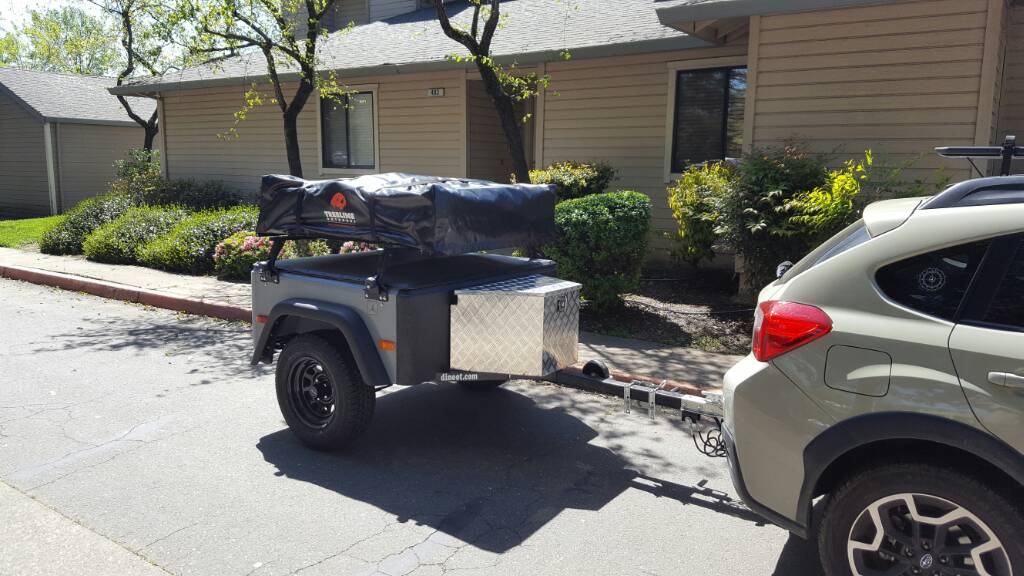

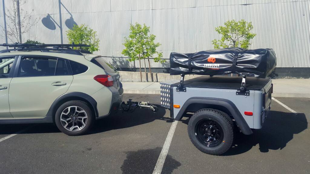

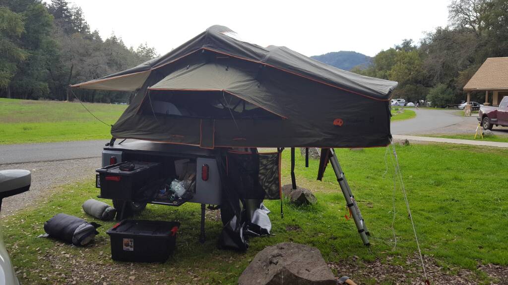

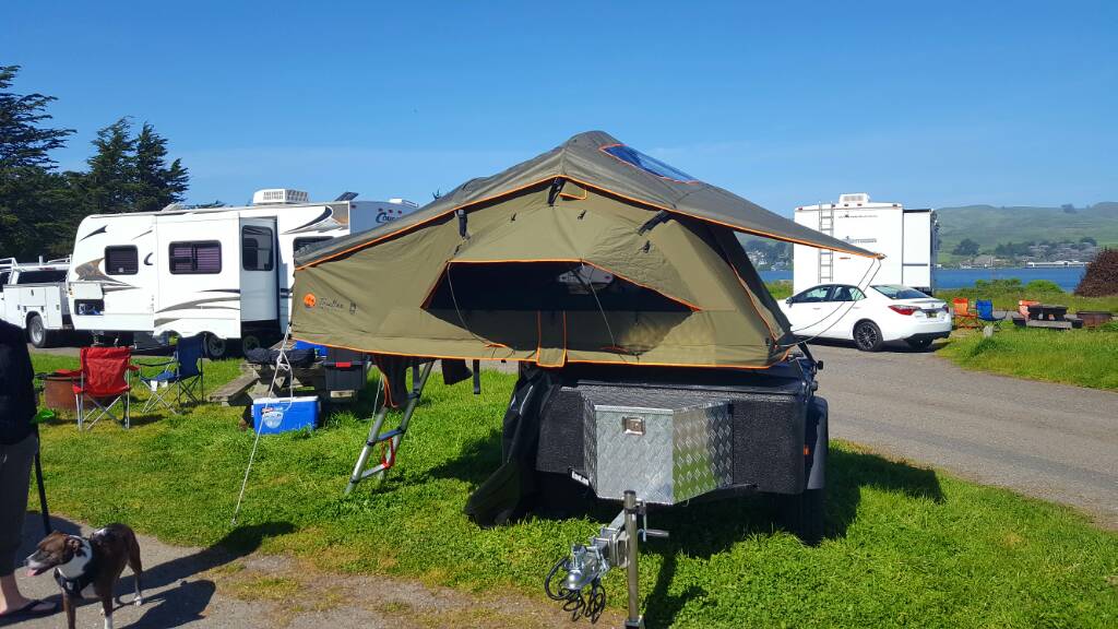

@Charles_Alarie You can't leave us hanging like that! We need details. :grinning:
:) Its a Dinoot trailer I just finished building and a Treeline Tamarack Constellation rtt. This was my 2nd trip out since finishing the build. It was one of the most enjoyable and painless do it yourself projects I have done for sure, the system is very well thought out. I believe it weighs about 485 lbs with the tent and unloaded which is more than light enough to tow behind my crosstrek. Just the tongue box, very handy!
