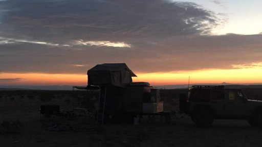

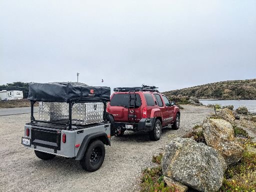

Took the Patriot X1 up to Idyllwild. Towed from San Diego to the summit over a fairly rough road. Pretty good elevation gain over a rough dirt road. Trailer was probably 2500lbs. Got 19.3 miles per gallon the whole way. These little tanks are so awesome.

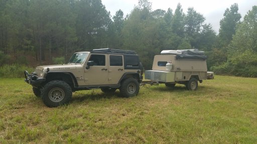

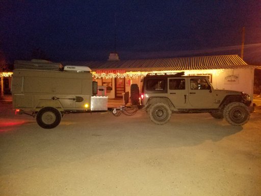

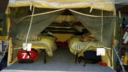

We have been working on our camping trailer for a couple years. It's gone through a couple rebuilds. We started with a standard M101a2 that a friend gave to me. It had the canvas top and we slept on the floor in sleeping bags inside. Phase 1
Phase 2, built benches inside, moved the roof top tent to the trailer and learned how to store more stuff.
Took a trip, learned a lot. Found out wife wasn't too fond of the canvas cover.
Phase 3, A little post about the rebuild on facebook

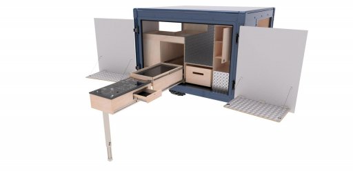

Hard camper top, subfloor, hidden storage, electric slide for camping stove, slide out for stove video
Built on board 32 gallon water tank with Propane heated water source, built alumiunum 25 gallon fuel cell, separate battery system, 63 qt Element ARB fridge on slide, Generac 3000w inverter generator on slide, added CB and handheld radio to keep in touch with Jeep out on trails, and a RV AC/heater unit that feeds the trailer and the RTT. I added stabilizers to the sides of the trailer and a nifty jack and wheel combo for the tongue. The Rhino Rack Batwing added some extra shade too. We have added some lights on the outside to give some assistance when walking around at night, a reverse light and a third brake light for the trailer

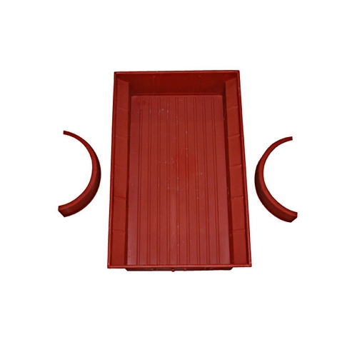

I think this might be your best bet if wanting the old military trailer look. I still don't really know the difference between the two (I've never asked them).
You still need to get a suspension for it (not too expensive), and an axle. Springs are easy to find (I think they originally used WWII Jeep front springs), and you can get them in a stock height, or a lifted height. Getting an axle isn't a bad thing; you can get one to your exact specs (width, bolt pattern, with/without brakes, etc.).

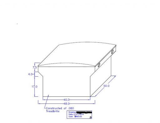

They also sell just the tub:
These tubs measure essentially 40" wide by 72" long.
One thing about these military tubs (repro's or originals) is that they aren't that tall (about 18"). A lot of folks go to great lengths (and expense) to get a lid made for them.

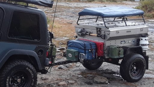

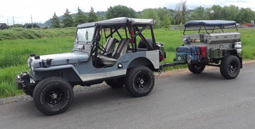

I had my tub made by Diamond Deluxe, and the tub they built me was about 27" tall, with a hinged lockable lid to my specs.. It was made out of aluminum diamond plate. For the frame I used a modified Harbor Freight frame.
Link:
You might get lucky finding an old military trailer reasonably priced and in good shape, but if you find one cheap, a lot of time you're dealing with rust, and you still generally will be swapping out the springs, axle, and rewiring it. Costs will add-up.
Before you go spending a lot of time and money on a trailer, read this thread. It is a long read, but when you're done, you should be able to build your own little trailer for a lot less than it would cost to buy one already made. And it will be made to your specs and needs. Don't think a trailer built off a HF frame isn't tough-enough. Mine has lots of thousands of miles on it, and a lot of that was overlanding.
