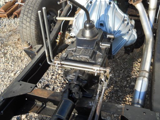

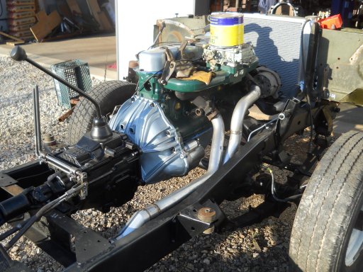

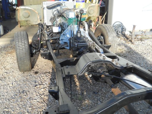

I am reworking a V6 Dauntless now for a CJ-6 build I am doing for my brother. I am anxious to get it running because I'm told they sound like little tractors and for some reason the odd firing order contributes to its sound.
yep, a 90 degree V8 is even firing. A 90 degree V6, not.

Vroom, vroom ...
I used to work on a customer's '62 Buick Skylark with basically the same engine. I don't remember it sounding this good. May be it was because it had a body!

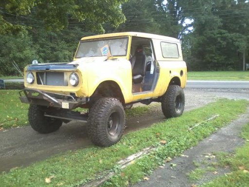

'66 IH Scout on a '70 IH 4x4 frame. GM 350/4spd/transfer case..'71 IH Scout II Dana 44's front and rear. 33x12.5x15 Super Swamper TrXus tires, Stock front disc brakes, rear franken discs, '03 Jeep GC power steering, custom s/s 35 gallon fuel tank, etc, etc.. It will run the fore mentioned Holley Truck Avenger carb until I have it running and the bugs worked out then I'll install a Holley Sniper EFI "carb"..

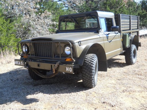

what have you done to it? looks like Chevy axles? 350 motor?
1980 J 20 rear axle ( Same as chevy) custom front Dana 44 with J20 disk brakes also same as chevy. 3.73 gears with twin track in the rear and soon to be in the front, T98 close ratio 4 speed with 11in clutch, 205 twin stick T case, and a 300 Ford six with a Offenhouser 4 barrel, topped witha 390 CFM Holley. P/S, P/B, and under dash A/C with lots of cab insulation. Custom built removable hard top.

That's awesome! Looks super clean. how's the insulation work on the cab? I put a good amount on the floor of mine so hopefully it's a bit quieter.
