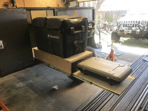

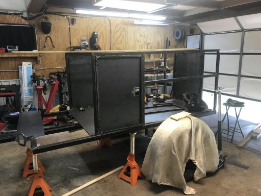

heres a few more pics.
its 4x8 basically, 4x6 box with 2 ft tray on the front. 3500 lb axle, for stronger bearings, with matching hub pattern for jeep, so the wheels and tires will swap over. 2200 lb springs, so the suspension rides smooth. Max coupler on the front, stabilizer jacks front and rear. light enough I can move it around by hand if needed. group 31 deep cycle to run lights and everything. solar to keep it charged, as well as wired to charge when driving. rack on top is same as jeep, so I can transfer things easily. led lights throughout. it was my first build, so I would change a few things next time. everytrip out I'm moving stuff inside, so the inside is a changing work in progress. but so far ive been happy. working on an adjustable mount for my awning, now that I have moved it to the trailer.IMG_0413.JPG IMG_0522.JPG IMG_0530.JPG IMG_1328.jpg IMG_1354.jpg IMG_1363.jpg IMG_1731.jpg IMG_1802.jpg IMG_1804.jpg IMG_1824.jpg
its 4x8 basically, 4x6 box with 2 ft tray on the front. 3500 lb axle, for stronger bearings, with matching hub pattern for jeep, so the wheels and tires will swap over. 2200 lb springs, so the suspension rides smooth. Max coupler on the front, stabilizer jacks front and rear. light enough I can move it around by hand if needed. group 31 deep cycle to run lights and everything. solar to keep it charged, as well as wired to charge when driving. rack on top is same as jeep, so I can transfer things easily. led lights throughout. it was my first build, so I would change a few things next time. everytrip out I'm moving stuff inside, so the inside is a changing work in progress. but so far ive been happy. working on an adjustable mount for my awning, now that I have moved it to the trailer.View attachment 83154 View attachment 83155 View attachment 83156 View attachment 83157 View attachment 83159 View attachment 83161 View attachment 83162 View attachment 83163 View attachment 83164 View attachment 83165
Great job on the trailer looks good.
