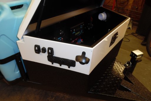

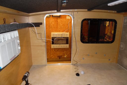

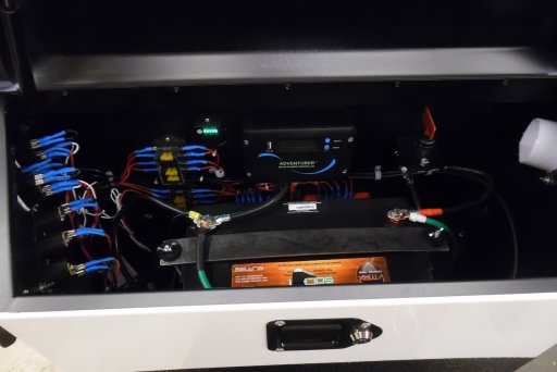

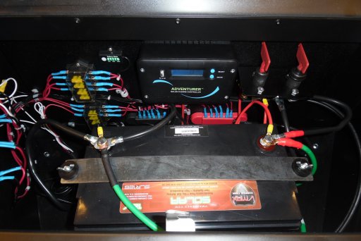

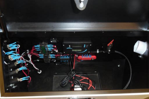

finished 2\3rd's of the electrical. This part of the build is slow & tedious, to make it right plus making it as clean looking as possible. A very simple, reliable safe electrical is what I done on the 1st trailer & I'll follow suit on this one. Finished up on connecting the solar 30amp Charge Controller, positive & negative out going, positive & negative power, battery temperature sensor, & the battery monitor read sensor. Also ran the left outside side exterior LED light wires inside the wood colored wiring chase & ran the inside 12v. socket outlet too.
These wires along with 4 other runs I'm going to run them inside metal conduit underneath the trailer chassis & up inside the tongue box.
I'll order the battery Monday, be the same battery I use in my 1st trailer build VMax Tank AGM 125ah, solar will be the same Renogy. In stead of the NOCO 10amp on-board charger I used in my 1st build, I'm going with a Powermax 55amp power converter charger.

little more work on the electrical. The wiring chase I found & ordered matches the interior wood color. I believe I'll have this rolling down the trail next month.
what is left to do,
1. swing out spare tire mount
2. install 2 awnings
3. run trailer light wiring
4. Sally's nesting "interior bedding, curtains"
5. install 55amp Powermax Converter Charger
6. install battery, battery hold down bracket & run battery cables

Looking good! Regarding your battery/power box, do you plan to vent it? I see the white tube on the driver's side but I think that's for your solar system. Some say a vent is needed and others say no. I'm working on mine now and so far it's "no". We spend time sealing everything to keep water out. I'm sure some vents are better than others but … it's still a hole! lol. I'm using a sealed deep cycle battery so I think I'm OK.
Regarding cables, I just picked up a set of 4g jumper cables for my last trailer. I cut off the ends and crimped on some lugs. It worked well.
i didnt vent my 1st trailer build tongue box & I am doing with this tongue box w\o venting. 2 1\2yrs of use never had any issues. I had a battery temperature sensor wired in the 30 amp charge controller in the 1st trailers tongue box which adjust charge voltage based on actual battery temperature & I installed the same exact battery sensor in this new project. I usually leave the lid open while camping.

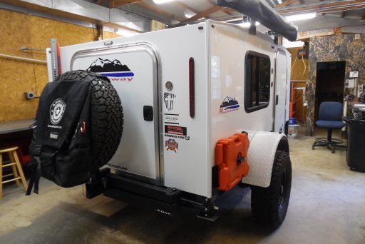

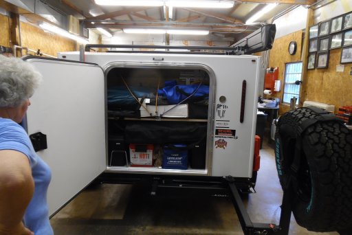

fitting the swing spare tire mount. A little modification to the upright. I have exactly 5" between the rear of the spare tire & the rear storage door. The wife spent part of the day nesting. Added another shut off switch for the solar system, this way I'll have one for the 12v. electrical & the other for solar system. All is left is install the left side awning, run the wiring for the trailer lights & the wife finishes her nesting. All of our camping gear fit's into the rear storage area with room to spare.
