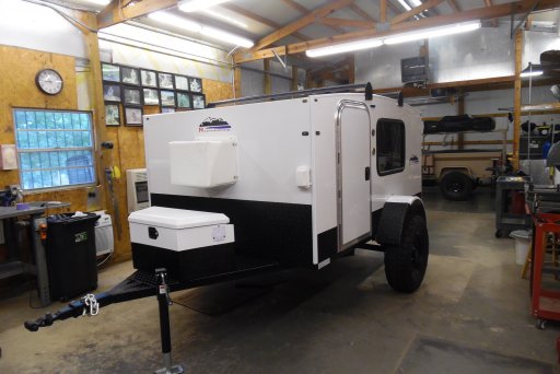

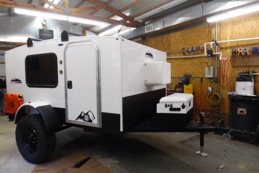

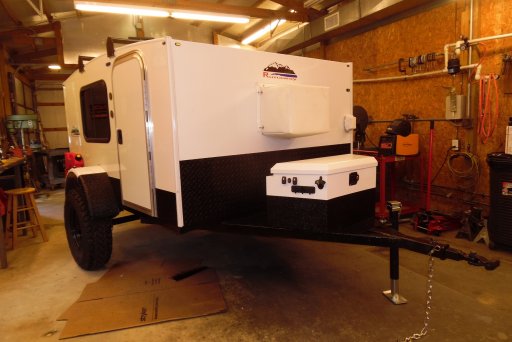

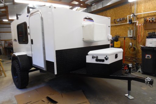

I have to say after owning this trailer new & many times crawling underneath, in & out of the sleeper the construction is solid & the trailer is well made. I feel these are good candidates for offroad conversions with some fabrication required. I went to the extreme with the tongue, in all retrospect I could of removed the original weld on coupler & jack, leaving the A frame of the tongue in place, installed a 2" backbone added a few triangular plates & 2" receiver & be done with. It would of been more than enough. Since this his my last "hurrah" I decided to go with a much more beefier all new tongue w\ 2 1\2" tubing w\ plated deck.
The one thing about Runaway is & I like about them is the owners do not mind what you do with the campers. Matter of fact they encourage their buyer's to customize them to fit their personalities. The interiors can be order with a bare bones zero interior, or you can add on what ever options they offer. I order ours with no interior, a roof rack & a 40"x40" rear door, & no graphics.
They offer cash discounts if you pay with cash or check in full after you order, factory pricing discount if you drive to Florida to pick it up @ their plant when you order it. Another selling feature to "us" was they seem to be the only ones who offer a 6ft. wide sleeper with that wide wheel base foot print. I originally wanted a Hiker, but the turn around time was a year, I liked WeeRoll, & Vintage Trailer Works too, but Runaway sold me on a few of the things they do. Price has nothing to do with it at all , as you can see what I've been doing to this Range Runner. I figure I'll have about 10,000.00 into it when I am finished this includes the cost of the camper. The exterior is just about finished with exception of the (2) AT Overland Scepter Water Can Holders w\ 2 Scepter Water Cans & the (2) Tuff Stuff 4x4 6 1\2ft. x 8 ft. Awnings & their Awning shelter. Then I'll start on the interior, after that then all the electrical, solar system in the tongue box.
IMO you can not go wrong with tried and true reliable solid axle w\leafs. If I wanted a belly dragger then I would of went with axle less suspension with slid plates though out the underneath. I have 23" of ground clearance from the bottom of the chassis to the ground, 14" of axle clearance to the ground, shocks on the trailer, for me, that is plenty for what the wife & I need for our travels. Over-all I am liking how it is coming out.

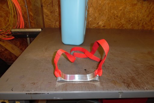

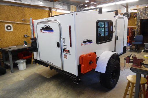

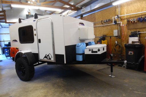

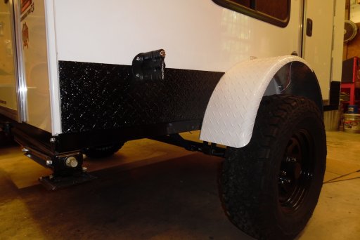

installed the Rotopax Locking Mount today. This will hold 2 gal. Roto Fuel Pack for my generator. I had to make a aluminum spacer for the mount to be flush with the diamond plate & the camper siding.

Runaway offers a one warranty also. I lost my warranty soon as I removed parts, wiring from the trailer & when I cut off the tongue...LOL & fabricated a new one. The warranty doesn't matter to me. The Rugged Ridge Hi Lift Jack Mount & the Rotopax Mount I pumped caulking behind the bolts & installed gaskets behind the mounts. I'm sure they will not leak.
My attitude on this is........if I'm careful & think things through before I do something, it usually goes well when I make the changes. I want the trailer to reflex me & the wife outside as well as the interior. I want this trailer going down the Hwy being different from all the other Runaway Range Runners.
When I start on the interior (next month) I will be adding a dividing wall from the sleeping area & the rear storage so I will have to drill holes through the 3\4" floor out the rubber membrane underneath same as the metal roof to install the aluminum 1 1\2" angle metal. But on the roof I'll caulk inside the hole & once the pan head machine screws, washers & nuts are tight I'll go over them with a self leveling RV lap caulking (Dicor 501LSW Self-Leveling Lap Sealant) the underneath the floor I'll use the Flex Seal Rubber Sealant as well as the caulking inside the holes I drill. The Dicor Lap Sealant is what they use for roof vents & roof seams on RV's. Plus when I store the trailer it will be inside the same shop building it is now, which is out of the weather elements.

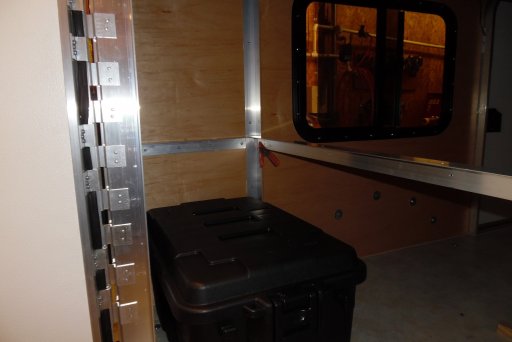

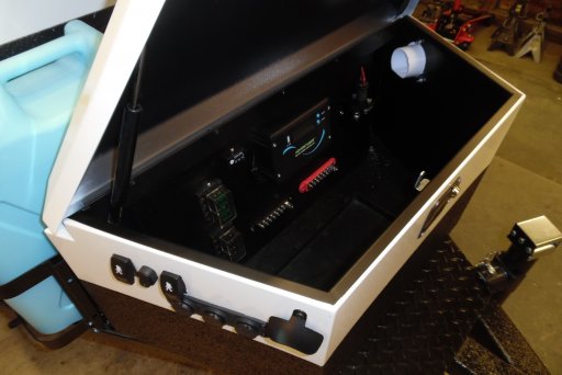

this morning done more work on my project Offroad Camper. The Rotopax 2 gal. Fuel Pack came in today. This fuel pack will hold gas for the 2500w inverter generator.

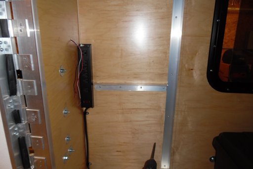

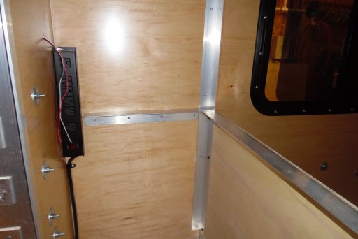

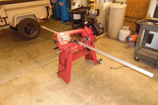

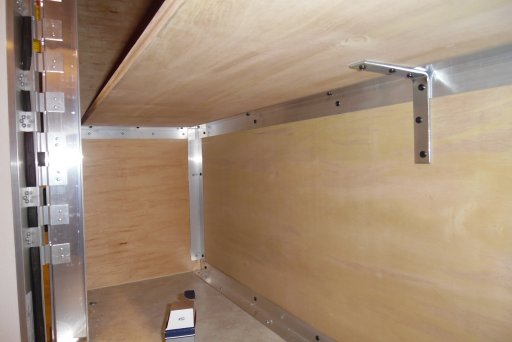

I also started on the interior back wall separating the sleeping quarters from the rear storage area. This will be constructed of aluminum angle metal the sheeted over with 3\4" cabinet grade Birch Plywood. The upper shelf will be a 14" x 70 1\2" shelf constructed of the same plywood & a non slip surface added.

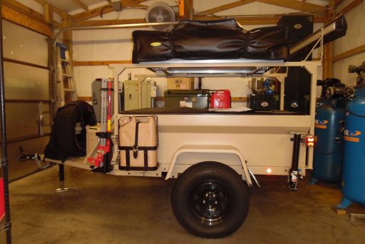

The end of this month I'll list the my other offroad trailer I built up for sale. (last photo) We decided to go with the Williard Tri Fold Queen Mattress.

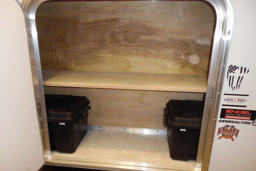

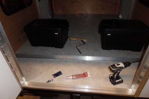

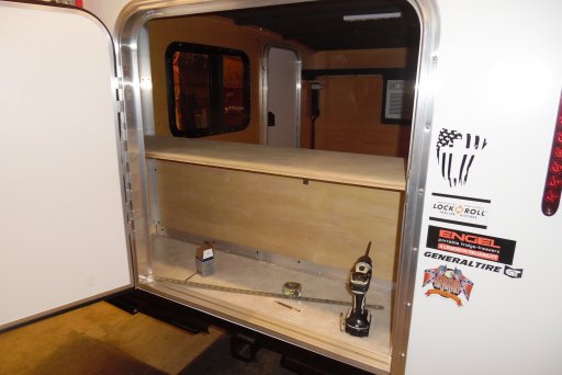

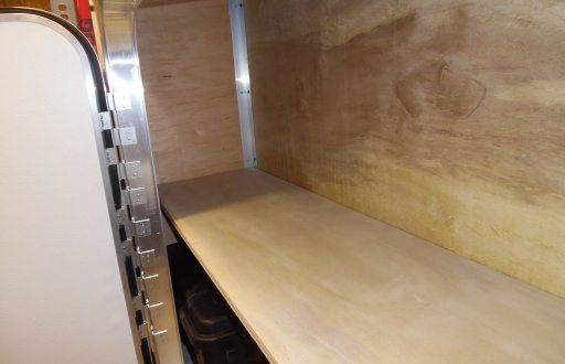

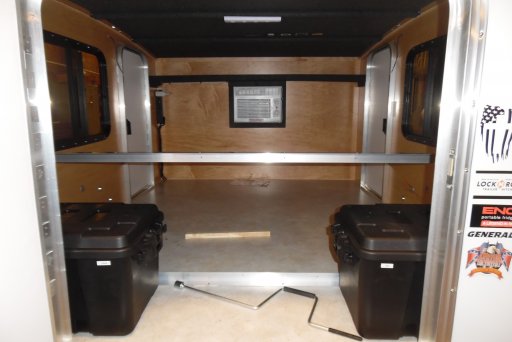

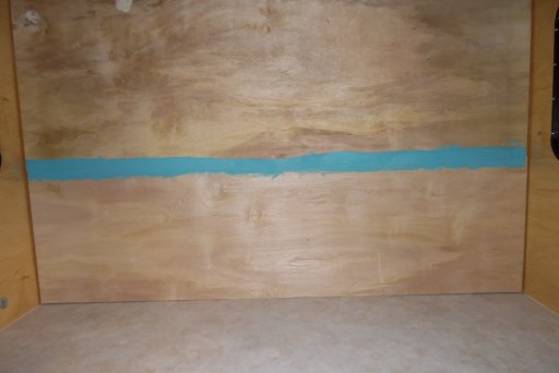

more work done on project Offroad Runaway Range Runner camper. Got the dividing wall & shelf in between the sleeping area & the rear storage finished. Used cabinet grade birch 3\4" plywood, glued & screwed. Filled the joint with fiberglass stran auto body filler.
I'll feather sand the body filler, prime with oil base enamel primer, & Sally & I will wallpaper the wall & trim it out

the sleeping area measurements with the wall up is 70 3\8" W x 76 1\2" L . It will fit a short Queen Tri Fold 4" Milliard Mattress perfectly with 2" to spare.
These measurements work perfectly for the Plano Storage Boxes with a little room to spare.

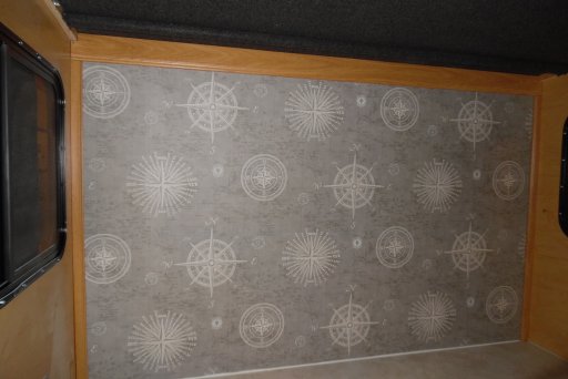

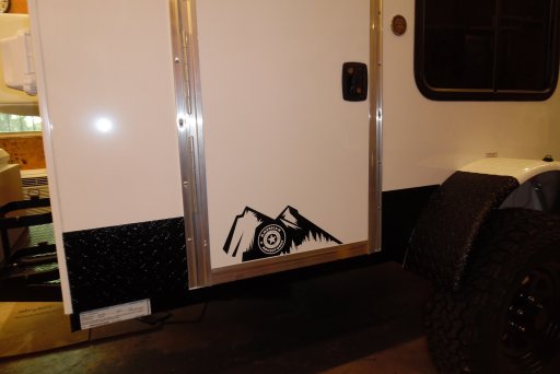

got the doors graphics on this morning, feather sanded the automotive body filler, primed the interior back wall. Within the a few hour will be hanging the wallpaper.
ArkansasDon
just finished the wallpaper on the back wall. I installed the trim pieces & had to tint the cabinet lacquer to match the existing walls.

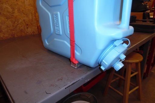

My new 20L Scepter Water Cans came in today as well as the Scepter Water Can holder. I think this will work with the Scepter water spigot. I'm tired & smell like cabinet lacquer, I need a beer, a shower and some supper.
