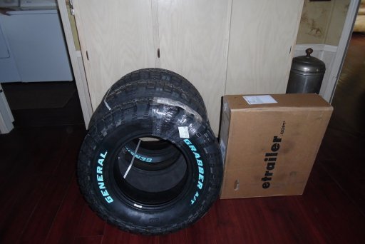

3500lb. Rated Dexter RV Axle w/Easy Lube Hubs (will add weld on shock kit & Dexter Trailer Springs Over-Under Conversion Kit)
Dual Folding Stabilzer Jacks (I'll replace with BAL C-Series Jack 28" w\BAL Foot Pads)
Front Jack with removable wheel
15" White Spoke Wheels & Tires (I'll replace 3 15"x8"x 4.5 on 5 U.S. Wheel 8 Spoke rims (sent off to the powder coater to be Black & Crosswind MT LT 215x75Rx15 tires)

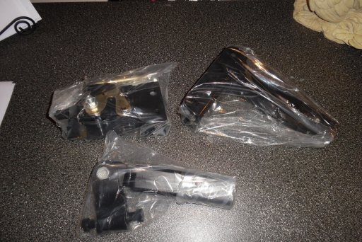

Here's what I order today: adjustable height Lock N Roll coupler from Compact Camping Concepts, round, pipe mount swivel jack w/ footplate weld on side wind 14-7/8" travel 2000lb, 18" 2" weld on receiver hitch tube, 40ft of 2" thick wall tubing, 1\4 sheet 3\8" metal, full 4x8 sheet 1\8" thick metal, 2ft of raw steel hitch shank. This is for the back bone & tongue I'll modify.
Will be posting the actual modification on this project thread. 985E803157D5E657.jpgA7BCB720008305AF.jpgB23BB5499C586349.jpg
thanks, this project will be a quailty. I'll be selling the Dinoot after I finish. The reason will be I know in time our age (60's & late 50's) with current offroad camping trailer one of us will have difficulty climbing up or down the ladder in or out of the roof top tent. This way I'll have a head start & another completed offroad trailer ready so we can continue to dispersed camping.
more parts came in. Yesterday the Lock & Roll Hitch.
Ordered steel Jeep Style Fenders to replace the stock round fenders
I also ordered Triple Heavy Duty 20 A 12 V Plug Lighter Socket Plug Outlet Panel, 2 Rocker Switch Laser Blue ON-OFF 5Pin 20A 12V LED SASQUATCH Light, 3" Power Cord Cable Hatch Camper Round RV Trailer Electric Black for the tongue box. This way I can make all my cuts on the tongue box before I prime, spray the bed liner & paint to match the trailer.
4 days ago I order the following: round, pipe mount swivel jack w/ footplate weld on side wind 14-7/8" travel 2000lb, 18" 2" weld on receiver hitch tube, 40ft of 2" thick wall tubing, 1\4 sheet 3\8" metal, full 4x8 sheet 1\8" thick metal, 2ft of raw steel hitch shank. This is for the back bone & tongue I'll modify

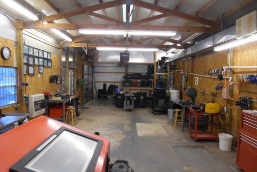

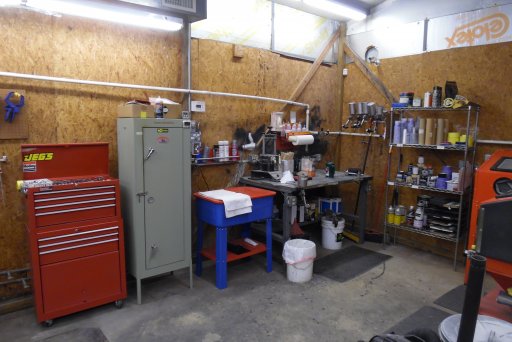

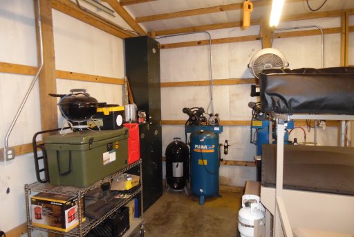

getting more parts in for the new project. I have all the suspension parts in: (leafs, weld-on shock kit, Dexter axle flop kit, tires, tongue box, 1\2 of the electrical the new hitch & coupler Lock n Roll & just ordered the new fenders. The 1st week of April heading to Florida to pick up the Runaway Range Runner. Mean while getting the shop set up for the new project. For the last 2 weeks been giving shop a thorough cleaning & will be finishing the cleaning sometime today.

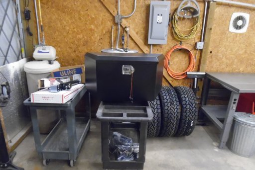

Mocking up the 12v. outdoor light switches & outside 12v. socket receptacles. Cutting out for the switches & receptacles. The electrical & solar will be done the same way I done my last offroad trailer tongue box. (last Photo) I'll be installing one more light switch smaller in size in between the 2 rocker switch which will operate a LED light off the back of the trailer.
I'll be painting the tongue box white to match the existing white of the trailer then I'll spray a 2 stage catalyzed bed liner 10" up from the bottom on 3 sides as a rock guard. Paintwork I'll be priming with PPG DP Epoxy Primer, PPG Single Stage Base Paint (white) & PPG Concept Clear Gloss. The colors will be white & black only on this project. I'll be using buglehead machine screws which I'll media blast & moly coat satin black (heads).

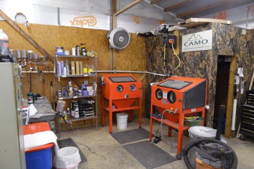

more work on my project offroad Runaway Range Runner Camper tongue box. Used a 3" hole saw for the solar panel cable port. Disassembled the latch mechanizm from the tongue box & removed the lock & replacing with a 2 way security lock. I media blasted the latch, machine screws for the 12v. outlet sockets, bottle opener & solar port & coated with KG Gun Kote Satin Black. This coating is a baked on finish & is extremely durable. I'll bake this finish on for 2 hours @ 285 degrees.

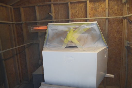

this morning I sprayed the PPG DP Epoxy Primer on the tongue box. 1 hr later I started putting on the base coat white on the tongue box (3 coats).
My down draft variable speed fan switch stopped working on the 2nd coat of primer. I guess after 16 yrs something has to go, most likely the contacts in the switch. LOL
Tomorrow I put on the gloss clear, 3 coats. After everything is dry, I'll mask off the tongue box & 8" off the bottom on 3 sides (front, both sides) I'll be spraying on a 2 stage catalyzed truck bed liner on leaving straight black. This will be used as a rock guard. I'll do the same on the Runaway Range Runner Trailer too on the front, & sides & chassis sides.
finished my tongue box (the outside) for the project Offroad Runaway Range Runner Camping Trailer.

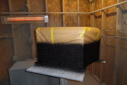

This morning I got my paint booth up to temperature 75 degrees, the clear I applied last night was dry enough for the next step of the finish, the truck bedliner.
I scuffed the finish 8" from the bottom up & masked the the upper half, shot on a black epoxy automotive primer, 1 hour late I was spraying the truck bedliner on. I adjusted the air pressure for a medium texture.
When dry enough I installed the solar cable port (left side), the 3 12v. outlet sockets, the 3 12v. light switches & the bottle opener (right side), pop riveted the latch back on. I have to say it looks great.
