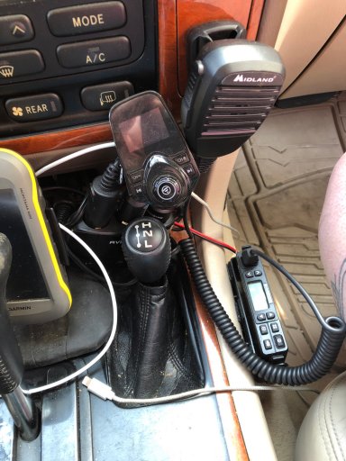

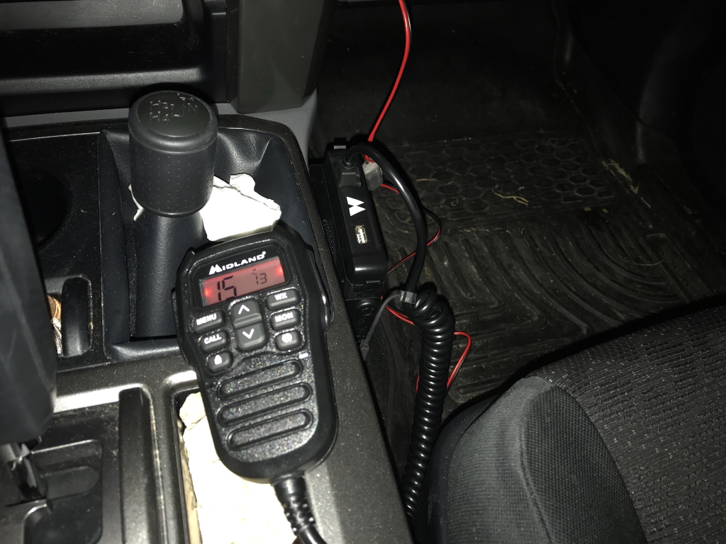

Mine came in Wednesday and I installed it in the 4Runner yesterday. MUCH smaller than the MXT400 I've got in my Tundra. For now its mounted on the passenger side of the center tunnel so I can plug it into the 12v in the glove box. The plan is to ultimately mount the receiver under one of the front seats or in the glove box. The handset cable is plenty long enough for both locations. Aesthetically, it blends in fairly well if you're looking for low profile mounting and the control head is easy to use.
As far as range goes, I haven't really tested it yet. Unfortunately, no one around here (that I'm aware of, anyway) uses GMRS except the occasional kid on a handheld and the nearest repeater is over 50 miles away, so.... I'll be taking a drive next week when I'm off again and test the range with the better half sitting in the Tundra at the house. I suspect that the 1/4 wave antenna that it came with will eventually be replaced by a 5/8 6db gain like I'm using in the Tundra, but I'll report the results (and pics) of the kit as it stands now asap so there can be at least one point of reference. I live in the "burbs", so only trees and houses to block a signal. I've basically got GMRS for trail and camp use with the extra handhelds I've had for years, so if I can get 5 miles out of it, I'll be happy.

Kinda pic heavy at the end, but here goes...

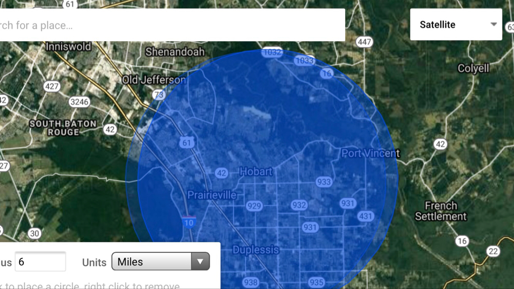

Ok. I did a quick range test on the MXT275 this evening. The better half sat in my Tundra in the driveway at the house on the MXT400 and I took the 4Runner out on a little end of rush hour drive. Generally flat terrain (South Louisiana) and a suburban area with mostly subdivisions and lots of trees.
The max range I got with the included 1/4 wave antenna was just under 6 miles on high power (channel 15) in simplex mode. Unfortunately, the nearest listed repeater is about 50 miles away, so I can’t test anything in that regard. I’ve attached a screenshot with an overlay to give a better perspective of the radius and the signal obstructions along with pics of the setups in both the 4R and the Tundra.

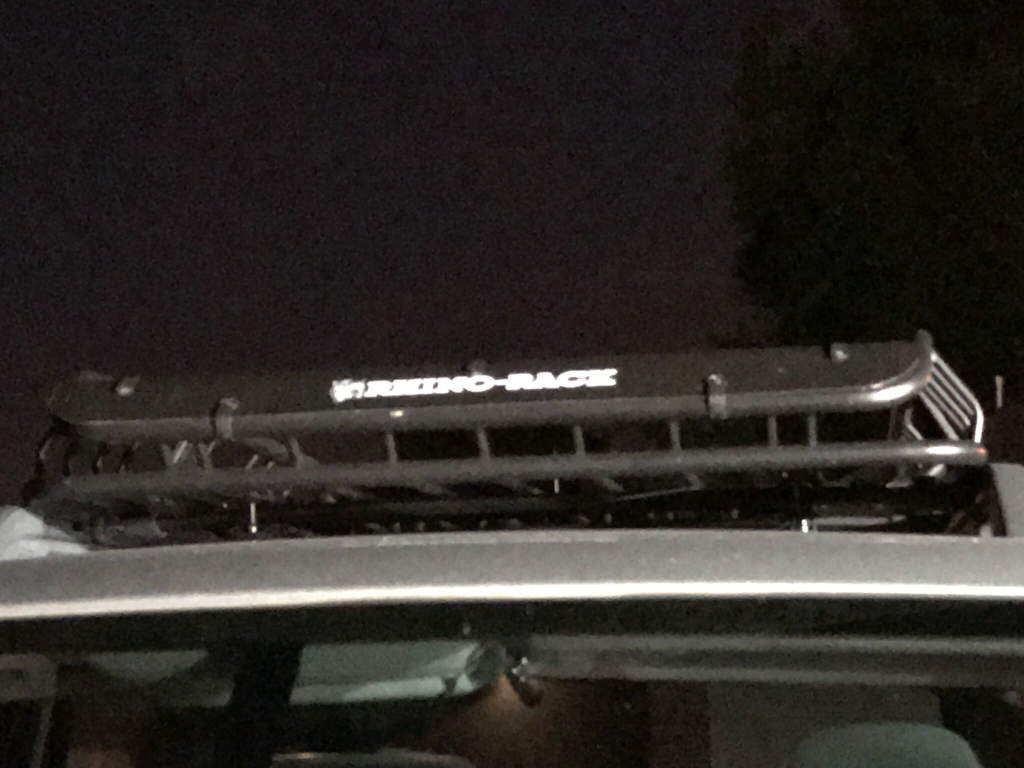

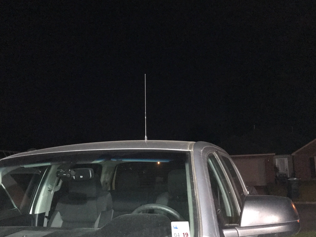

I’ll definitely be replacing the 1/4 wave with a 5/8 wave eventually, but for trail running with a group, I think I’ll be pretty happy with it as is. One issue might be the fact that the antenna, as it sits, is blocked by the roof basket, but not really sure on that yet.

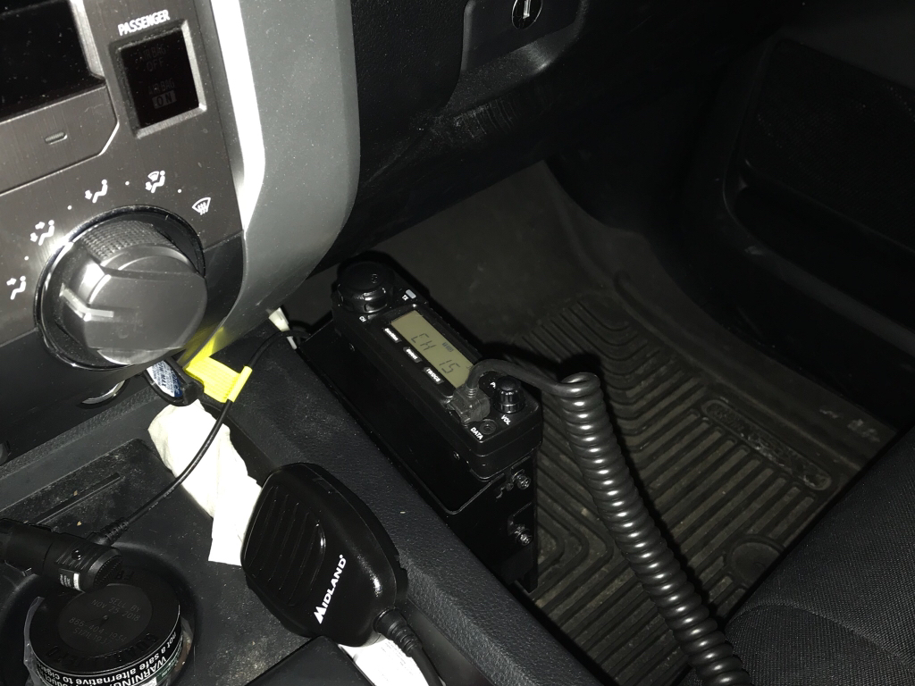

And the setup in the Tundra with the 400

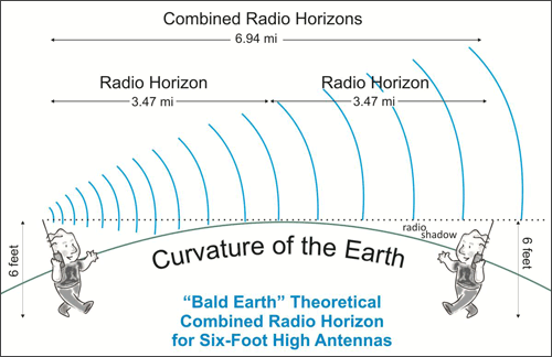

That really is about the best you can expect for relatively flat terrain with little to no obstructions on any line-of-sight band due to the curvature of the earth itself becoming an obstruction. Good read here, if you're interested: http://www.hamradioschool.com/?p=1184
