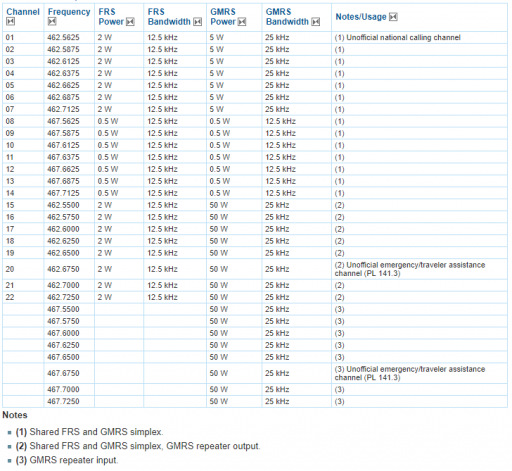

I would like to preface this question with the statement that I literally know nothing about radios other than the normal CB stuff. I would like to be a Ham Operator in the near future but the appearance of overwhelming complexity has thus far kept me from it. However I would like to communicate clear and effectively while on the trail, so I am outfitting my truck with radio(s) in the next few months. I have already paid for and received my GMRS license. So here is my first question here; I understand if I buy a true HAM radio and have the MARS modification done to it then I can transmit and receive on GMRS frequencies. Is this true? Is this legal? Is this practical? I would like to get the most bang for my buck and like all have stated here, dash real-estate is at a premium. I'll leave it here for now but have many additional questions.......

Can you? Yes.... Legal? No Don't go blasting 50 watts on the 5 watt or 0.5 watt GMRS frequencies and nobody is likely to notice.
If the GMRS frequencies are 5 watt or 0.5 watt then how can Midland sell GMRS radios that are 40 watts? I'm confused....

Copy, I understand what you were talking about now. Do you have to adjust the TX wattage down when talking on the lower channels or does the radio already know and adjust for you? Or is this radio restricted to just channels 15 thru 22?

The MXT-275 like their other GMRS radios and works on channels 1-7 and 15-22. The power is programmed to adjust according to the channel you select.
Then a Ham Radio with the MARS modification, can you also program the correct wattage for the appropriate channel?
Executive Director
the FCC says no, only GMRS radios can be used with GMRS channels. That being said you know whats in my ham radio ;-)
