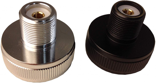

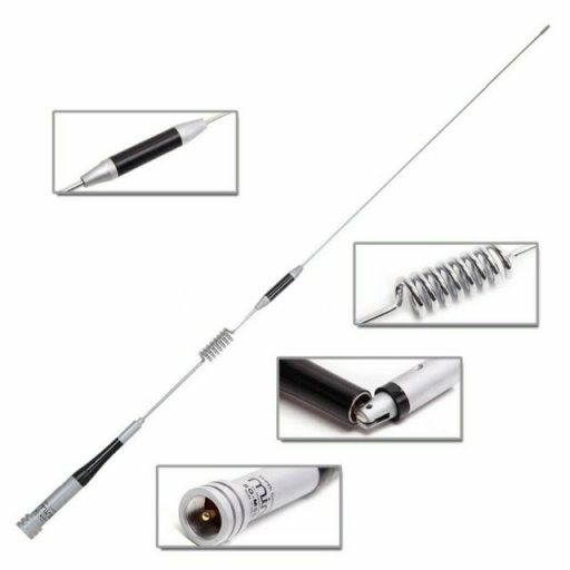

This antenna looks a lot like a more expensive version. Similar to what 'DanW' used, but not in black:screamcat:. Made in Japan, and with a NMO adapter base added, it might be a idea. 1570686986770.png
Price is right also............
70W Gain Car Mobile Radio Antenna Dual Band UHF/VHF 144/430MHz SG-M507 Antenna
$10.99
Antenna TW-NMO to UHF Female (SO-239) Mobile Antenna Adaptor (2 Packs) One is White Adaptor Connector Another one is Black Color $16.99
Antenna on E-Bay
Adapters on Amazon
NOTE: The base on the antenna says...."made in Japan",.....but it ships from China,.....go figure.
