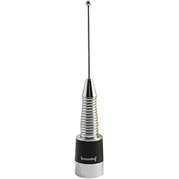

Here is one that seems like the best GMRS antenna for the roofs:
Browning Model BR-176-S
450-470Mhz
3db gain
5/8 Wave
Heavy duty stainless steel spring
provided cutting chart to fine tune to frequency 9 1/16"
The other question is, will this also pick up the NOAA weather channels, if the antenna is tuned to this frequency?

One of the reasons I liked 1/4 wave antennas so much is they are very broad banded. If you have the correct length they are pretty much guaranteed to have a good SWR match. If you are tuning, remember to tune for about 465.500 Mhz to be in the middle of the GMRS band. That should work out to be 6 1/4“ in length and you will have a good match above and below those frequencies. When you start using other antennas, like a 5/8 wave its gets a little more complicated but not much. As long as you are using an antenna designed for the 450-470 band you should be fine.
That BR176 is a pretty good antenna. It’s a copy of a Larson antenna from years ago that I don’t think is even made anymore but works very well.

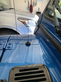

I run a black anodized 1/4 right on the cowling of the Jeep. It practically disappears and never hits anything. The body of the Jeep acts as the other half of the antenna and it works way better than you might think. I only run 5 watts out of a Motorola XTS5000, so not a lot of power. But I talk on simplex to my ham friends for 5-7 miles depending on the terrain.
Yes. Recieve is much less sensitive to antenna tuning than transmitting and those NOAA stations are transmitting from.high antenna locations with a 1000 watts.
