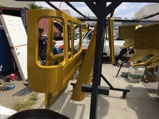

A man got to know his limitations... :) It takes hours of practice to get the finish perfect. I gave up on the paint.
I have a good friend, that I lent him money to start a professional paint shop (liquid & powder) 20 years ago. His shop is 12 miles away, and it really makes a difference. I just pick the color from the chart and two days later I pick the parts up all wrapped. It's heaven!!!

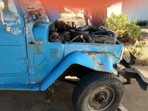

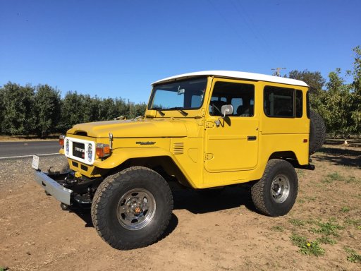

This is how one of the projects started... and ended.
View attachment 129794View attachment 129795View attachment 129796
Simply said, that's amazing. You did goooood !
Hahaha. Not me. Team work!!! My friend did all the paint/powder work. And helped me with the fork lift to put the engine in on the last job. The second album, my daughter did most of the work (code name Kermit).
Here is a link to the albums if you are interested...
