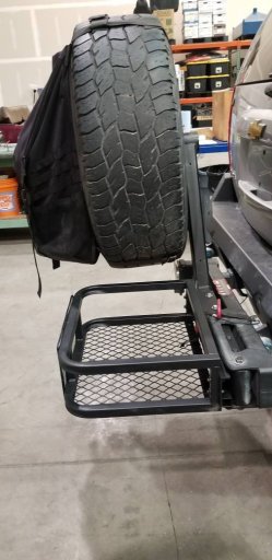

My latest addition is for hauling extra fuel or water without sticking it on my roof. I had a receiver mounted carrying rack it was laying around doing nothing so I took it apart and cut part of it away. Welded up some mounting brackets and reinforced it as needed. I wanted a rack that would hold a 7 gallon Aquatainer or Jumbotainer by Reliance or a jerry can so I measured them all and came up with a rack size to hold two of almost any combination of those containers. This rack is mounted behind my flip down cooking table and it will be handy to have water there.
This photo is a mock up to see how it looks. I have since finished it but, I am letting paint dry over the weekend before mounting it to the Wilco swing out tire carrier.

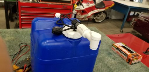

To make life even easier I decided to mount a submersible water pump in my water aquatainer that dispenses over table. It has a plug in behind the tire to will supply power for the pump and a light for cooking. I think the cost of pump and related parts is under $40.00 and may have taken 20 minutes to make. As you can see it puts out 2 gallons a minute I may need to add some restriction to slow the flow down...

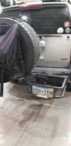

Here is the completed unit. I ran all the wiring for the tag light through the tubing and will be running the wires through the swing out for other electrical needs later.

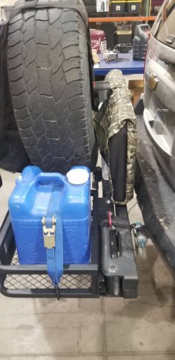

We needed more room so, I added the table to the left and you can also see where the water jug is mounted. It has an electric pump so you can dispense water with it sitting right there. The left side table is stored inside the rig and is held in place by a threaded knob. The right side table slides back under the stove then the platform the stove is on folds up.
This is all mounted to my Wilco swing out tire rack. You can see my storage rack in the back ground in the lifted position and how I store some things under it.
This is my water jug to control the flow better I put the original spigot back on. This has a water resistant switch and the wiring goes through the cap to a submersible 2 gpm water pump in the tank. I use water proof Deutsch plugs for all my connections so it is easy to plug multiple things into the same connector..

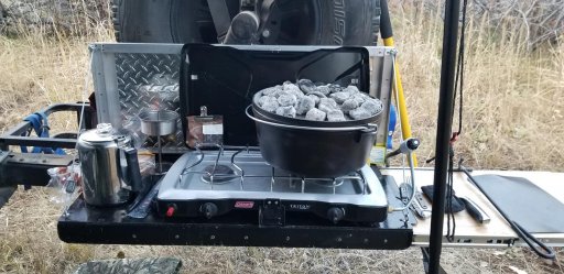

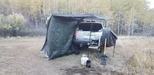

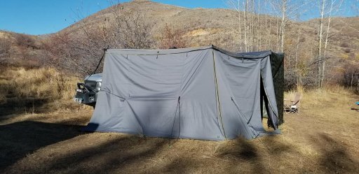

Went on a hunting trip with a friend in North East Nevada weather was pretty cold teens at night and maybe 50s during the days. I was hoping to camp from Thursday evening to Monday morning... But ended up coming back a couple days earlier since our hunting tag was filled before I even set up camp. Darn for the good luck... lol
The Tahoe hides real well behind the 270 awning with the side installed...
I made a makeshift side for the back of it so our fire pit wouldn't have to work as hard keeping us warm in 10 to 15 degree nights. I made a drop cover for the hood area and a skirt for between the wheels this kept a lot of cold air out. Having a fire pit inside the awning tent helped preheat inside the truck before going to bed. Inside was around 40 to 50 degrees when sleeping.
Cooking was still outside it was so cold the charcoal would not burn very well so, the gas stove assisted in cooking our pot roast. I did not test the water rack left of the stove since water was freezing pretty fast outside. The electric pump worked very well with the water jug up front on the floorboard. The new table cover worked great at keeping all the dirt out too.
