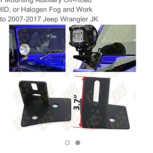

I have some Vision X Light Cannons on my A Pillars. Honestly, haven't had a real need to use them but I would like a nice set of spots on my bumper. Those paired with the Truck Lite LED's would be plenty bright. One problem that I have noticed with A-Piller mounts is that they will rust and that rust could potentially make its way to the paint. I have already painted my EVO A Piller mounts once and I am going to have to do it again.
That's disappointing. EVO usually makes such high quality stuff. I was planning on getting those A pillar mounts with some Rigid side shooters.
You are telling me. It was my first Evo Product and my very first mod to the Jeep. Granted, I have had them for about 2 years but still, the powder coat is chipping really bad. Might actually repaint them this weekend.

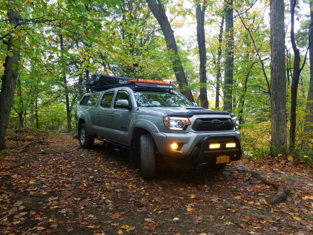

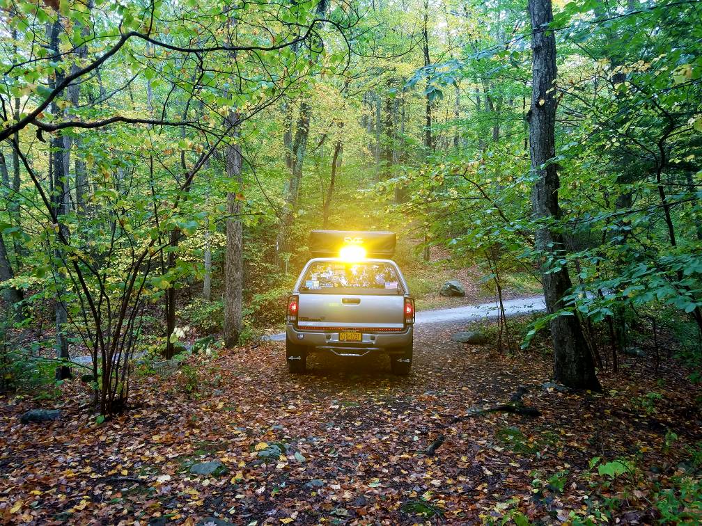

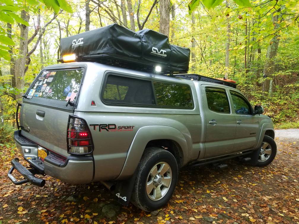

Love all the pics up here gave me tons of ideas n concepts to try n i just finished up my lighting job, let me know what yall think. I wanted adequate lighting forward for dark trails and 360 lighting for cap and RTT tent and all around jobs where light is hard to come by.
