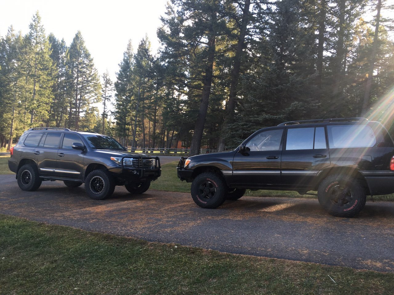

Browning
4929
Hey guys,
I just bought a 1998 Toyota Land Cruiser 100 and I have been researching how to build it properly for long road trips throughout Western US, Canada, and Baja Mex. From your experience with your own RIGS...any advice regarding important upgrades (tires, suspension, roof racks, lights, body armor) that you have used and regard them as "vital" on trips?
My truck is currently stock throughout.
Thanks guys, I appreciate your feedback!
The front diff in the 98 are prone to breaking
Extra fuel cans are a must as well ,if you plan getting of the trail and deep .My 100 series was a thirsty piggy . We put over 100k and had no problems minus the front diff lol. The Arb bumper is a solid choice, along with there a side protection and sliders. Emu lift is another great choice just try figure out what the vehicle end weight will be for spring selection at the end of your build .

looks clean! Ya fuel cans is going to be a helpful addition to any expedition I take. Did you keep the stock suspension or upgrade? Thanks
