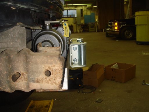

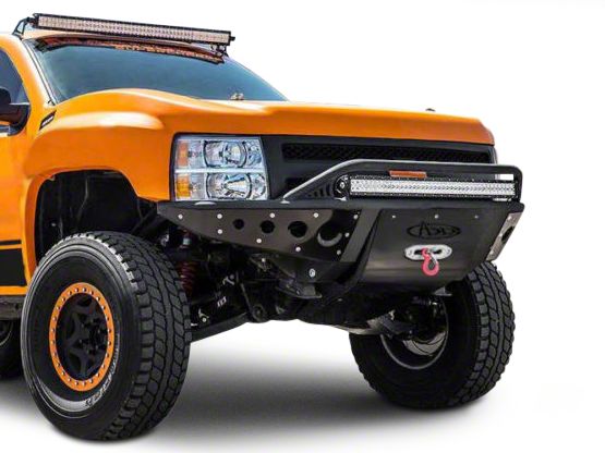

Hey @rho have you come across any stealth or low profile winch bumpers for the 2007+ Silverado? All I'm finding are the I wish I had a bigger manhood monster bumpers. lol
I haven't. the barricade one looks good, but I suspect that you might be able to wedge a winch plate behind it, attached to the frame.
Our '03 is going to be getting something custom down the road.

I am currently out of town working, but I get home on the 31st of january. Can I give you the measurements then? From where exactly would you like them to and from?
What was the solution you were thinking of? I am not looking to keep my stock OEM bumper just so you know. Just trying to find a bumper that looks good and isnt one of those big beefy ones that supports winching and recoveries. Thank you in advance for all of the help.
Well, What I am thinking is tucking a piece of 8” c- channel between the frame rails and the bumper, like I am going to do on my Bronco... makes a neat clean install. There will be a post on this later this spring.
That's what I have kind of been thinking, is mounting a winch plate behind the barricade or n-fab bumper or something, and then cutting a hole on the bumper plate (obviously not on a structural frame of the bumper) for the cable to come through and either mount some kind of rounded plate or bend in where I cut so the rope can rub against it if winching, for whatever reason, from a crazy angle. I am just worried about ripping the bumper off if the rope is pulling on the bumper a bit and also if I can hook up straps to the bumper to either pull people out or get pulled. Kind of a necessity as well.

Yep! A winch plate will often have a fairlead mount built in as well, vs C channel which won't
Ohhh ok, gotcha. Sorry, don’t know tons about winches. But yeah, I’m kind of thinking of either buying the barricade bumper or something. And mounting a winch plate behind it and just cutting a hole on one of the steel plates (depending on what bumper I get) that isn’t structural and just putting a fair lead on the winch plate obviously, and also a bigger piece of metal on the hole that I cut on the bumper to also act as a fair lead in case the rope is at an angle that runs against it so that it doesn’t cut. What do you think?
Or try and find a frantic action shop willing to make a custom bumper for me that could do everything I want and also custom make rock slides, rear bumper, bed rack for rooftop tent, roof rack and other accessories
My custom bumper on my Ram cost a pretty penny. And I bought the steel for $400.00 myself using my bulk discount at the steel supply store, labor was heavily discounted to $20.00/hour shop rate, so I was into the bumper a total of $1800.00 mounted on my truck. Now with that being said, going custom 1 off has its advantages. You get exactly what you want/need with minimal trade offs.
Yeah, I figured that it would be expensive, but definitely worth the money, in my opinion, if the shop does a good job
Yes if the shop does a good job, and most of not all fabrication welding shops do an excellent job, because it’s their rep on the line every time they strike an arc.

Here are some bumpers that I have been looking at:
A rear bumper would be added onto the truck in the future which I am not too worried about.
