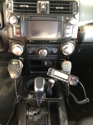

For me, its Ham installed, backed up wiht CB and GMRS handhelds for interoperability purposes.
Some thoughts on radios for overlanding....
CB: low power, sometimes crowded, although the throngs seem to be fading....
GMRS: Much higher power, relatively new, not in widespread use yet...
2M: distance limited, but useful, higher power...
UHF 70cm: Also distance limited, but higher power
All the ham bands can be used through repeaters to get out, depending on where you go.
Handhelds and CB can be very useful within the group/convoy/camo/expedition. Probably a good idea if at least one truck in the group has a ham setup to reach out over long distances, in case assistance needs to be called in.
Based on the previous thought, handhelds are very useful for the local area comms within the group. For that use, does brand or band really matter?
You can get a good CB at Walmart for about $35, so that pretty much takes care of itself for its usefulness. Who needs more? Again, handhelds can also be useful for intra-convoy use.
An ideal setup for those into the coms might be a mobile dual band ham setup (about $150, give or take, as a minimum), a handheld CB and some handheld dual bands to hand out in the group to people without radios. I guess a GMRS would also be useful in that context, whther mobile or handheld.
For everything except the CB listed here, licensing is a factor. There are threads on here on how to get licensed. In my thread "Getting Licensed" I gave out a link for ham band study guide (it gives all the basics including theory - enough to make the license understandable) and flash cards/practice test. It will get someone going nicely.

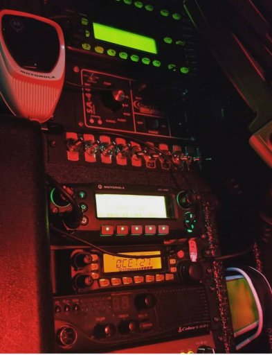

I'm a bit of an equipment nerd, so I have multiple. With the caveat this is used for fire service and storm chasing so a lot of this is multi-use.
110 Watt UHF
110 Watt VHF
800MHz P25
Dual band VHF/UHF HAM
CB
Scanner
You can do a lot with a nice little dual band HAM and a quality external antenna. If you can swing a mobile dual band, that's ideal I'd say. Just depends what your intentions are when you arrive at a destination, I personally carry my portable on a hike. With a vehicle adapter, antenna and remote mic you can turn a portable into a low power 5 watt mobile that'll kick the pants off a CB any day. Screenshot_20181125-123030_Instagram.jpeg
