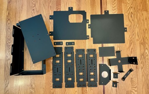

And powdercoated:
We'll install most of them over the weekend, then the door and the heater will be DONE. ;-)
And a massive shout-out to our local powdercoater JIP Finishing!
They turned this around in 24h with amazing quality at a very reasonable price. If you are in the SF Bay Area and need something powdercoated, give them a call:
JIP Finishing
I have no relation to them other than being a very happy customer!

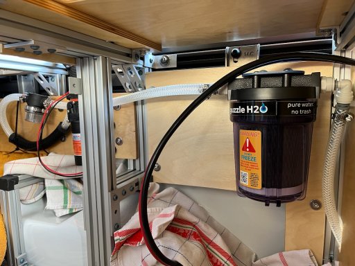

So, it's all back in.
Water pump and filter (towel since we were testing for leaks):
UV water treatment:
Electrical subpanel for pump, travel oven, heater:
Overview:
The backrest has storage space for two Frontrunner chairs:
It's a bit of a "hardware overload" in there, mainly because we don't have the skills and workshop to build a nice wood only box there. But okay, it is what it is.
