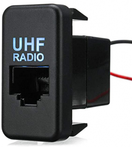

One thing I like about the MXT275 is the remote Mic. I am working out mounting the body inside the dash and using a remote rj45 port in my dash for a very clean install.
Where did you get that RJ-45 connector? And do the make one labeled VHF and HF?
I'd like to see some pic's of that install if you can please.
My new rod was supposed to be in yesterday. I checked the tracking and it said it was delivered to the Post office, then it said the package was dispatched to the sender. So I'm waiting for the PO to open this morning to find out what is going on.
I am 3d printing a faceplate to mount everything in the lower cubby in my Subaru. Once I have it all installed I wll post pics. It wont be anytime soon. I have the design done, but my access to my 3d printer has been cut off for the time being... so I need a new machine.
