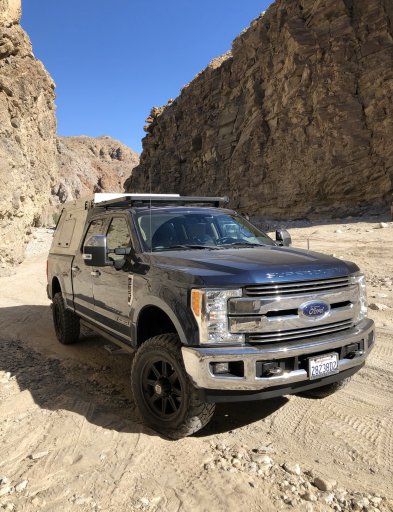

I have a ‘17 F350 with a Frontrunner rack. I drove to the Frontrunner shop north of LA for install. They had to remove my headliner and drill into the roof. No problems so far. View attachment 125304

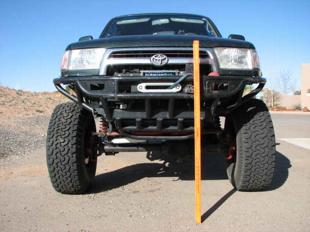

When I had my '99 4Runner, I made my own sliders and welded the sliders to the frame, using large diamond patterns on the frame to spread the load. The whole setup worked incredibly well, and using a hi-lift on the slider was a non-issue. With the Silverdo, I do realize there is more weight, so Instead of welding, I'm considering making very large sleeves in the shape of a U, that will slide over the from from the bottom, and then a bolt from through the frame and each u-sleeve. The extending arms that will be welded to the sliders will be gusseted against the u-sleeve to provide more strength. This entire setup would provide a twisting motion against the frame. With enough u-sleeves (most likely 4), the twisting motion would be spread across the entire section of the frame between the wheels. This should provide more than enough support against the frame, as well as strength to the entire assembly.

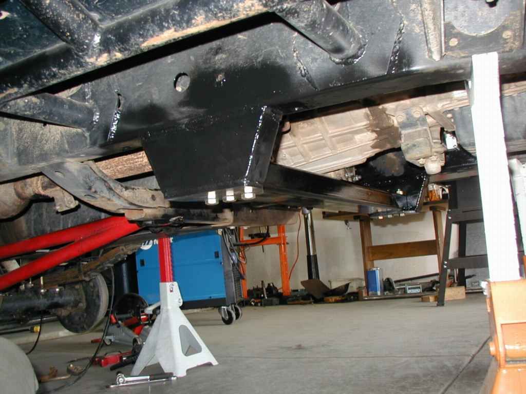

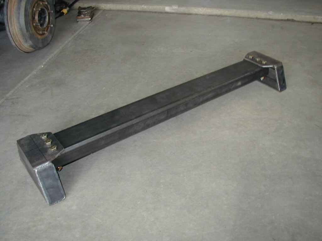

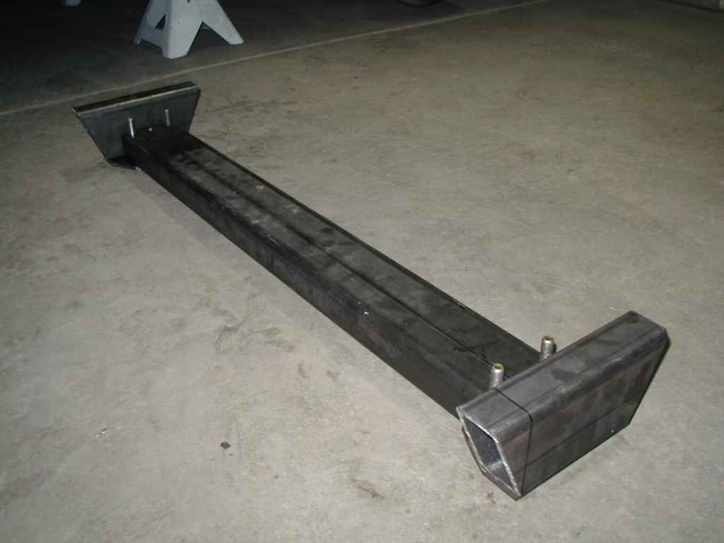

when I built the Solid Axle Swap on my '99, I created my own crossmember out of 3/16" square tubing, with massive mounting points on the frame. These mounting points were welded to the frame, with the crossmember bolted to the mounting points. It was quite a work of art.
Actually, in this image you can see the large diamond plates for the sliders.

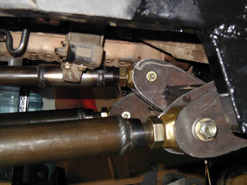

massive heim joints for the 3-link suspension setup
