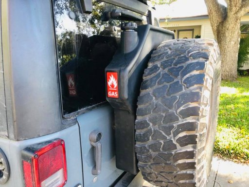

External Fuel Tank. Not Rotopax. Just installed the Titan Trail Trekker II
Hourless Life
3,425
Fulltime Travelers
Eric
Highland
14045
New mod installed
We just added the Titan Fuel Tanks Trail Trekker II to our overlanding arsenal.
We opted for this fuel tank rather than the Rotopax for several reasons:
First off, this tank holds 12 gallons. Yes 12.
Secondly, the tank is grounded, vented, and has rollover protection. Because it is grounded, there is no need to take the tank on and off to add or siphon fuel.
Lastly this tank boasts a lifetime warranty.
We’ll be taking this bad boy overlanding to Mexico with us in January.
Haven't used it yet so can't really answer any usage questions. But if there are any other questions, let me know I'll do my best to answer if anyone is curious.

How is it grounded? Only way would be to drag a ground strap or deploy a ground strap when filling.
Looks good!
Sorry for the delayed reply Roy, we've been traveling. So it is grounded by a ground wire directly to the vehicle. You can read more about our thoughts on this tank on an article I wrote here: Titan Fuel Tank Trail Trekker II
Here's a photo from that article. Hope that helps. ~ Eric
Reactions: MazeVX
RoyB
1,010
Boston
Roy
Bertalotto
Thanks for the reply, but still not "earth grounded" to the pump. Be careful with this. Plastic cans , gasoline and static electricity is a bad day!

Like RoyB said, your fuel tank needs to have a static ground line from tank to a metal grounding rod stuck in the earth while fueling. A 3 foot iron pipe with steel cable and a Set of jumper cables running between the pipe and the tank ground pictured above would be more than sufficient to keep a static electricity spark from occurring.
And yes it does happen, and yes it’s very dangerous.
I used to work on refueling trucks for many years. I never did any tank work without grounding the fuel tank.
OffWheelin
271
Torrance, CA
10574
"your fuel tank needs to have a static ground line from tank to a metal grounding rod stuck in the earth while fueling"
[/QUOTE]
Most new vehicles have plastic fuel tanks grounded to the chassis. The Titan tank is the same design. Filling the Titan at a gas station is no different than filling the main vehicle tank.
dboy
597
Oregon
Daniel
Jaquith
KF7LDA
Filling up your lawn mower on the weekend must be an ordeal, with driving a ground rod and all.
