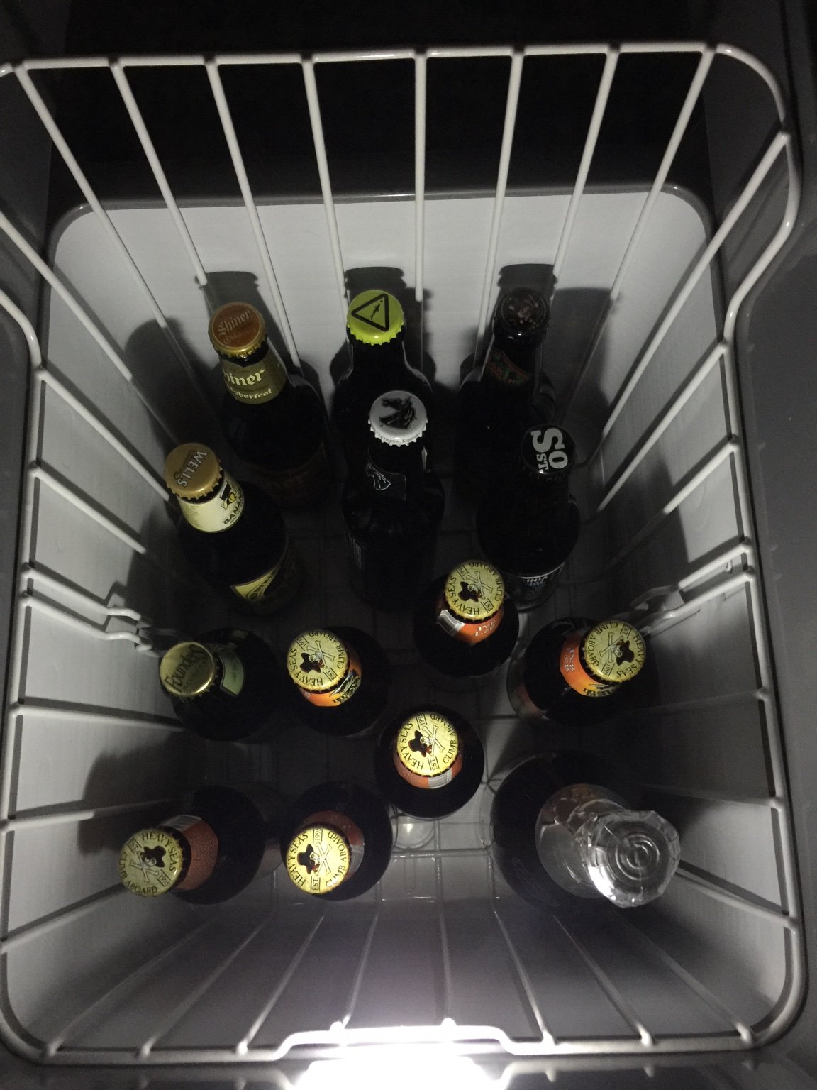

Both coolers and fridges have there place. I go between both depending on what I’m doing and for how long.
That said... She (fridge) is currently acting as my beer cooler.
