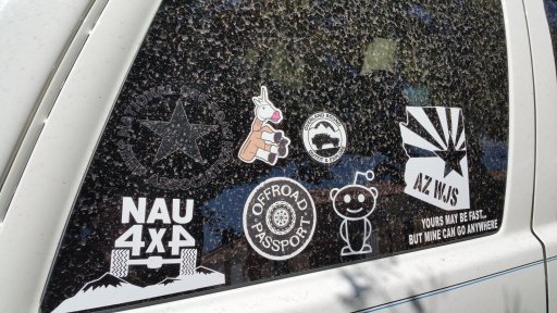

This did come in the mail recently!
"But Big Tuna, that's on the inside... What do you have on the outside to represent?"
I decided to put the sticker on the outside since the sun here cooks and destroys everything. this way, I can just peel & replace when the time comes.
As for now, on to finding a new transmission oil pan. The current one has a pretty good dent in it, as it took a pretty good wallop from the old driveshaft when it grenaded.
EDIT: Yes, the Jeep currently is that dirty. Monsoon storms mixed with sandstorms do this. haha
