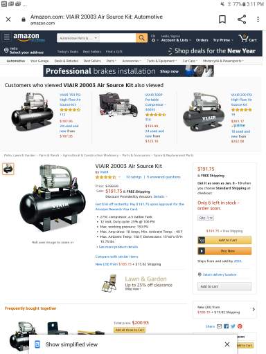

I then picked this guy up. I don't remember if I paid this price or not. It's definitely more heavy duty feeling than the $50 one I originally bought.

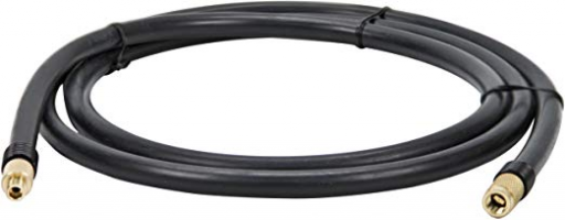

I bought 4 RV ViAir kits for my fleet. Solid kit that only requires minimal add ons. IE extra valve cores, extra air gauge, and core tool. I like the RV kit not only for the beef of the unit, but the extra hose will reach all the way back to a trailer.

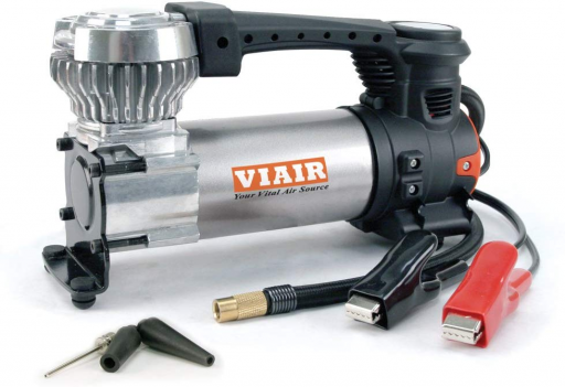

I have a Viair 88p. Almost certainly not the "best", but seems to fit my needs just fine.
Airs up my tires from 18psi to 36psi in about 3 minutes each. However, the built-in air gauge is not very accurate.

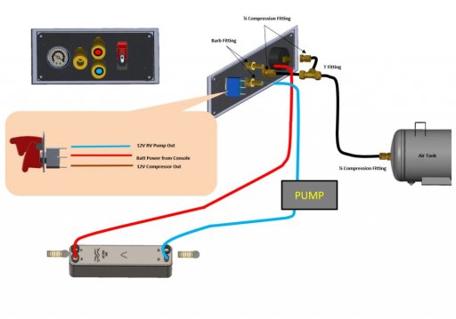

I have plans to convert it to an on-board system similar to this thread Poor man's OBA

Did a lot of research, both compressors and the reviews that accompanied them. After a lot of reading, price comparisons, and the frequency I expected to use it, I chose the Viair 88P. As a price point, it was cheaper than some, but more robust than others in the same price range. A big qualification that I needed, was the ability to pump up a 33" tire (285x75x16) E range. A bag was not needed, as I used a surplus 200 round sealed military Ammo can, that gives the unit great protection when transporting. It allowed enough room for the compressor, a 6 foot Vivair extension hose (22 ft duck-tail flat bed trailer), and a couple small accessories.
Most important, it did not break the bank, in cost.

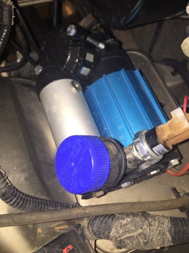

ARB twins blow up a lot, Mine died after a year. use get an extremaire magnum
I have had one for years and never had an issue

Mine is the twin and I have had it for 6 years with no issues. I also put them in both daughters trucks and they have had no issues. I have them in both my 200 series Land Cruiser and my Fj40
I am not doubting that there have been ones with issues, just mine have worked fine mounted in the engine bay
The link I posted i thought would help in deciding between a CO2 system, a compressor and a compressor with a tank. I used both the Puma and ARB in the test. The puma is a great unit and not very expensive. It is big though
I liked the ARB twin because I dont have to carry a compressor. With all the stuff I carry, it is one less item to have

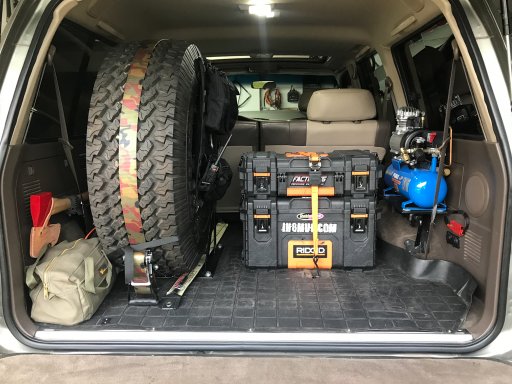

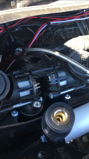

I've ugraded from a Harbor Freigh 150psi pump to a dual viair 450C pump w/ 2.0gallon airtank. Airing up is a LOT faster and more enjoyable with the dual compressor and tank setup. I like the viair option because of how you can customize where you want to mount it and it's not all smashed together (dissipates heat a little better).
Here's my setup on my Xterra.
Hi,
The air tank looks good. Which size is it?
Thanks,
Bjoern
