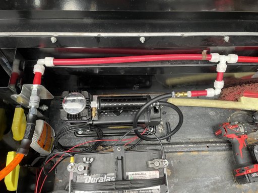

I have the Smittybuilt also, and use a 2.5 gallon air tank for additional air. Works well and cheap.
This is the cutoff switch I use on my tank. There are many others out there as well. When the tank reaches 100psi the compressor shuts off. This prevents the comp from running too much and overheating.
Reactions: ThundahBeagle

So I'm on my second install for the Smittybuilt. I took the air tank out of this install for lack of room until I get a topper for this truck. Still preforms well and does what it should.
Zim
Reactions: MMc
