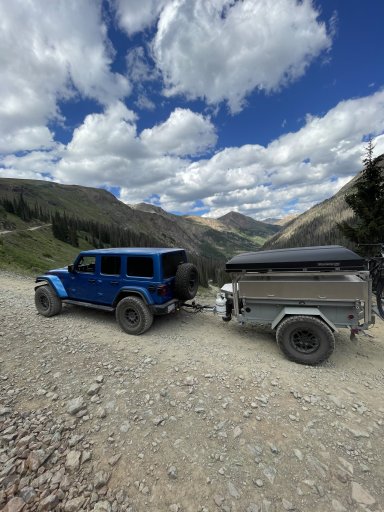

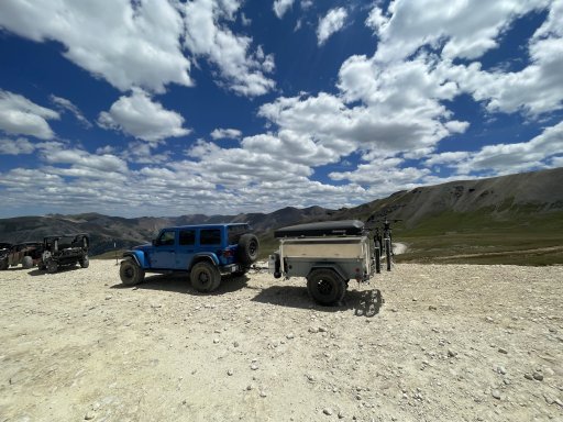

With 2 days to spare I finished the trailer just before we planned to leave in our vacation. Had 3 friends help me out the tent on the rack then took it out for a test drive. She towed great. 75mph no problem as long as the roads are smooth.
We went to CO for 2 weeks. The first few nights were in a little canyon on the Poudre River outside of Fort Collins. We got to relax and do some fishing. Caught a bunch of rainbows.
Then we went into RMNP as we had a a backcountry permit for 2 nights.
Then we headed to the San Juan mountains in the SW and did the Alpine Loop. That as incredible. Proud to say the trailer went up and over Engineer & Cinnamon Pass.
The trailer o performed great. The water system worked and 21G was perfect. My 11 lb propane tank was plenty for our meals. The actuators worked as they should and gave me no issues… wished they were a little faster at times lol but no big deal.
One thing I noticed that I will adjust over winter is my fender to tire clearance. Once the trailer was loaded up I lost a bit of clearance and I want at least a 1” more.
On the rough trails the brackets I made for the telescopic tubing / tent rack wasn’t as sturdy as I would like. I made them out of .125” and they need to be thicker. Will probably have some lasered out of 3/8” and be done with it.
Also want to add an awning of some type.
So those are my projects to come.

Really nice trailer build!
I'm beginning on a similar build this winter for my M100 and using some of your ideas for inspiration. How was the CG of the trailer handling off road obstacles on your CO trip?
My tent and awning will be near 300lbs on a frame about as high as yours, so I'm curious if you had any close calls with rolling it, or if you had to be more careful when driving in the rocks than just trusting the trailer would follow anything the Jeep would get through?

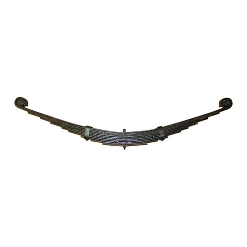

I ordered new 10 leaf springs, hd shackles and new u bolts from vintage jeep parts. They were great to deal with. 1949-1953 CJ3A - Suspension & Lift Kits - VintageJeepParts.com
I was looking for new springs for my M100 build, but it seems vintagejeepparts.com is down, maybe for good? Do you know the spring rate for the set you bought?

It looks like it was just temporary, or maybe an issue on my end reaching the website. I can see their products now, but I'll have to ask if they know the spring rating.
They're probably going to ask you what the loaded weight is so if it's not too much trouble, take it down to a scale and have it weighed.
Another option is to find a local spring shop and have them fabricate springs for you. I did that... just delivered the trailer to them and they took care of it.
443
Rochester, MI, USA
Wayne
Adventurer
I am not sure what the spring rate is. Once my trailer is loaded up I actually woudln't mind a little more spring rate or arch to them ...

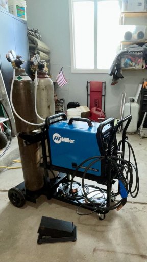

A few weeks ago I was finally able to upgrade my old 110 miller MiG welder.
I needed a welder that could handle thicker material and I really wanted to learn AB’s be able to Tig steel and aluminum. After looking at all the options I decided on a Miller multimatic 220 multiprocess welder. Been using it for about a month now and love its versatility. Dual tanks and can easily switch processes is so nice. Aluminum welding …well i have some work to do there :tearsofjoy:
I picked it up from Cyberweld as they had good pricing and great support. Welding Supplies, Welding Helmets, Miller Welders from Cyberweld
Now I am ready to start my trailer projects
