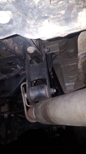

I installed new rear rotors to see if that would stop my brake squeak issue. I doubt it will help but for $50 it's worth a shot. Install took maybe 30min. Very simple.
I also installed a set of Wulf 2"-3" lift shackles and removed my AAL. I won't be loading down the bed as heavy as I have been and I wanted to see if the rear rode softer without the AAL. It does..... So I bought the lift shackles to restore the lift I had with the AAL. Except there are not pictures of the shackles installed anywhere on the web and the instructions amount to handful of sentences on a sheet of paper, no pictures.
So I did my best and installed them backwards and maybe upside down. *shrug*
There are only a couple of ways they seem to fit without the cross brace hitting the frame when they pivot. I took photos before realizing they were backwards. :) I removed the shackles and reinstalled so the H-beam is now facing the tires. If I decide that 2" of lift from the shackles is enough I can cut the bottom eye off to make it look cleaner. Or I could use the full 3" and just remove the lift block but I'm not sure what that will do to my pinion angle. Hmmm
Powerstop coated rotors
Wulf shackles installed backwards. :) I flipped them around after taking the picture. I had to cut back my exhaust tip as well. It was on my to do list anyway.
There are only a couple of ways they seem to fit without the cross brace hitting the frame when they pivot. I took photos before realizing they were backwards. :) If I decide that 2" of lift from the shackles is enough I can cut the bottom eye off to make it look cleaner. Or I could use the full 3" and just remove the lift block but I'm not sure what that will do to my pinion angle. Hmmm
Wulf shackles installed backwards. :) I had to cut back my exhaust tip as well. It was on my to do list anyway.
Yes they are upside down, i did mine the same way but didnt have to do anything to the exhaust tip. I still need to flip mine around but it dont make much difference.

Correct myself yours are upside down and backwards mine are pointing the right way for articulation but upside down. The way the h beam is pointed on yours it will catch on the frame when the suspension flexes. Having said that i ran mine exactly like you for over a year it hasnt limited how much i can haul i have no lift block and i run em at 3inch.15629292920841971317550.jpg
Thanks a TON! I tried putting them on like yours are pictured and I was having trouble getting them in place so I figured I was doing it wrong.
The H beams are currently facing the tires now unlike the photo in my post. I had flipped them around after noticing how close the H beam was to touching the frame. :) Maybe after work I'll try flipping the entire unit so the extra holes are above the frame.

I dont think it really matters if the double holes are on top or bottom as long as the h beam is in the right direction, im keeping mine in the position in pic just for ease of adjustability and as you probably already know they are a pain to mess with. I have the same adjustable type shackles in my ranger also in same position
If I was using the 3" holes I'd leave them as is but if I stick with the 2" holes then the extra length is an eye sore. No problems with pinion angle on your rig?

Fyi When putting em on its alot easier to leave the wheels on and use the bottle jack in between the frame and the leafs over the axle to get the shackles adjusted

Nope pinion angle looks the same i dont think that is a worry til we go over 3 inches. I had to do a differential drop on the front to get my cv joints at the stock angle again after 3" lift. Your angle will probably be a little more extreme with the lift block on too. Id remove that and run the shackles at 3.
