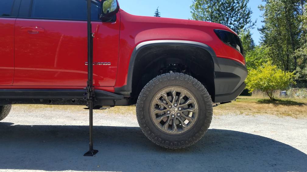

That Edelbrock supercharger rumor has been floating around for several months now, I've been waiting to see the price and just what the package is. Right now the Mallett super charger kit is the most complete on the market and runs about $8k installed.
Super charger horse power and 35" tires is going to twist the drive train in these mid size trucks in short order. The big tire guys are already seeing differential issues. I don't think I would go bigger that a 32.5" tire, minimal clearance issues and not as hard on the drive train.
Just got my steel drive shaft with 1350 u-joints, no more worries about denting the aluminum shaft that would then bend like a pretzel.
I think I'm finally done with the mod's, I may upgrade my lighting, I just ordered some Baja lights and if they are a lot brighter than the imports I already have I may end up replacing those.

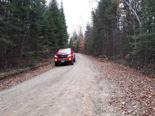

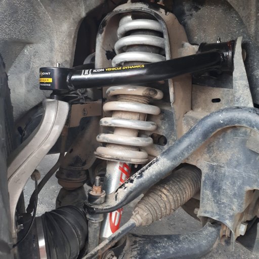

Anybody else get excited when folks come out with vids like this on YouTube? I must have watch 10 vids on the new Ranger today, a Tundra vid, and this ZR2 vid. I think I may have a problem with liking trucks so much!
@ Andrew24
I looked into ICON to see what suspension options they have for the Colorado. Turns out there are a lot of options offered by them... Cool.
http://iconvehicledynamics.com/shop/656-2015-up-colorado-canyon

ya they have a lot, i opted for eibach springs and shocks but i think next fall im going to go full icon. since i think im going to try and keep this truck until the fenders fall off
I also plan to keep this truck until it falls apart. That is what is AWESOME about trucks. As long as you keep the rust off of the frame and cab... the rest is easily rebuildable or replaceable. That is why there are so many ancient trucks on the road.

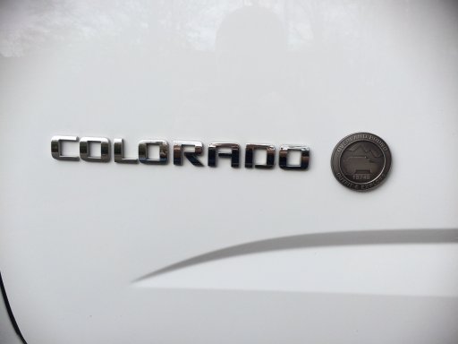

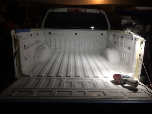

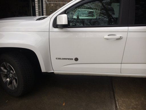

Truck Update:
I installed my OB member badge today and started the process for a DIY truck bed liner. Throwing in some cheesy pics of some of the recent loads thrown into the bed during the 50' long French Drain I just installed @ the house... and a pic of my aquaponics plants in the new mini greenhouse I just built for them.
The paint is completely MIA in large swaths of the bed already. Starting corrode/turn black now. Time to do the bed liner! It is all about the prep work to get it to stick right. Doing that today... and maybe the application as well.
Went fishing again on the 30th for Striper. Should have take a pic of the Yak in there. lol Trucks are soooo handy. I used to be an SUV guy.

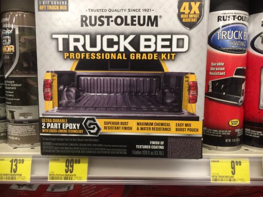

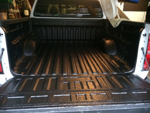

Bed Liner Installed
Type used this time... Rust-Oleum "Professional Grade" It is a 2 part epoxy you have to mix and claims to be 4x stronger than their other bedliner option
Here are some install pics of the bed liner I just did on my truck. Every time I do this to a truck I swear "Never Again"... but it is such a cheap route... and has really worked out well for me in the past.
Performed the following steps. Just like with paint... it is all about the prep work.
I cleaned/pressure washed the bed (If oil and such is on it... use dawn dish soap to cut through the grease)
Dried the Bed
Sanded/roughed up the paint in the bed and sanded the corrosion to fresh metal
Took the leaf blower to the bed to get out the majority of the dust
Used the listed cleaner (each bedliner material is different This one was either Iso Alcohol or something else) to do a final clean of the sanded paint
Then applied masking tape
Then applied the product
The kit was designed to work on up to an 8ft full sized truck bed. So at the end I went SUPER THICK with the final coat and still has some left over. The kit came with a hand scrubbing sponge pad that would have taken days. The day started @ around 70F but by the time I finished the temps had dropped to 50F or so... so It took 3 days to harden. If temps were above 70F it takes 7 days to FULLY cure. So I will wait a few weeks since it is Winter and the temps have dropped. It is dry/hard to the touch now. Had to leave it inside for the last several days to keep it out of the endless rain we had.

Nice work! A lot of work but worth it to save cash. Unless you're like me and suck at painting. lol
Thanks! I had already worn through the paint in the bed about 6 months ago (dragged a load of cement blocks across the tailgate and bed). It needed to be done.
I suck @ painting as well. I do know enough to know that it is all about the prep work. I still have to go back and clean up some dripping that formed. Since it is bed liner I just consider them "Ribs of extra protection" lol.
The tail gate gets the most abuse. So that is where I applied the liner the thickest. However, I had to close the tail gate to close the garage. I checked 15min after closing for any type of run in the bed liner... didn't see any and went to bed. By the time I woke up in the morning there were several though. It looks fine and will do the job!
Saving in money here left around an extra $600 in my pocket for other mods. If I were a professional contractor and Always had something rolling around in the bed I would have spent the extra money on the bed.
EDIT:
I think the worst blemish in my application job was something that I didn't even do. Apparently the next morning my Father In-Law went out and checked to see if it was cured yet while I was @ work. He put in a giant 4" finger shaped smudge up near the cab and didn't bother fixing it. lol It will still work fine though. lol

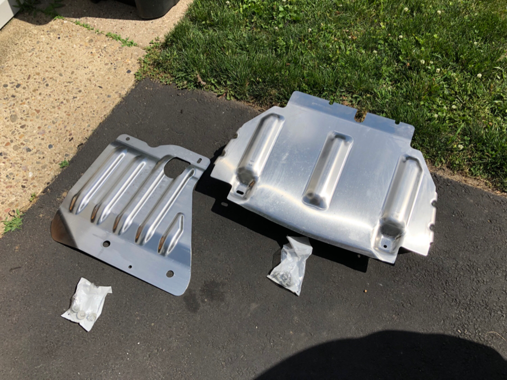

Next likely upcoming mod...
SKID Plates
I have been weighing in on the subject in my mind and research for a while now. There are a lot of offerings out there in either Aluminum or Steel.
Long story short... I don't plan on rock crawling on the regular and don't need steel. I am going with aluminum.
I am going to do skids in stages. My wife and kids are officially excited about doing our first cross-country trip later this year. The kids want to see Yellowstone. I want to do some routes through Colorado on the way there/back.
I will likely just end up with the OEM Non-ZR2 style skids. They look just like the ZR2 skids but are shaped a little different for my non-ZR2 bumper. They just bolt right on without the need for mods. They cover the area from the radiator through past the engine oil pan. I do already have a small steel skid over the xfer case.
Later on I will likely add superskidz from there on back. Then later on add some 589 shock skids. Then the AEV pumpkin skid and fuel tank skid last.
Total cost for the OEM skids will be $345 shipped from Tascaparts.com
We will be figuring out what to cover the bed with next after installing the two main skids.
With having an independent suspension up front... the whole front ends ground clearance (between the A-arms) drops when coming off of every bump. These are likely the most important two skids for general higher speed trail riding.

The wife is out of the house so... I am going to quickly make the purchase for the skid plates! lol
I have to hurry and make the purchase, dinner, and get the kids our the door to a girl scout meeting(Son is a boy scout but enjoys coming/no choice)
I just did some searching around @ several of the places online to buy GM parts for about half of the price you would get for the same thing @ the dealership. There are a lot of options out there to choose from. I have bought parts from a few of them in the past. Most are just dealership owned.
Taska = $345.45
GMpartsnow = $363.76
CheapestGMparts = $338.33
GMpartsdirect = $357.59
GMpartsonline = $350.83
Here are the Part Numbers for the non-ZR2 skid plates that just bolt right up without modification. You can buy ZR2 skids used online for even cheaper... and just cut away part of the skid. They will still bolt right up.
84352136
84352135
In fact... I may get some ZR2 rock sliders. I keep seeing eh ZR2 guys selling theirs for a fraction of what the dealerships sell them for. As long as it comes from a CCSB ZR2... it will bolt right up to my truck. I already checked it out. Just have to pop off some plastic bolt hole covers and bolt it up!
I will sit on that and think about it for a while. The Old Man Emu rock sliders are not much more than heavily discounted (and barely used) OEM sliders.
I just put the skids on order from cheapestgmparts.com! I used the paypal secure checkout path. Total was exactly as estimated. I will check back in next weekend for another update.
EDIT: It is not Old Man Emu rocks sliders... it is Rocky Road rock sliders that I am thinking about. They come in 4 different styles for my truck.
https://www.rocky-road.com/chevy-colorado-rock-sliders.html

ZR2 Rock Sliders!!!
I just lucked out. I was 3rd in line putting in an offer for an asking price of $200 for new/used Chevy Colorado ZR2 rock sliders + what ever shipping ends up being. The other two dudes quit replying to the guys texts... so I got them. He sent pics and they look amazing. I already looked it up online... and on my actual truck. My truck is already modified from the factory to just strait bolt them up. Just had to make sure he had the same cab/bed config I have.
I just could not let it pass by. The ZR2 Rock Sliders and Skids were good enough during testing on the Rubicon Trail (Waaay worse than I will likely ever see). So... I should be sitting decent enough to do all of those wonderful trails I have in mind when I get these couple of items bolted on.

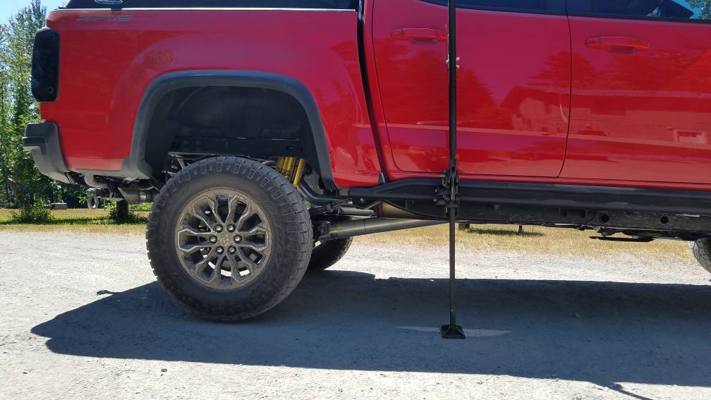

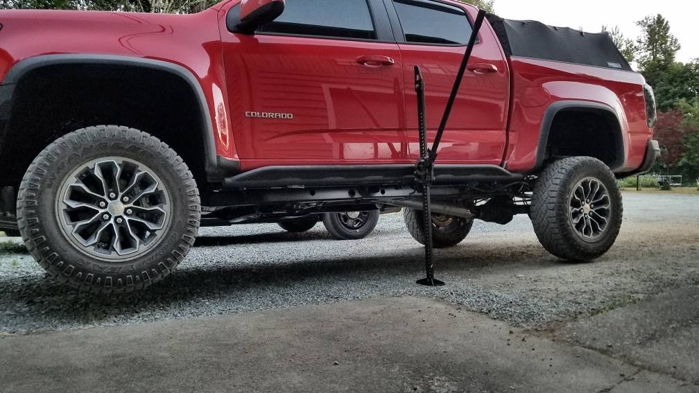

These are not as strong as frame-mounted rock sliders. These actually mount to what equates to the unibody. My truck cab has a unibody frame for the cab (that bolts to the truck frame). It looks to be 1/8" steel and about 5" box shaped. They should hold up great for my needs.
New from the factory these things are around $750 to $850 I believe. The ones I am getting are essentially new. If I were buying new... I would go with the Rocky Road sliders. They are not only cheaper... but a LOT stronger.
However, look @ the pics I am attaching though. The OEM sliders are strong enough to use as a high-lift jack point. Not Bad!!!
EDIT: Here is a link to the thread/website I bought the Rock Sliders from for $200...
https://www.coloradofans.com/forums/79-sale-wtb-business-sales/403083-sale-crew-cab-rock-sliders-200-a.html
