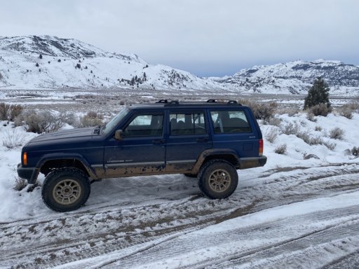

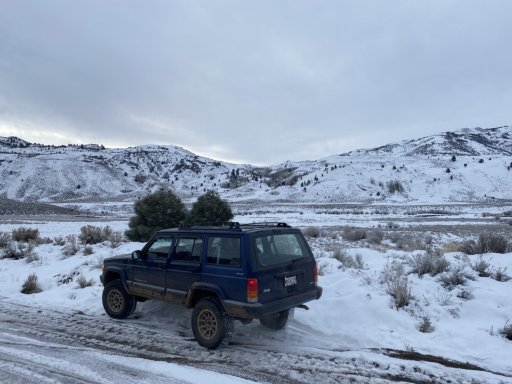

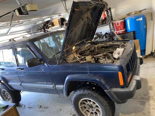

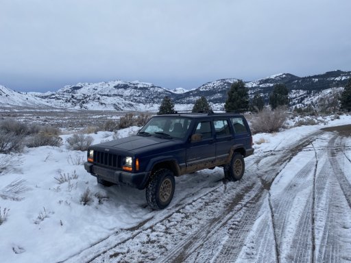

Hey guys I'm back. Sorry I've been MIA. So I have had quite the adventure over the last few months. So my 97 Cherokee transmission exploded on me, that was fun. I was on my way back from a 72 hour shift at the fire department and was driving to work on base about an hour north when the transmission just gave up. Since then I have found a 2001 jeep Cherokee. I got it for super cheap, the interior was in pristine condition. the exterior paint needs some work but nothing outside of my wheel house. On top of having a fantastic interior, all of the parts I had installed on my 97 xj fit the 01, with the acceptation of some of the engine parts. so as of now I have swapped everything over to the 2001, with the acceptation of the rear axel from the 97, which I am going to rebuild first and then install, the drive shaft I had on my 97 which was an after market drive shaft, the exhaust manifold which is the upgraded manifold so I don't get a cracked header, and the roof rack, which im considering not installing on the new jeep. the 01 has the stock roof rack and its in pretty good shape what do you guys think? the pictures will be following shortly

I have owned both a 97 and 01 cherokee (currently building the 97) I don’t think the 97 header will fit the 01! The 01 has the 2 piece manifold with 2 extra O2 sensors in it. But other than that a few other minor things everything fits which is the great part about XJ’s!
That would be extremely unfortunate if it doesn’t fit lol, it’s a perfectly good header
