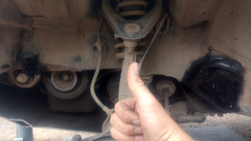

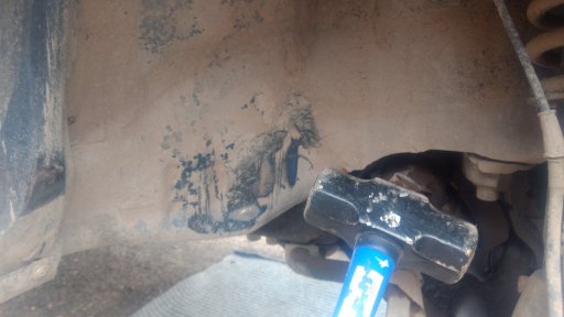

Made use of the highly precise Persuaderator 3000 today to correct some minor tire rubbing inside the front wheel wells, as well as massage the rear ones to make them a bit better as well.
As the saying goes: freakin' mint.

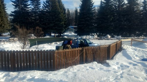

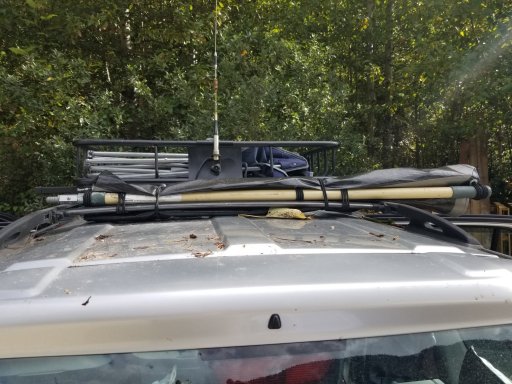

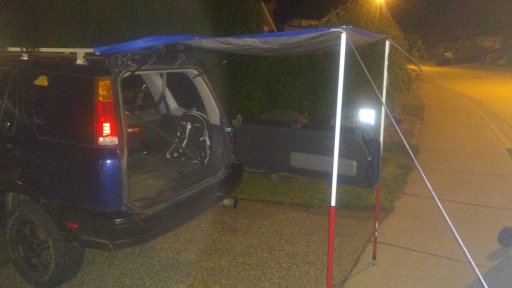

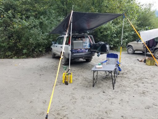

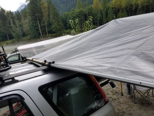

New Mod!

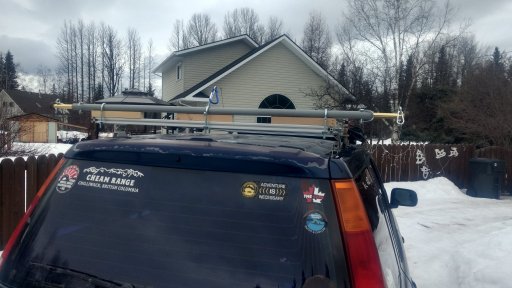

A little while ago I bought a 11.5x8.5 nylon rain fly, primarily for use in backpacking adventures, but I figured it could serve in overlanding as well. To that end, I built a telescoping mount bar to attach it to the back of the rig. For a while I've wanted a better solution than the extremely bulky and heavy 10x10 pop up canopy I've been using, and I figured that this rain fly could be it, but if it didn't work out for overlanding, it would still be perfect for backpacking.
The other day, I rigged up this telescoping bar mount for it from $20 of hardware and some tubing I had laying around. This is the result:
The clip pins toward the ends come out, the brass colored bars slide out and then the pins go back in to hold them in the extended position for the awning. The awning has a sort of hexagon shape, so the middle eye bolt is meant to accommodate that. I may work something else out to push it higher and further forward for better rain shedding, but for a first test, it's not bad.
Major improvement over my super duper ghetto first attempt at an awning:

I did something quite similar using painter extension poles and a heavier duty tarp. Used straps as guy lines and bungees to hold the rolled up tarp when driving. Works a treat.

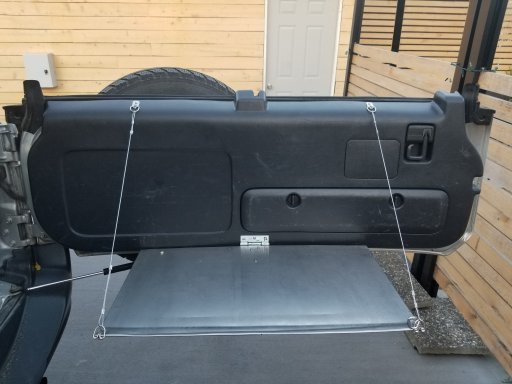

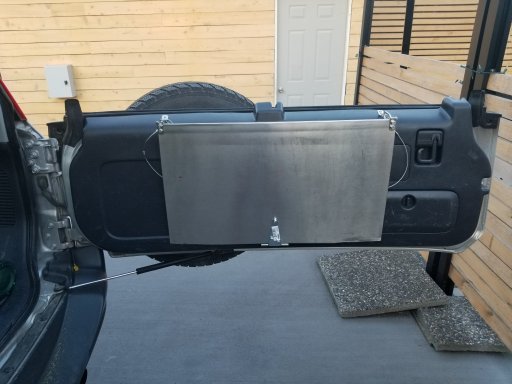

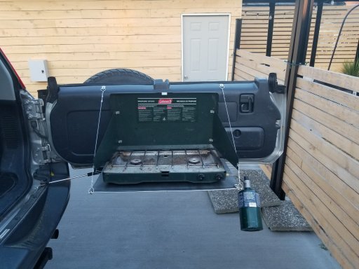

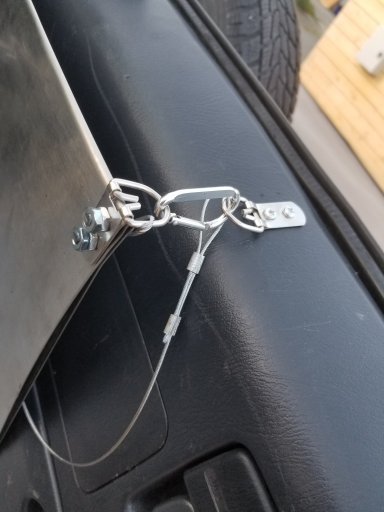

I also added a shelf to the back door made of stainless steel that I had laying about. Holds the stove when I have the kitchen setup out. It rattles a bit when I am driving, and I should have used two hinges rather than one in the middle. It is strong, but does wiggle a bit side to side. Not sure what I was thinking...

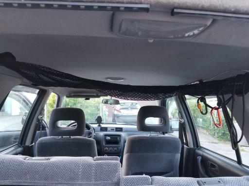

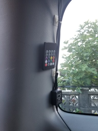

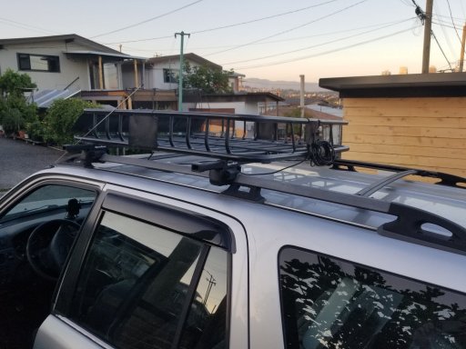

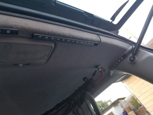

Here are a couple of other bits and pieces. Cargo netting on the ceiling to put clothes etc. in at night (if two people are sleeping), led lights for better visibility, rain deflectors on the windows and mosquito netting over the door windows so I can keep them open at night. I mounted my radio antennae on the roof rack and only put it there when I go camping. I just pull the cable into the cab through the window.
I really like that. My posts for the awning are also a pair of painting extension poles! Great minds think alike, clearly.
Where is that sandy spot? Looks like a sweet location for a campout.
I actually considered doing almost the exact same thing with a fold down table on the rear door, but opted not to due to there already being quite a lot of weight on mine between the extra large spare tire, the "trasharoo" and the 20L Jerry can and mount. I have a separate folding camp kitchen made by Woods that serves nicely and fits perfectly on top of the table under the shelf in the back.

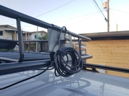

I love your light setup! Very nice. I also had the same idea about the cargo net. I would be interested in more details about how you rigged it.
What kind of radio are you running? Ham? CB? LADD (RR channels)?

The shelf is very light, until I put a stove on it, and then is is still light. I find it useful as a place to put stuff when I am digging about in the back of the truck. I also like your folding kitchen idea - way more flexible in case you don't get a nice level spot to park.
The cargo net is clipped at the front to the hand holds above the doors and to the baby car seat mounts in the rear. It is really handy. The lights were cheap and from Amazon. To be really useful I think I should have the 12v outlet in the rear run even when the ignition is off - right now I have to put the ignition to accessory to give it power. I run the lights and the cool-a-tron from a splitter in that rear 12v outlet.
The radio is a VHF unit that I put into the 12v outlet up front. I monitor the radio on the FSR for working trucks and other off roaders, but I don't really know what I am doing with it.

The LADD channels are UHF, VHF is for marine use. I'm planning to get a UHF from Amazon ASAP this season and program it for all the BC RR channels, including the newish 4x4 channel (thanks to the lobbying of BC4WD), because logging, natural gas and mining is SUPER active up here, and it's just good sense for safety. Once I get that wired up, I'll have the CB, the UHF and 2 hand held GMRS in my setup. EDIT: My info was wrong, LADD channels and BC FSR channels are indeed land mobile VHF. Just noticed this error and wanted to correct it. Marine also uses VHF in a different frequency range.

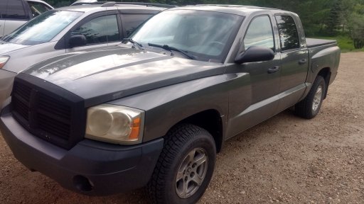

With that in mind, I introduce my new adventure rig (and homestead workhorse):
A 2006 Dodge Dakota. It has a 4.7L V8, a proper transfer case with 4hi and 4low settings, air conditioning, AM/FM/CD stereo, power doors, windows, and mirrors, and a 5.5 Ft pickup bed for all my adventure gear, hay bail, tool and garbage hauling needs. It even came with a cheapo vinyl roll up tonneau cover, which although not great, provides some shelter to whatever I throw in the bed.
I have some ideas, but as yet I'm uncertain how I'm going to fit it out. One strong possibility is that I will convert the custom DIY roof rack from Ganbaru into a bed rack for the truck.
