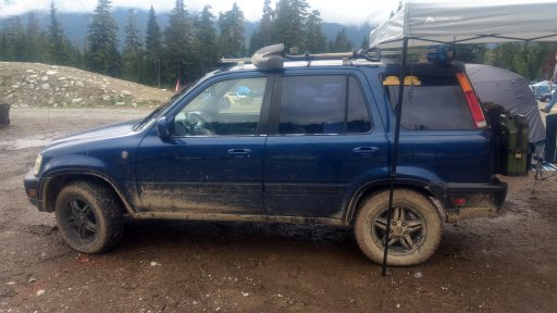

Better pic of its current state:
Taken at BC Overland Rally 2019. Next mod will probably be limb lifters. Hoping to do the suspension lift springs and Bilstein shocks perhaps early next year. It really needs that extra 1.75 in of lift.

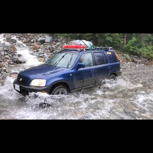

Update:
With limb lifters installed, doing a little water crossing on the way to Indian Arm:
I think this is pre-lift. I will have to snap a pic of it with the lift and show the stance. It's not a huge difference, but I will say that I believe 1.75-2" is the absolute optimum for this vehicle. I would never go higher than the 2" I have on, and wow what a difference it makes to the off road performance! Just putting new struts and the HRG 2" lift kit transformed the ride off road to where I could go over obstacles with no worries that I really had to crawl slowly over before.

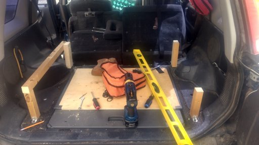

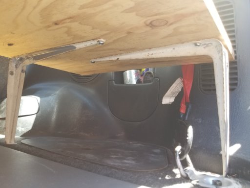

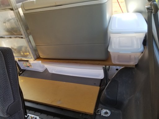

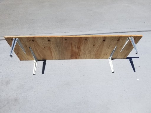

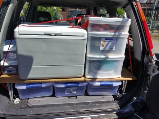

Well I have been swapping messages with CR-Venturer regarding tires and suspension so I thought I would add to this thread with the simple kitchen platform I made (while I wait for my lift kit....). In the end, it is just a 15" x 48" piece of plywood on some brackets for legs, but it does a lot for me.
I have the CR-V model with the seats that fold down completely to make a comfortable double bed so I wanted a platform to hold a kitchen and other gear, that would stay in place once the bed is set up, still allow access to the table, the other little storage compartments and the wheel well underneath the table (where I put recovery gear).
My thinking is that the reasonable number of smaller boxes makes loading the car easier than large totes and means it is easier to stay organised on the trip.
This is early days with this (as in I have not even loaded gear in yet, or better yet, tested it all out while camping...).
Platform is 15" x 48" 5/8" ply (I had laying around). The legs are angle brackets (also I had laying around). I bent the end of to make a foot.
The other piece of wood I cut is so the table can slide in without the things (behind the seats and on top of the table and behind the platform) falling into the tire well. It is 32" x 9" and also 5/8" ply.
The npolkacement of the legs took some messing about. I used clamps to hold them and tried different locations so as to make the largest space for access while hitting some solid part of the floor.
I am playing with the plastic boxes to work out what I want to put in each, and I can put 3 smaller ones under the platform or a bigger one and a smaller one. I am thinking clothes and dry goods go in them. I stacked a couple of shoe box sized ones to the left of the cooler. Still playing.
It does need a ratchet strap over the whole thing so I will make that a fast and permanent part of it all. Also, I took out the carpet in the rear area - not helping really and stopped access to things underneath it.

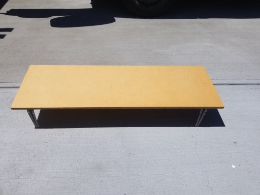

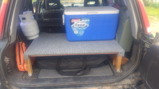

Well, Eastvanguy inspired me, and this is the result, fabbed up from scrap lumber I got for free from the dump, screws I had on hand, a 4" aluminum angle I had lying around for years and years, and a piece of outdoor carpet we had kicking around:

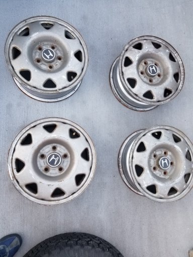

Right back at you with my $400 tires and $60 rims courtesy Craigslist andd FB marketplace. I'm pretty excited as you can tell. I even bought some paint to black the rims up.
BTW nice job on the platform.
Thanks! :D I see you scored some K02's! Very nice. What size are they? Also, highly recommend getting a matching 5th tire if you can. Ask me how I know. Lol

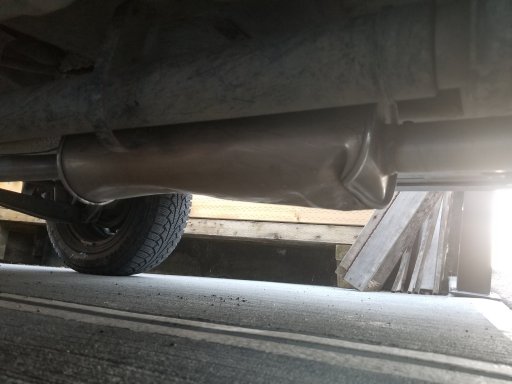

I think the tires are something like 1.4" larger diameter, so 0.7" higher off the ground, plus the 2" spacers, when they go in, I hope to get over 2.5" higher off the rocks that seem to like eating my resonator.
Mine looks way worse than that lol Some guys relocate the entire exhaust routing, because it really hangs lower than it needs to. They generally tuck it up much further against the floorboards, as there's a fair bit of room to do so if you change up the pipes.
I may end up re-doing my exhaust at some point, as mine is pretty beaten up and rusty.
Another thing I recommend, but unfortunately haven't gotten around to doing myself, is extending the breathers. The rear one is pretty well protected up inside the frame rail, but the front one could do to be a bit higher. I actually have some tubing kicking around the shop so I may throw it on while I'm working on the engine spacers.
