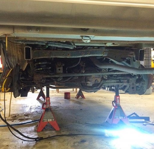

This story begins in February, after a two year search, when I scored my favorite color 1997 LandCruiser with lockers with 222,000 miles for 2500 dollars. I had set up an email alert on Craigslist, so I messaged the guy about 5 minutes after the ad appeared. By the time he had responded to me 20 minutes later, he told me I was one of four potential buyers, but he told me I was the first. I drove up that night and bought the Cruiser for the 2500 dollar asking price. 20 minutes into the ride home, it overheated, so I pulled over and realized my coolant had leaked out. I added coolant from the as station and drove it home. Here it is the night I drove it home. View attachment 3909 The first thing I did was bypass the rusted rear heat lines where my coolant had leaked out. View attachment 3910I cut away the rusted area with a hack saw and added a u shaped heater hose with some hose clamps. Next I tried to remove the badly rusted receiver hitch. I broke off half of the m12 finethread bolts holding it on. The thing was so rusted that it folded in half once it came off. This is the frame. View attachment 3911 Next I tried a needle scaler on my rear crossmember and it put a hole all the way through it. View attachment 3913I searched around for part outs until I found a 94 from Arizona that was only 4 hours away from me. The guy was willing to sell me the frame from the wheels back for only 50 dollars. I drove the cruiser all the way there and back without a breakdown. I then sandblasted and painted it. View attachment 3916Next I ordered the missing hubcaps off eBay along with a new receiver hitch from jc Whitney. View attachment 3917 I then decided to address the steering knuckles, which were long overdure for a rebuild.View attachment 3918When the rebuild kit from cruiser outfitters arrived, I got to work on the front axle. View attachment 3924After completing both sides, I sent my wheels in to be blasted and powdercoated.View attachment 3929Now it would be time for the frame section replacement. View attachment 3931I measured and cut out my bad frame section, then cut my new pice to match.

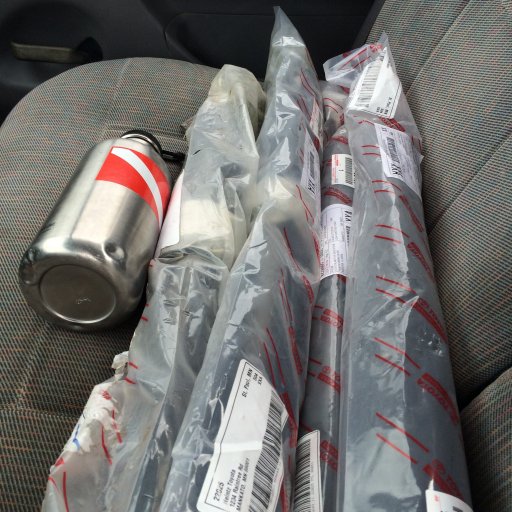

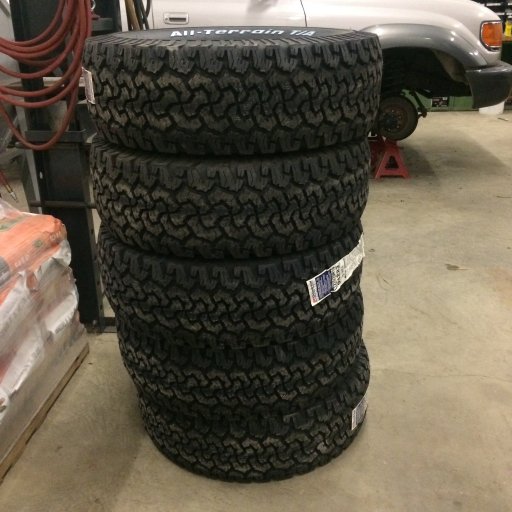

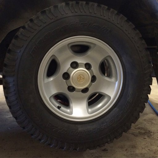

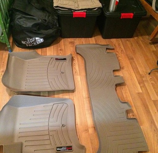

Next, I welded the piece in. View attachment 3932 View attachment 3933Then added the body trim and attached the new receiver hitch. View attachment 3934I then ordered five 275/70/16 (stock) bfg ko ats. View attachment 3935After three long weeks, my wheels were complete. View attachment 3936I immediately had them mounted and put onto the car.View attachment 3937I drove it for 1 weekend and the steering knuckle rebuild seemed to hold up well. View attachment 3938I then ordered some weather tech floor mats. View attachment 3939The rig has come a long ways at this point. View attachment 3940
